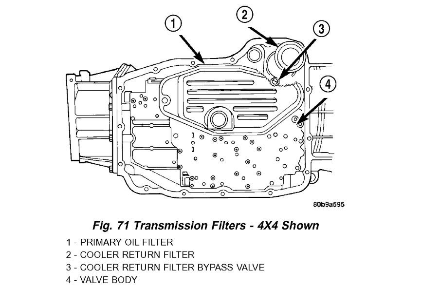

Good morning,
Yes, I would change the fluid and filter. Start with fresh fluid. The other fluid may be contaminated from adding old fluid.
As far as the noise, see if it is still there after the service.
I attached a picture for you of the pan configuration. This is what the vehicle calls for.

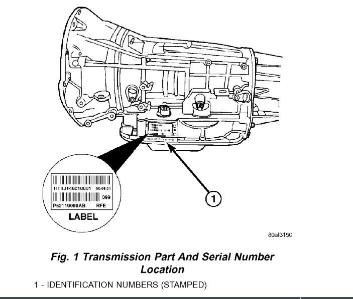

TRANSMISSION IDENTIFICATION - 45RFE
Transmission identification numbers are stamped on the left side of the case just above the oil pan sealing surface (Fig. 1).
Refer to this information when ordering replacement parts. A label is attached to the transmission case above the stamped numbers.
The label gives additional information, which may also be necessary for identification purposes.

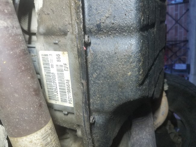

So how can I tell whether the transmission in the vehicle has the shallow pan or not? I'm finding two different filter kits, one for a shallow pan and not. Maybe some of the numbers on the side of the transmission for reference?
Jul 26, 2020 at 9:36 AM
That is the deep pan. The shallow pan is about half as deep.
Jul 26, 2020 at 9:39 AM
