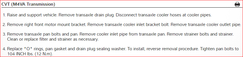

I have the car listed about with a Vetch. I need to change the fluid in the transmission. The only information I can find is that you only must drain and fill. My question is, is there a filter that I need to change also?

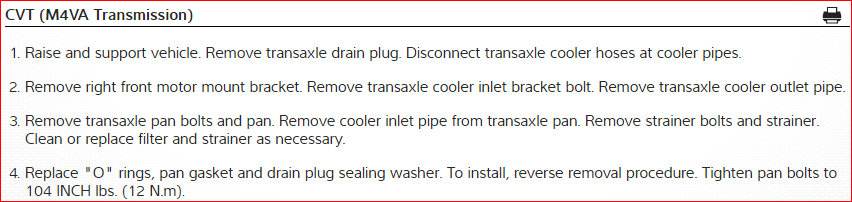

Here is the specifications/how to for the CVT type transmission filter removal and cleaning of the transmission strainer/filter. Use only Honda CVT type transmission fluid or it will affect transmission shifting/performance. Drain and refill requires 3.1 quarts. Hope this helps and feel free to ask any questions.
