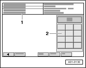

I recently had the TCM rebuilt and I re-installed it into my 2006 Audi A4 cabriolet. Now I can’t start it unless it’s in neutral. When I put it in gear it sounds like it wants to go into gear but will not engage. I heard it needs to be coded. I bought an OBD11 to do it but I can’t seem to find the right code. Does anyone know it or should I take it to the dealer.

Here are the directions for coding the TCM. I don't know if you have the correct software, but wanted to provide the directions.
The coding number should be 01001

- Touch - 1 - diagnostic function "07 Coding control module".

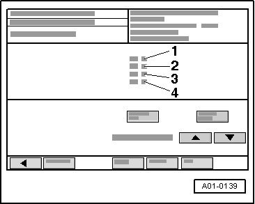

Display on vehicle diagnostic testing and information system (VAS 5051):
pic 2
- 1 - Enter code word
- On keypad - 2 - enter control module code as given in code chart.
- Confirm entry by pressing Q button.

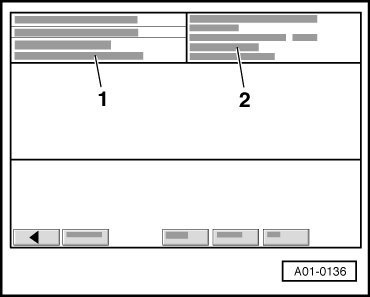

Coding Chart
pic 3
After coding, the TCM Diagnostic Trouble Code (DTC) memory is automatically deleted.

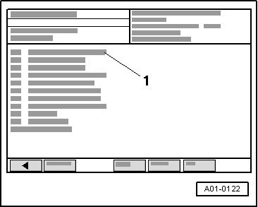

pic 4
- 1 - Coding is being carried out
- Wait until next display appears on screen.
