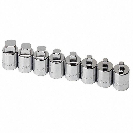

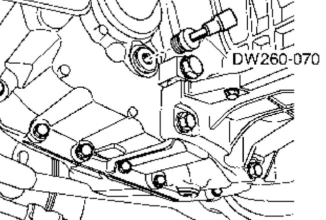

I have a sealed transmission and I've been noticing a little slippage lately and want to check the levels and possibly add some transmission fluid if needed. The internet keeps saying that it should require a 5/16 square head socket or an 8mm square head socket but another article suggests that it's a hexagonal head socket but upon my own research and watching videos I cannot find anything with a clear description or diagram of exactly what the fill plug looks like or where it's located. I am a female and don't know a whole lot about cars so I'm not 100% sure what I'm thinking is the full plug actually is or not....PLEASE HELP!!!!

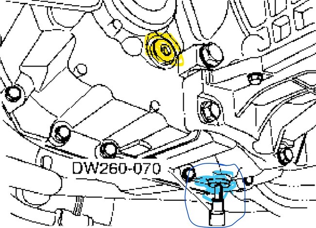

The hardest part of checking the fluids in most of the "sealed" transmissions is usually getting the vehicle high enough that you can get under it while keeping it level. You cannot just jack up one end or side. So if you have a way to do that safely then from there it is easy. First you locate the fill check plug on the side of the transmission. It uses a square drive tool # DW260-070 or DT-46475. Then you follow a simple process for most of them. Drive around or idle the engine to bring the transmission fluid up to about 90 degrees, then elevate the car and put a drain pan under it. Get a quart or two of the correct fluid for the transmission (Total ATF H50235 or Esso LT 71141 OR an equivalent synthetic ATF ) Next you run the engine and hold the brakes while you shift it through each gear, pausing in each one about 10 seconds. This ensures that the fluids are in the various passages and lines. Now shut the engine off and go underneath. Loosen the drain plug, wipe the crud around it off, and remove it, SLOWLY. If fluid starts to leak out, it is full, let some leak out and look at it for color and smell, if it is dark brown or black and smells like burnt toast it should be replaced. If it doesn't have any come out you have a choice, add some new until it does leak out the fill or to drain all of it and add new fluid, be advised that you cannot get all of the old fluid out without multiple fills because of the fluid that stays in the converter and lines.
If you decide to do a full service then you find the drain plug at the bottom of the case, it uses the same tool as the fill plug. You do the same steps of driving it around and lifting it prior to draining it. Remove the fill plug first, then the drain and let it run out. Once it stops dripping out, reinstall the plug to 33 ft lb. Then fill until it runs out the fill. Put the fill plug in and start the engine and run it through the gears, now check the level again. Top up as needed. Now reinstall the fill plug to 33 ft lb. See if the slipping has changed. If the fluid that came out was black and smelled burnt a fluid change probably won't do much as those are typically caused by the clutch facings getting charred and worn. That transmission does have a filter, but replacement requires the transmission be removed and the case split to access it, if you are at that point, it's not a lot farther to a full rebuild and if it is still slipping after the fluid change I would look at either a rebuild or a remanufactured unit, IF the rest of the vehicle is in good enough condition to warrant that.
