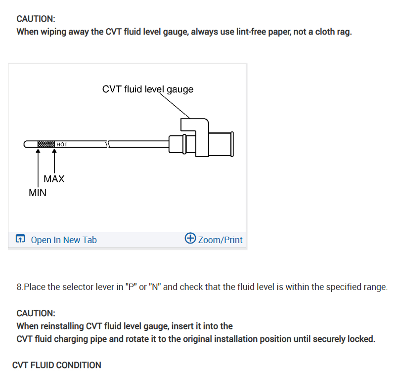

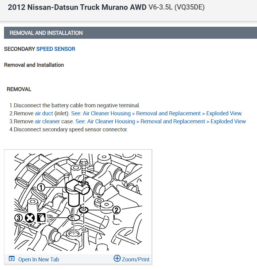

This sounds like the input shaft speed sensor is not working, can I ask if you have check engine light on? If so, let's run the codes to help confirm the sensor failure.

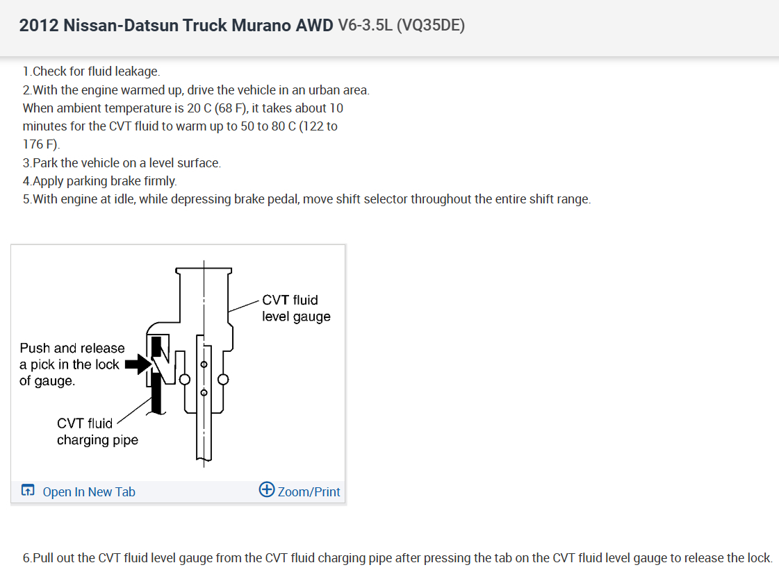

Here is the sensor location in case a code comes up for it. Also, I would check the fluid condition to make sure it is not burnt. Check out the images (below). Please let us know what happens.
