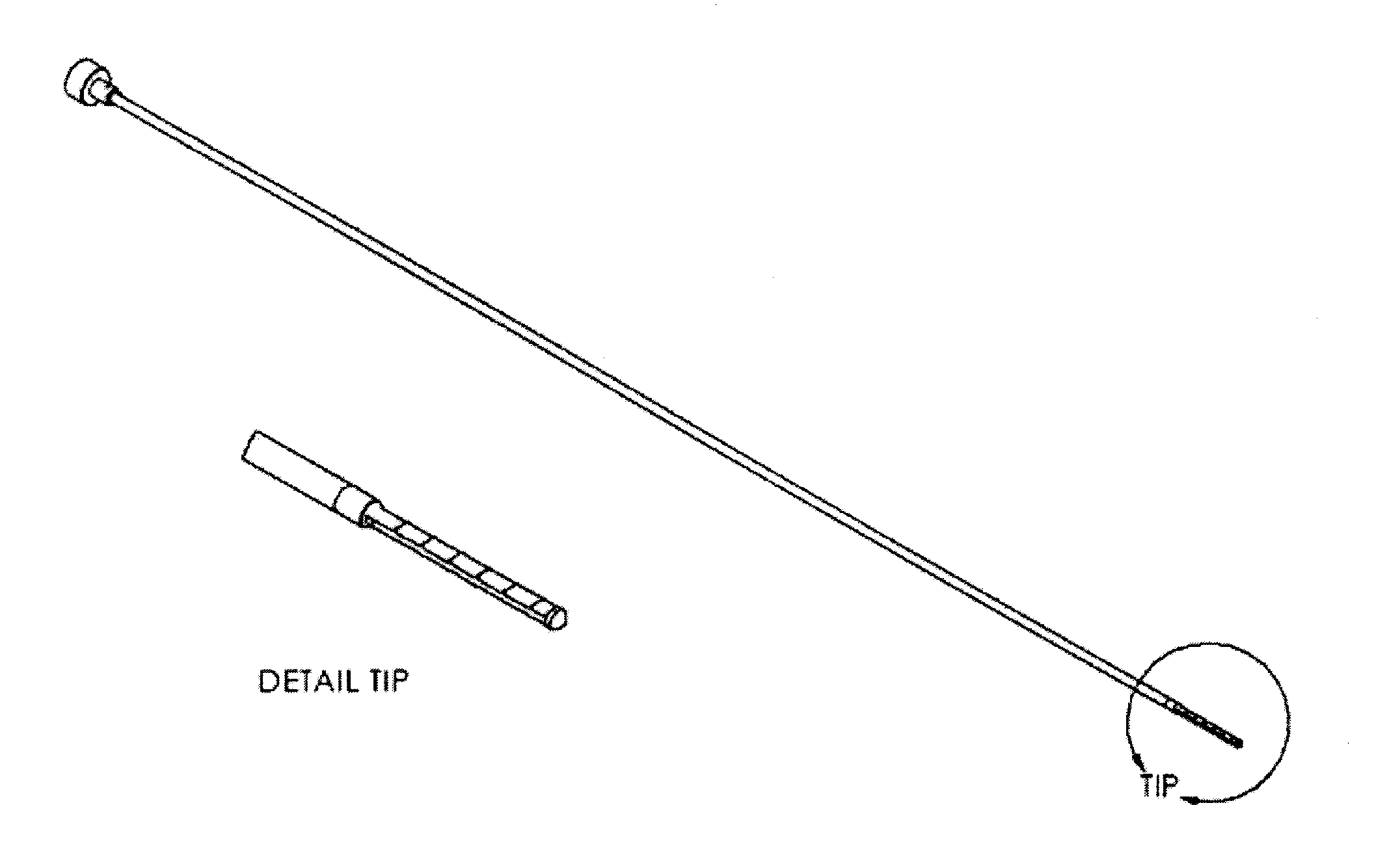

I almost hate to say this, but to check the fluid, you need a special dipstick. There is a cap on the transmission dipstick tube that is removable. Once removed, Chrysler has a dipstick that is used to determine if it is full.

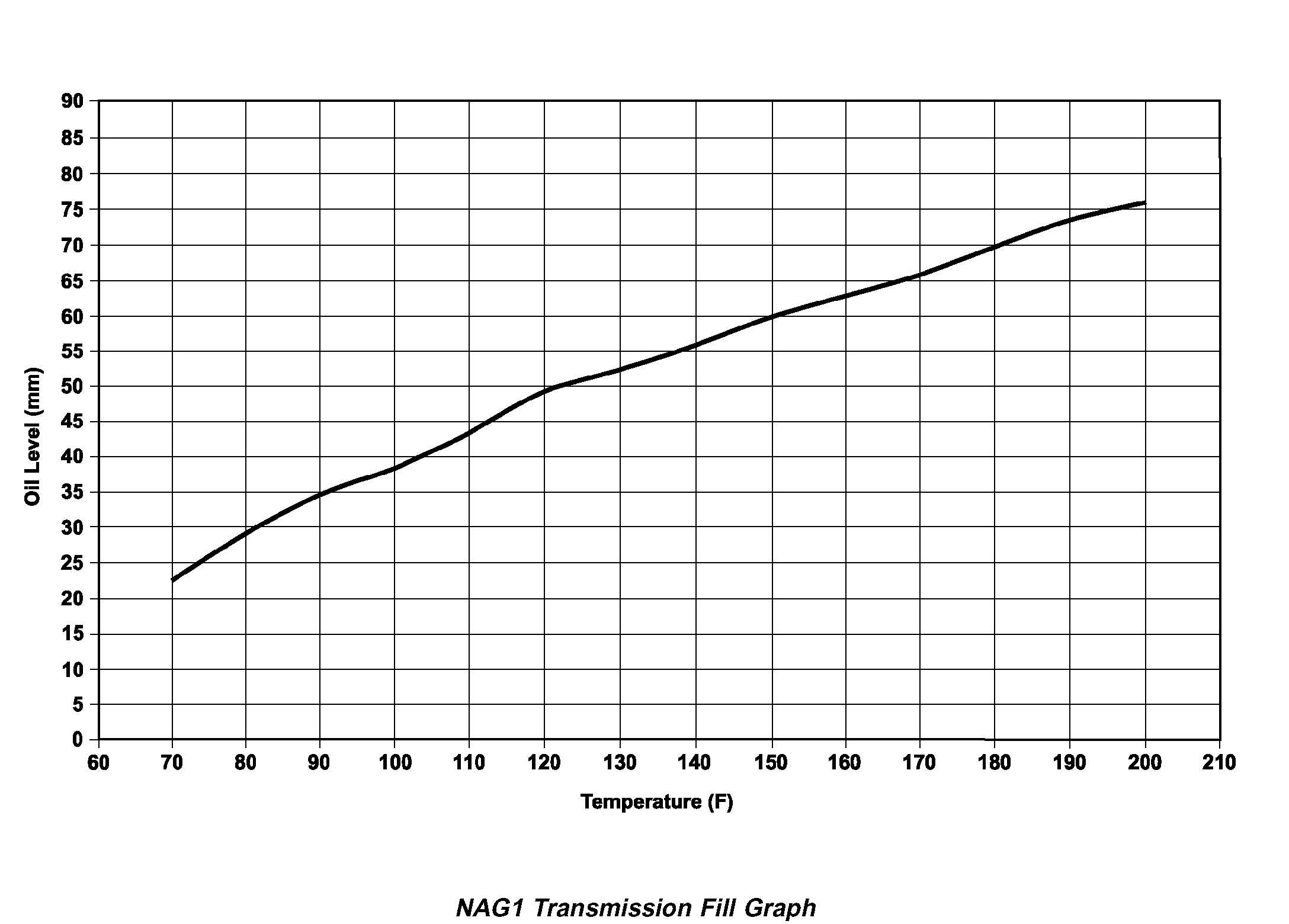

Here are the actual directions. The attached pics correlate with the directions.
CHECK OIL LEVEL
Special Tools
Dipstick 9336
pic 1

5. Warm up the transmission, wait at least 2 minutes and check the oil level with the engine running. Push the Oil Dipstick 9336 into transmission fill tube until the dipstick tip contacts the oil pan and pull out again, read off oil level, repeat if necessary.
NOTE: The dipstick will protrude from the fill tube when installed.
pic 2
6. Check transmission oil temperature using the appropriate scan tool.
NOTE: The true transmission oil temperature can only be read by a scan tool in REVERSE or any forward gear position.
7. The transmission Oil Dipstick 9336 has indicator marks every 10mm. Determine the height of the oil level on the dipstick and using the height, the transmission temperature, and the Transmission Fluid Graph, determine if the transmission oil level is correct.
8. Add or remove oil as necessary and recheck the oil level.
9. Once the oil level is correct, install the dipstick tube cap.
