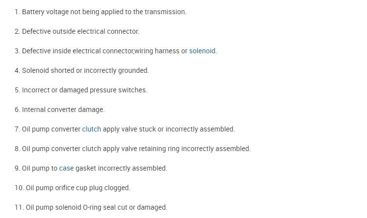

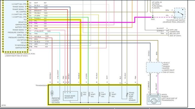

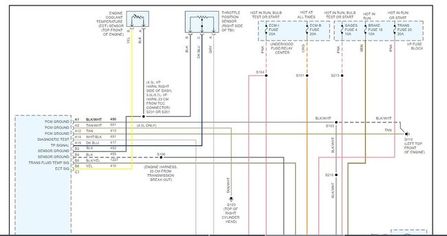

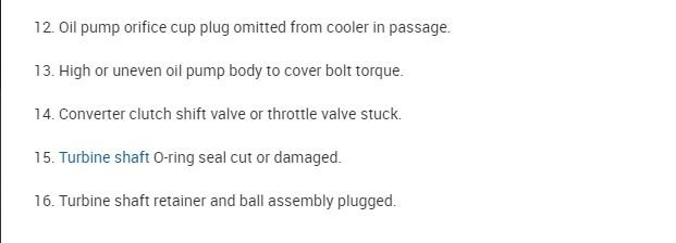

Truck wont shift to overdrive.
Feb 29, 2020 at 8:15 PM
Experienced Mechanic
52,796 POSTS
Good morning,
This could be the torque converter itself. There are clutches inside that do wear out.
Are there any codes stored?
I attached a possible issue failure chart below that needs to be checked.
