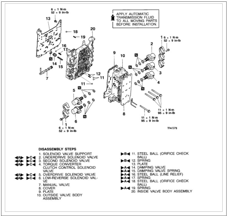

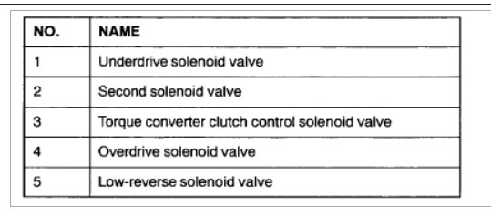

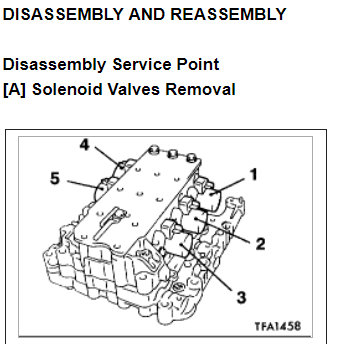

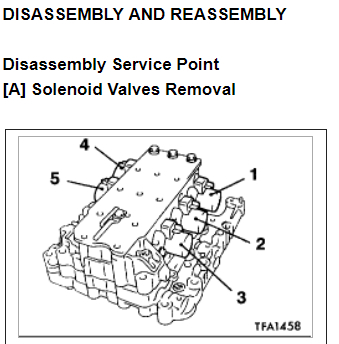

Where is the transmission solenoid assembly? I have the p1750 code on my car. Rev do not work and it is hard to get it to shift past second gear.

First make sure the transmission is full and has a clean filter which can effect the pressure.
Below is a guide showing the solenoid valve and their locations. Number three is the one you want to replace.
