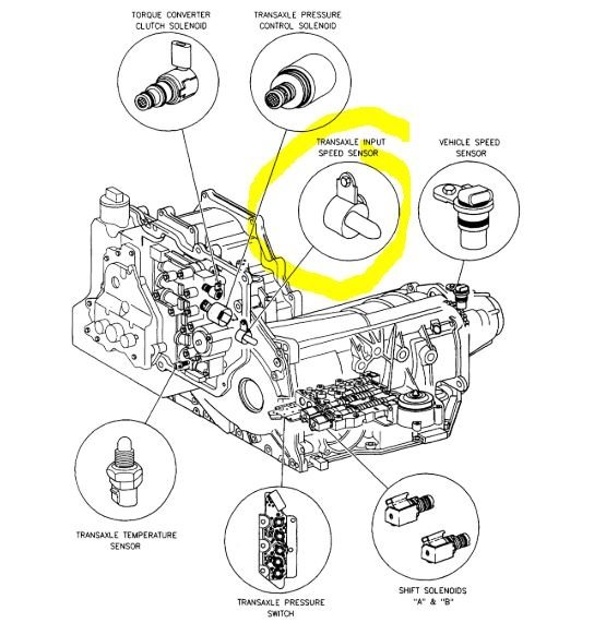

Transmission input speed sensor needs to be replaced. code reads 717 obd.
May 28, 2020 at 3:49 PM
Good morning,
The speed sensor is inside the side cover of the transmission.
This is a labor intensive job due to the fact that the axle has to be removed and the cradle has to be released to lower the transmission enough to remove the side cover.
Technically, the transmission has to be removed to gain access but an experienced tech can do it in the car.

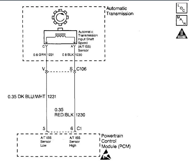

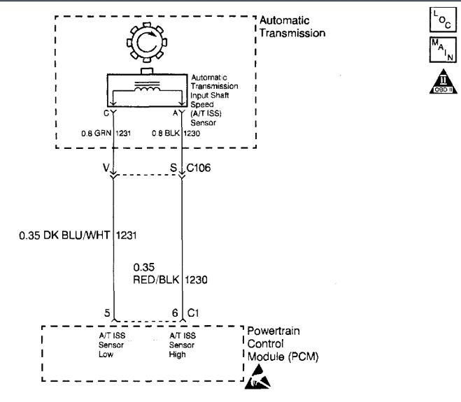

CIRCUIT DESCRIPTION
The Automatic Transmission input (Shaft) Speed (A/T ISS) sensor is a permanent magnet with a coil of wire wound around it. The A/T ISS sensor mounts in the transmission case facing the drive sprocket of the input shaft. An air gap of 0.045-0.109 in. between the sensor and the drive sprocket must be maintained so that an accurate AC voltage can be transmitted. Sensor voltage varies from 0.5 volts AC at 100 RPM to more than 100 volts at 8000 RPM. The A/T ISS sensor has a resistance value of 1300-1950 ohms.
When the PCM detects a low input speed while the vehicle and engine speeds are high, then DTC P0717 sets. DTC P0717 is a Type A DTC.

Inspect the wiring for poor electrical connections at the PCM. Inspect the wiring for poor electrical connections at the transmission 20-way connector. Inspect the wiring for poor electrical connections at the A/T ISS sensor 2-way connector. Look for the following conditions:
A bent terminal
A backed out terminal
A damaged terminal
Poor terminal tension
A chafed wire
When diagnosing for an intermittent short or open condition, massage the wiring harness while watching the test equipment for a change.
Inspect the transmission 20-way connector for transmission fluid.

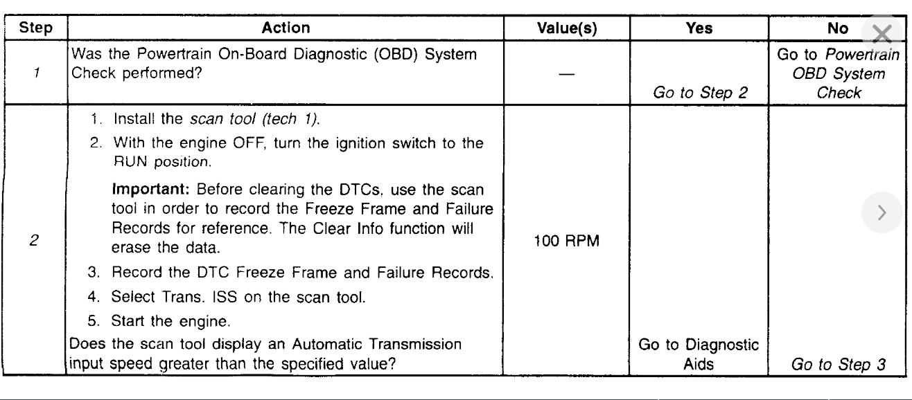

1. This Step ensures that you perform the Powertrain On-Board Diagnostic System Check.
2. This Step verifies that the DTC is set, and that Input (Shaft) speed RPM is displayed on the scan tool.

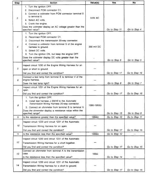

3. This Step inspects circuit 1230 and circuit 1231 for an AC voltage. Use the J 35616 Test Connector Adapter Kit, so as not to damage he terminals.
4. This Step inspects circuit 1230 for a voltage of 300 mV or greater.
5. This Step inspects circuit 1230 for an open or short to ground, if the voltmeter displayed less than 300 mV.
6. This Step verifies that circuit 1231 is not open.
7. This Step inspects circuit 1231 for an open, if the voltmeter displayed less than 300 mV.

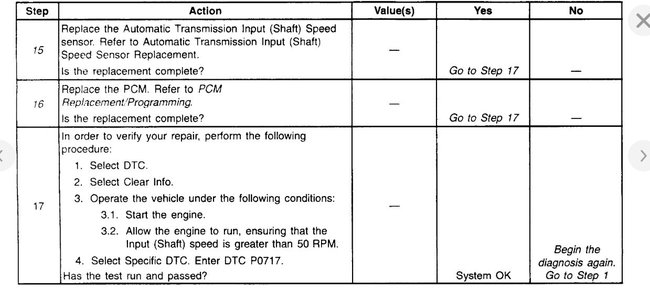

8. This Step measures the resistance value of the Automatic Transmission Input (Shaft) Speed sensor and circuitry. The ohmmeter must display a value between 1300-1950 ohms. Use the J 35616 Test Connector Adapter Kit, so as not to damage the terminals.
10. This Step inspects circuit 1230 and circuit 1231 of the Automatic Transmission Wiring Harness for an open, if the resistance value is greater than 1950 ohms. You must replace the transmission harness, if you find an open in the harness.
12. This Step inspects circuit 1230 and circuit 1231 of the Automatic Transmission Wiring Harness for a short together, if the resistance value is less than 1300 ohms. You must replace the transmission harness, if you find a short together in the harness.
13. This Step tests the 1231 and 1231 circuits for a short to ground if the resistance value is less than 100 ohms. You must replace the transmission harness, if you find a short to ground in the harness.
15. This Step replaces the A/T ISS Sensor after you verify that the Engine Wiring Harness and the Automatic Transmission Wiring Harness are functioning normally.
16. This Step replaces the PCM after you have inspected the components and circuitry.
