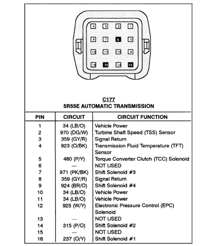

I have the vehicle listed above with a 5r55e transmission that went out. i have found one for it thats a 5r55e that came out of a 2000 Ford Explorer with the 4.0l like mine. Will it work in my explorer
Apr 27, 2021 at 12:09 AM

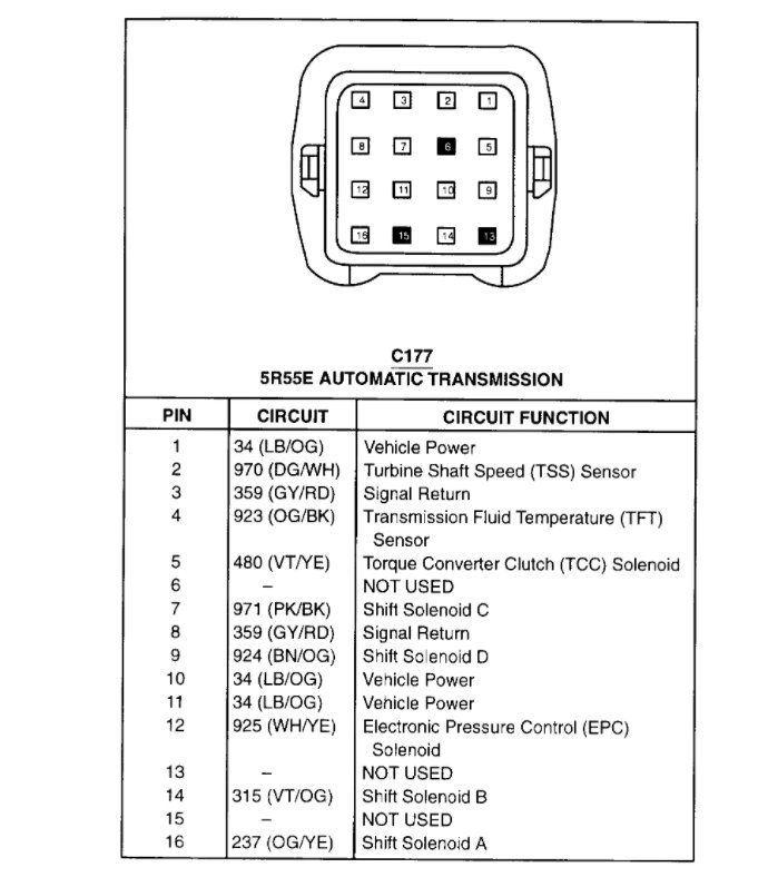

I matched up the connectors for both transmissions and they are the same. Check out the diagrams (Below). Please let us know what you find. We are interested to see what it is. The transmission wiring diagrams are in the next post below.

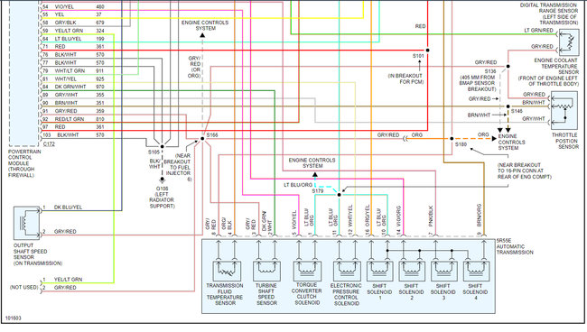

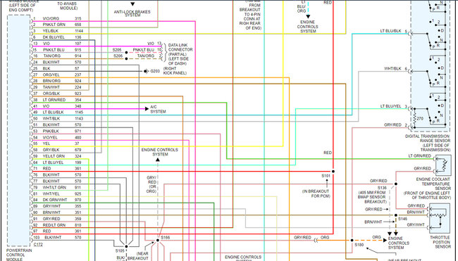

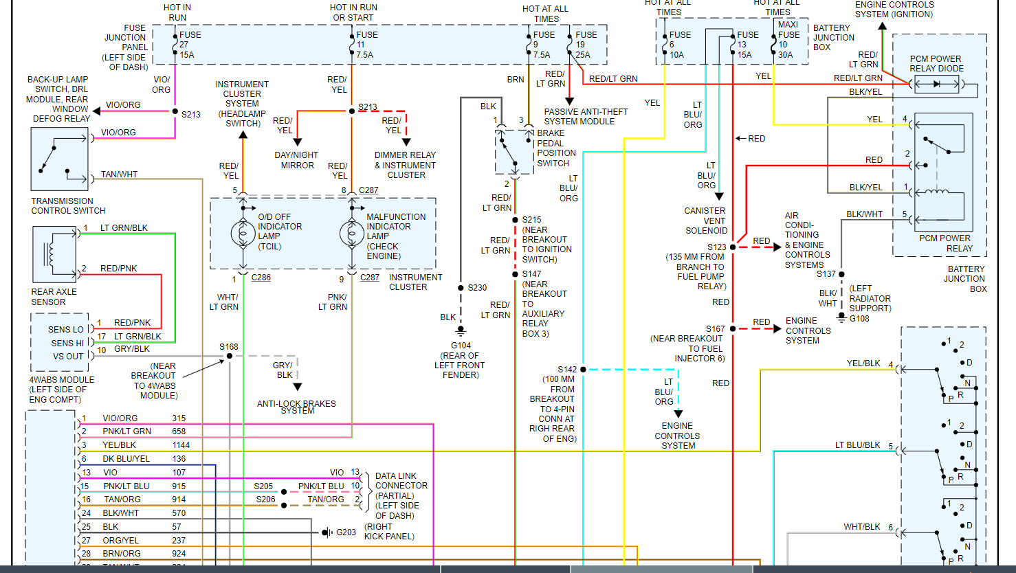

I attached the wiring diagram for you of the transmission.
I would verify the wire colors are the same on the connector from the transmission to the body harness.
