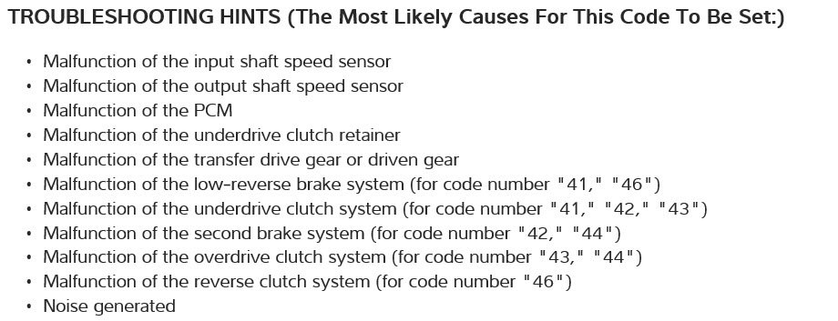

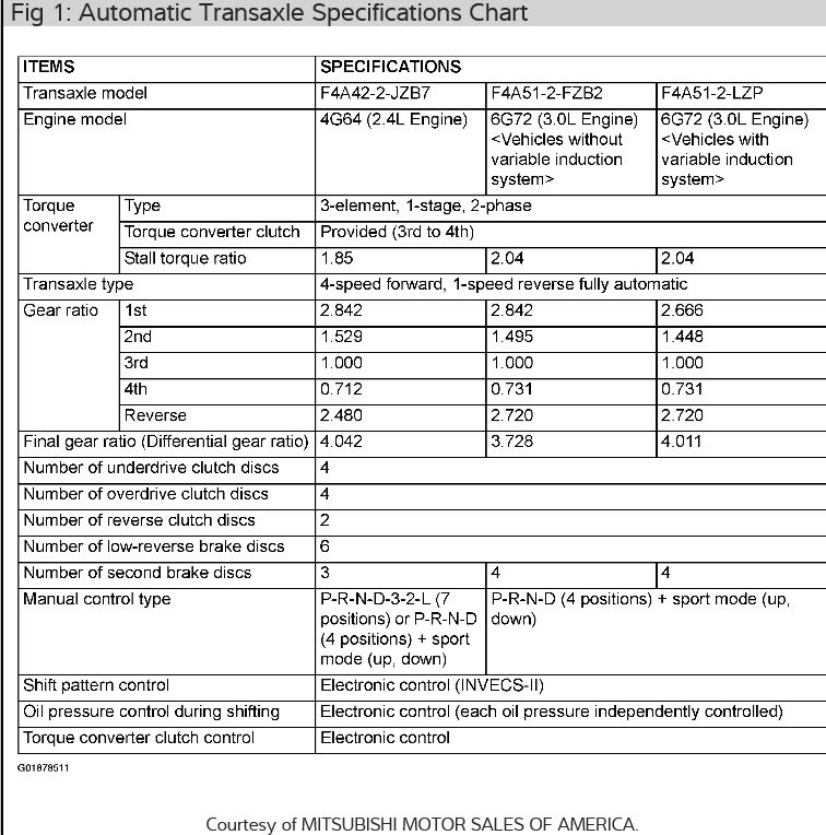

Okay guys, so I have the right transmission now the LPZ. I put it in and got it all hooked up and back together and it does the same thing as my original. But this one throws a code p0734, which is Incorrect fourth gear ratio. I am at a point where I am tired of pulling transmissions. So now I just want to rebuild it and be done with it. My issue is their are three different rebuild kits and I do not know one which one to get. I have no metal in the fluid and it is not discolored. Can anyone help with how in depth this rebuild will be? what all my kit should consist of? I need to know which one I need to order. Thanks guys.

your kit should have steel rings, clutches, steel plates and seals as well as filter if there is one. in chart in picture you will see there are three different transmissions which tell everything you need to know. if you still have your original it should have a tag or marking on it. use that one unless case is broken. rebuilding your transmission is probably not the problem. See pictures.
