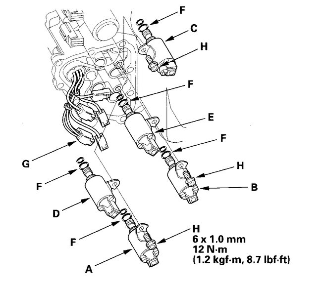

The car shifts fine but when it gets into fourth gear at about 43 mph it shifts into neutral and the engine revs until you slow to about 20 then it will go back into second gear. The D indicator flashes also until the next start cycle.

Thank you. I have codes P1730, P0780 and P0757. My scan tool tells me I have a problem with the shift solenoid B. Have you seen this before?
Nov 18, 2019 at 2:26 AM
  • 110,194 POSTS
Hi:
You have a bad shift solenoid. It's stuck on which is causing the issue. Look at the descriptions below.
DTC P0757: Shift Solenoid Valve B Stuck ON
P0780 means there is one or more A/T DTCs stored.
DTC P1730: Problem in Shift Control System:
^ Shift Solenoid Valves A or D Stuck OFF
^ Shift Solenoid Valve B Stuck ON
^ Shift Valves A, B, or D Stuck
_______________________________________
Shift solenoid B is in the transmission. Here are the directions for replacement. The attached pics correlate with the directions.

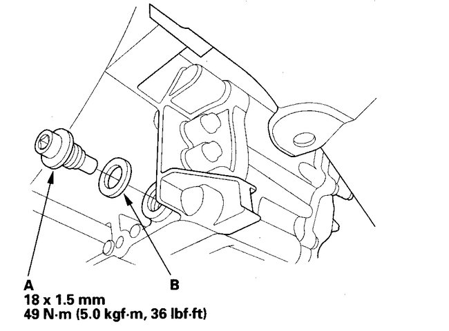

2. Remove the splash shield.
pic 1
3. Remove the drain plug (A), and drain the automatic transmission fluid (ATF). Then reinstall the drain plug with a new sealing washer (B).

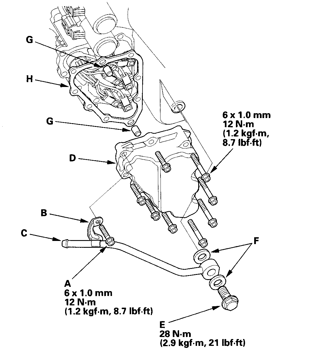

8. Disconnect the shift solenoid harness connector.
pic 2
9. Remove the bolt (A) securing the bracket (B) of the ATF cooler inlet line (C) on the shift solenoid valve cover (D), and remove the line bolt (E) and sealing washers (F).
10. Remove the shift solenoid valve cover, dowel pins (G), and gasket (H).

11. Disconnect the shift solenoid valve connectors, remove the solenoid mounting bolts, then hold the solenoid valve body and remove the shift valves. Do not hold the connector to remove the shift solenoid valve.
12. Install the new O-rings (two O-rings per solenoid valve) (F) on the reused solenoid valve.
NOTE: A new solenoid valve comes with new O-rings. If you install a new solenoid valve, use the 0rings provided on it.
13. Install the shift solenoid valves C, D, and E. While holding the shift solenoid valve body, be sure to install the solenoid valves until their mounting brackets contact the servo body.
14. Install the shift solenoid valves A and B. While holding the shift solenoid valve body, be sure to install the solenoid valves until their mounting brackets contact the bracket of the installed solenoid. Install the solenoid mounting bolts (H) and tighten them.
NOTE: Do not install the solenoid valves A and B before installing the shift solenoid valves D and E. If solenoid valves A and B are installed before solenoid valves D and E, it may damage the hydraulic control system.
15. Connect the shift solenoid valve D connector (G) with the ATF temperature sensor.
16. Connect the solenoid valve A connector (BLU wire), solenoid valve B connector (ORN wire), solenoid valve C connector (GRN wire), and solenoid valve E connector (RED wire).
17. Install the shift solenoid valve cover, dowel pins and a new gasket.
18. Install the ATF cooler inlet line with the line bolt and the new sealing washers. Create clearance with the jack between the transmission and the front subframe to tighten the line bolt to the specified torque with the torque wrench.
19. Secure the ATF cooler line bracket on the shift solenoid valve cover with the bolt.
