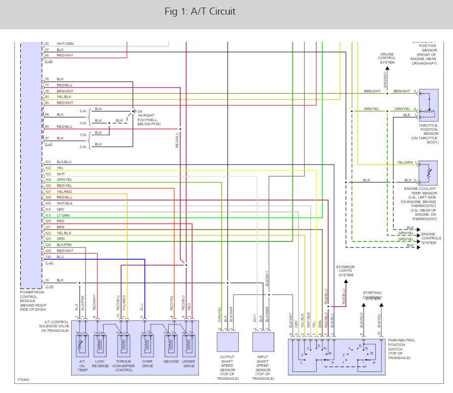

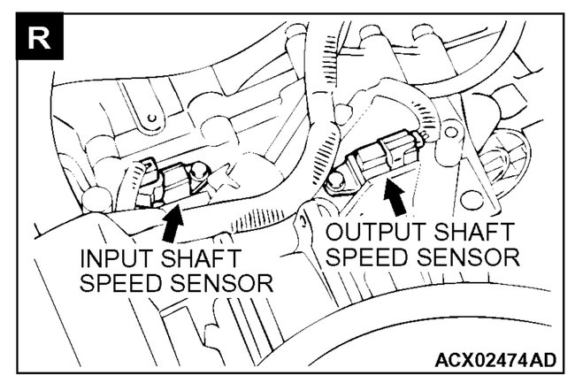

The transmission goes from first to second to third but not from third to drive. While driving on the interstate it will not go out of third gear and to drive.

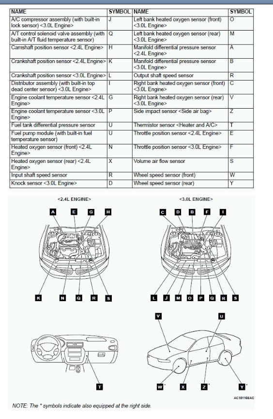

It sounds like you have a input shaft speeds sensor that is out. But to be sure lets run the codes to see what comes up
Here is the location of the sensor. Check out the diagrams (Below). Please let us know what you find.

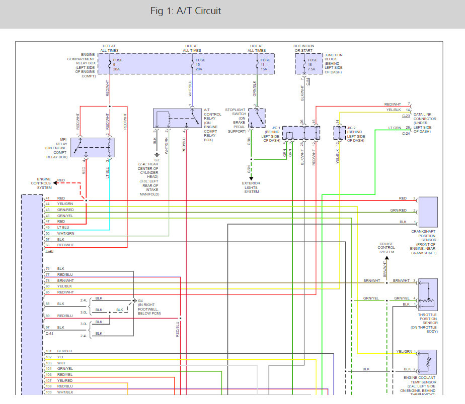

Try a new scanner or see if it works on another car. Also check the fuse # 6 on the left side of the dash this powers the ALDL connector.

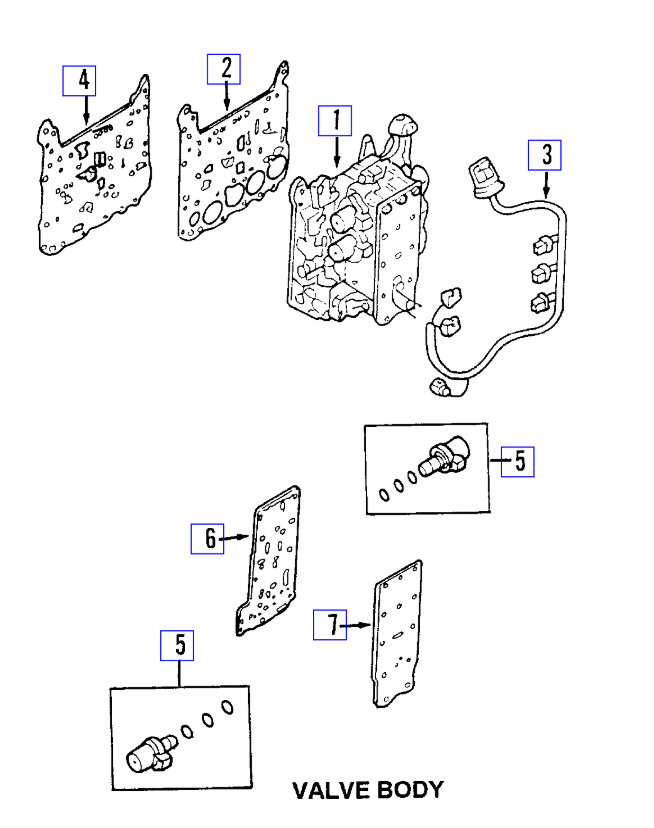

It sounds like you have an overdrive shift solenoid that is not working. Here is the transmission wiring diagrams to help you see how the system works and the valve body showing the solenoid. I would change out the one with the blue wire going to it. Check out the diagrams (below). Please let us know what happens.

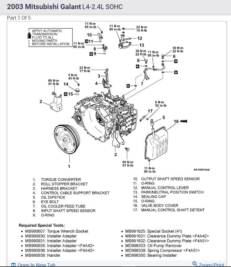

Ok is that on the inside of the transmission or outside? Thanks
Nov 3, 2018 at 1:48 AM
  • 55,748 POSTS
Inside, you must remove the pan, here is a diagram. Check out the diagrams (below). Please let us know what you find. We are interested to see what it is.
