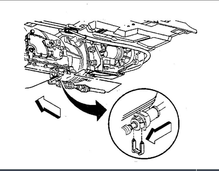

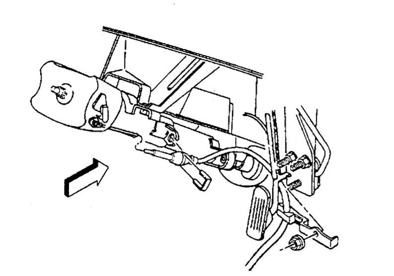

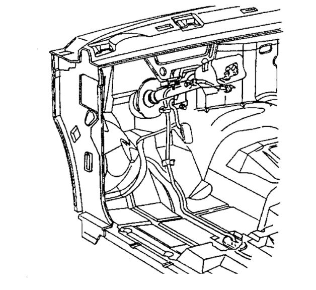

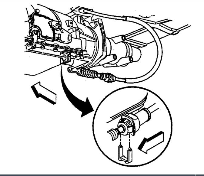

The transmission was shifted into reverse and still moved forward. afterwards the vehicle was turned off and would not restart. now it will not shift into any gear it rolls freely in all gears the same as if it were in neutral.
Nov 11, 2020 at 4:00 AM
Good afternoon,
Does the gear shift feel loose? From your description, it sounds like the shift cable has failed.
I attached the procedure for you below with some pictures.
Have someone look under the truck and see if the linkage moves when you try to shift gears. I think the cable is not working.
REMOVAL PROCEDURE
1. Apply the parking brake.
2. Shift the transmission into neutral.
3. Remove the steering column filler panel.
4. Remove the door sill trim plate.
5. Remove the cowl side trim panel.
6. Remove the seat from vehicle.
7. Remove the retainer securing the shift cable to the steering column.
Important: The removal of the shift cable from the floor shift control is similar to the removal of the shift cable from the column shift control.
8. Remove the shift cable end from the steering column shift bracket.
9. Remove the nut securing the shift cable and the clip to the pedal bracket.
10. Remove the grommet and tape securing the shift cable to floor panel.
11. Raise and support the vehicle.
12. Remove the retainer securing the shift cable to the transmission bracket.
13. Squeeze the retainers while pulling the cable towards the rear of the vehicle.
14. Remove the shift cable end from the transmission control lever.
15. Remove the shift cable from the vehicle.
