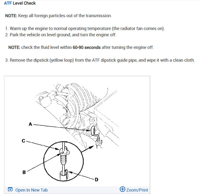

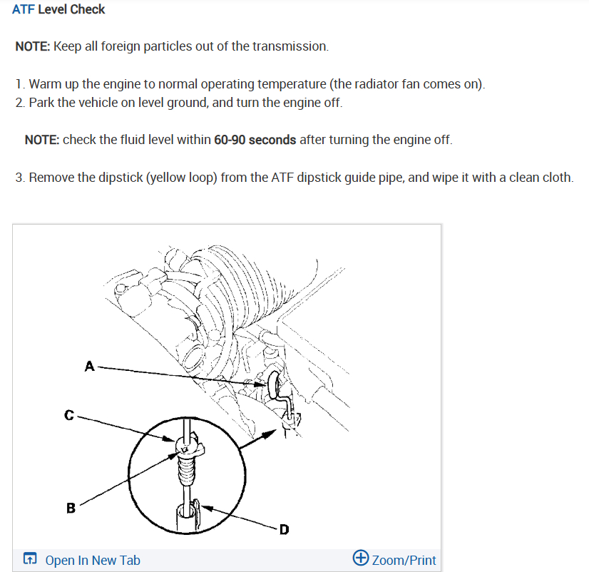

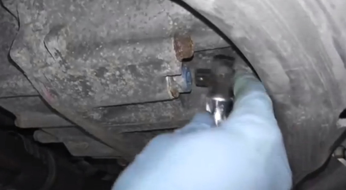

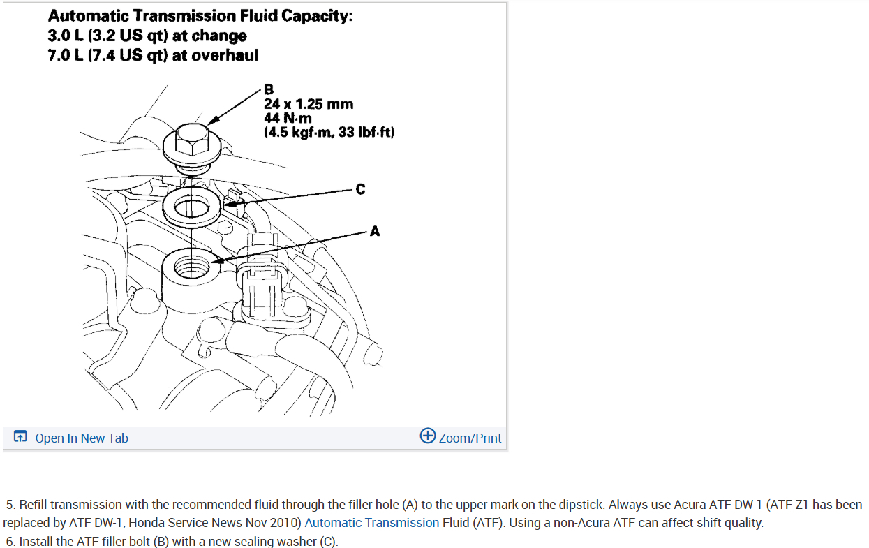

The first thing I would do is check the transmission fluid level and change it if it is burnt or dirty. Here is a guide to help with instructions in the images below for your car, also can you please upload a short video of what the car is doing so I can see it, this will help me fix it with you. I would check the transmissions mount as well because it sounds bad if the others were in bad shape then it is probably bad as well.
https://www.2carpros.com/articles/how-to-service-an-automatic-transmission/
Use this fluid only.
ATF (Automatic Transmission Fluid) .................... Use Honda ATF
DW-1
(ATF Z1 has been replaced by ATF DW-1, Honda Service News Nov 2010)
Check out the images (below). Let me know how it goes
