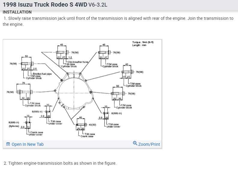

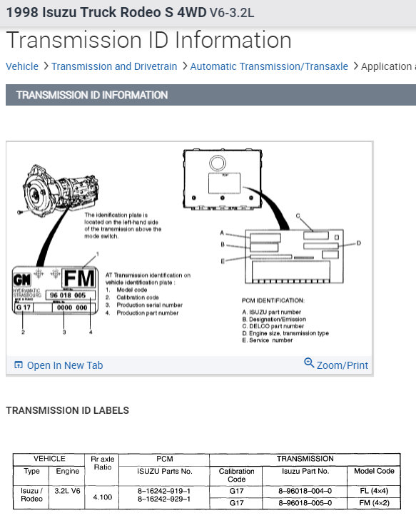

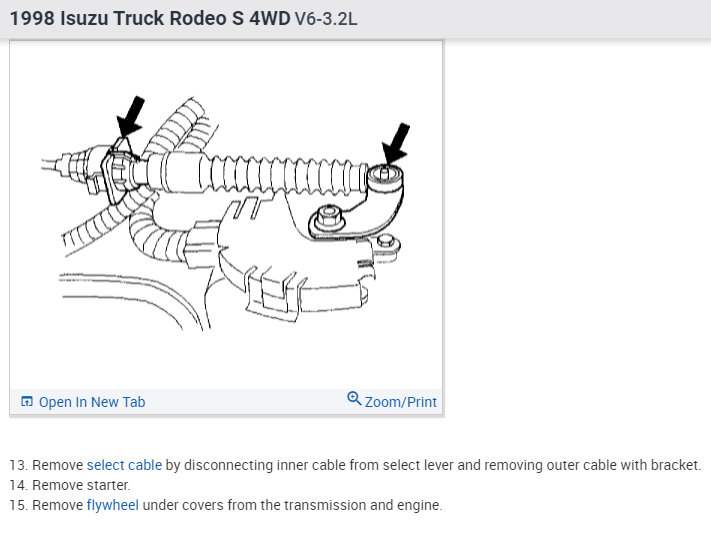

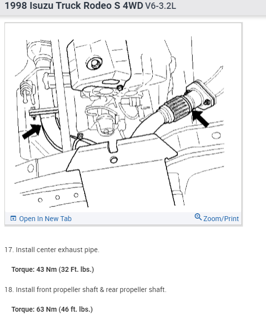

Will a transmission from a Trooper fit my Rodeo? 3.2 engine 1998 yes they are both 4x4.
Sep 28, 2018 at 4:28 AM
DANNY L
  • 5,648 POSTS
Hello, I am Danny.
If both the Trooper and Rodeo are both 1998 and a 4x4 they are both the the same 4L30-E transmission. Hope this helps and thanks for using 2Carpros.
Danny-
Apr 5, 2021 at 6:31 AM
CHERYLBROWNJOHNSON

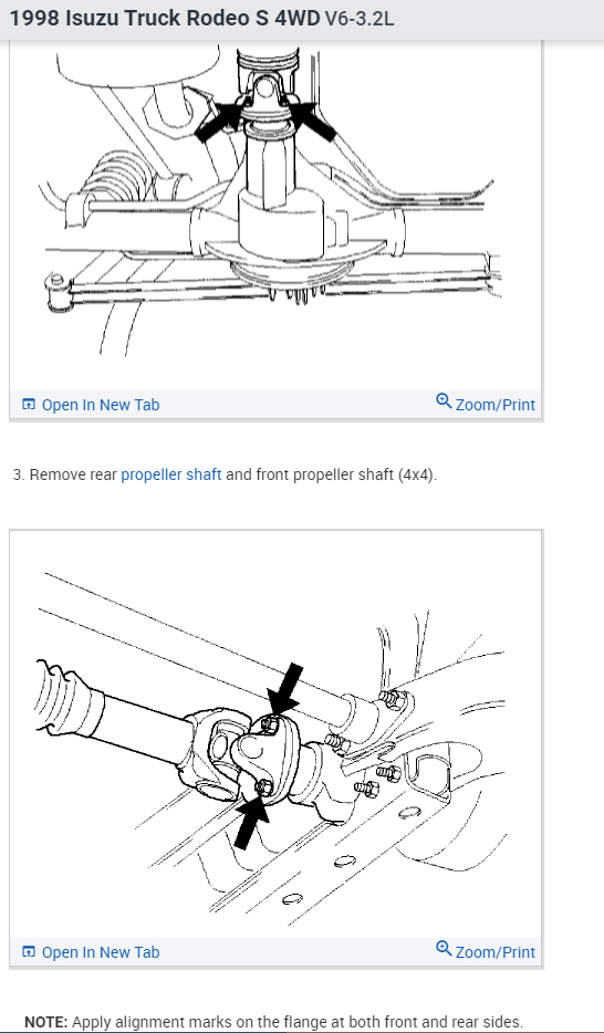

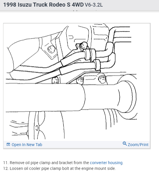

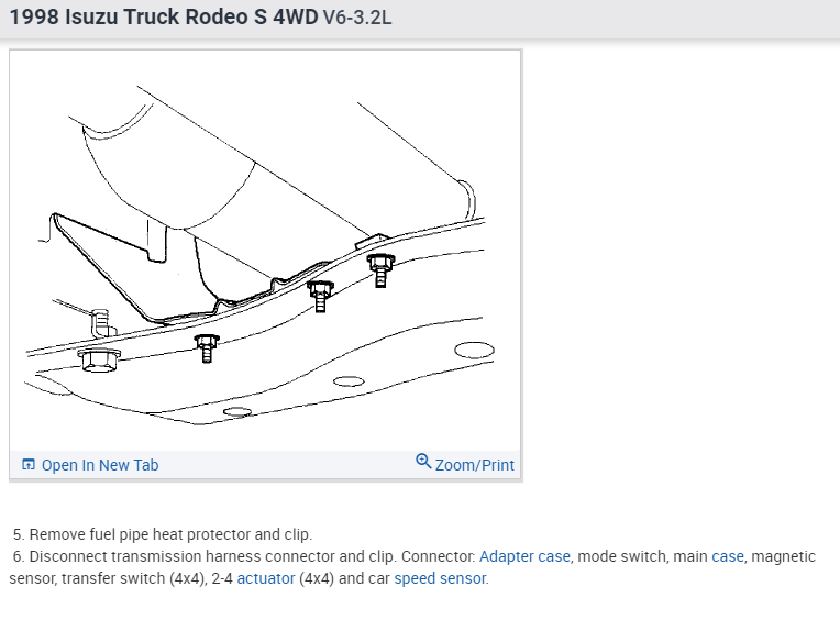

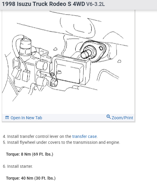

Thank you. can you give me how to do it?
SQM
  • 6,383 POSTS

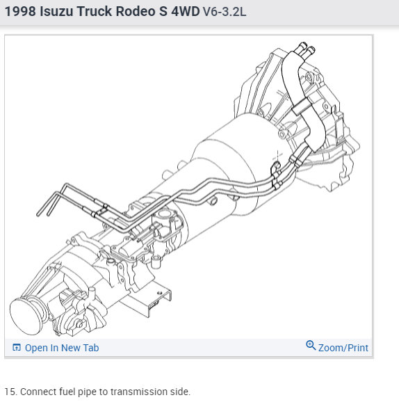

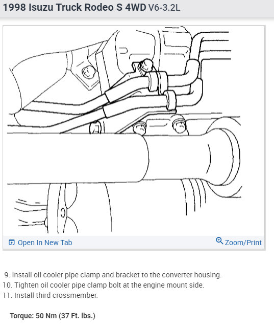

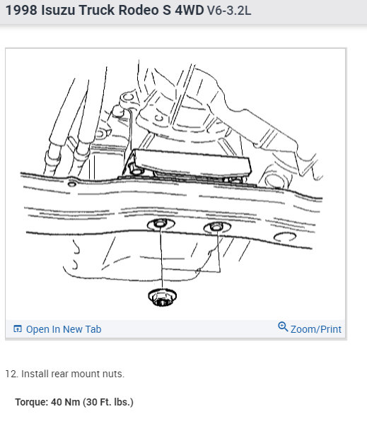

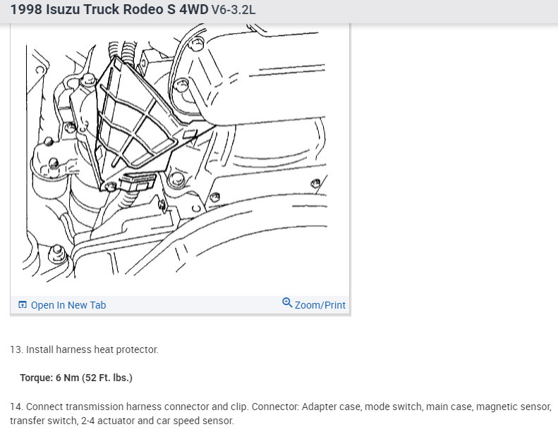

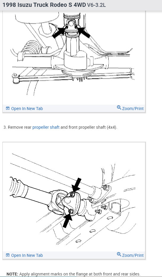

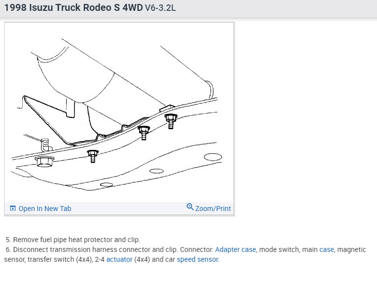

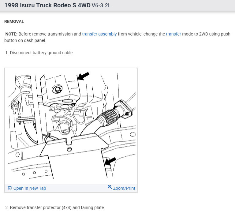

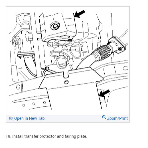

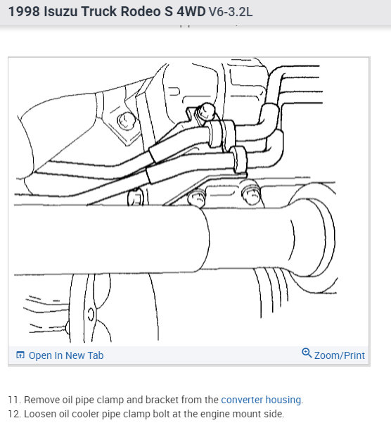

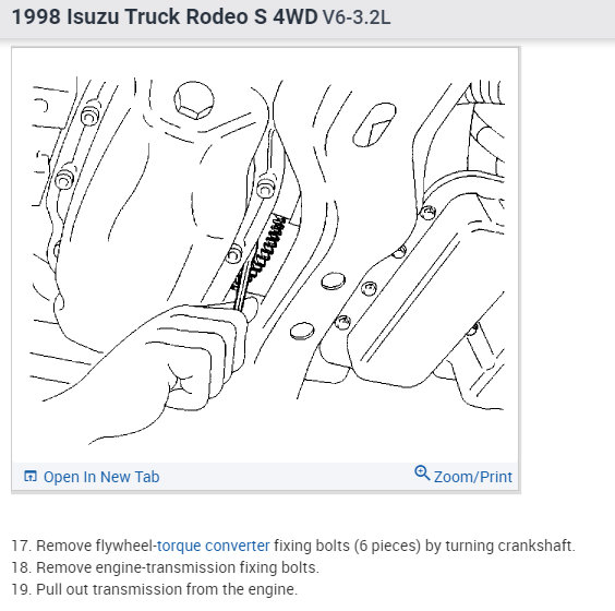

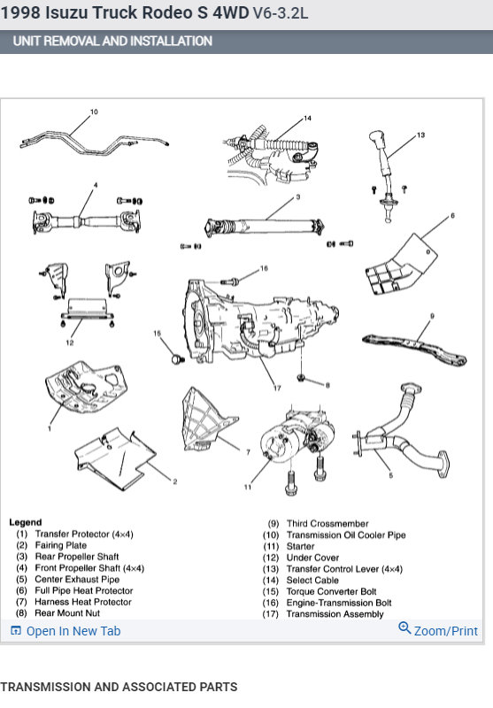

Here is a helpful guide:
https://www.2carpros.com/articles/how-to-remove-an-automatic-transmission-rwd

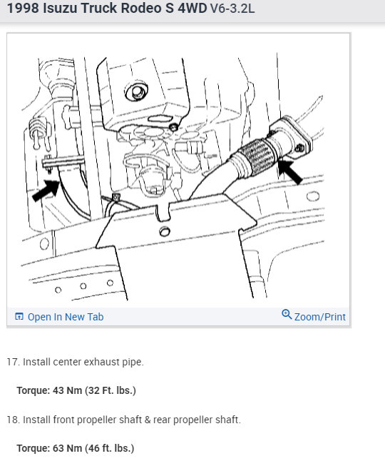

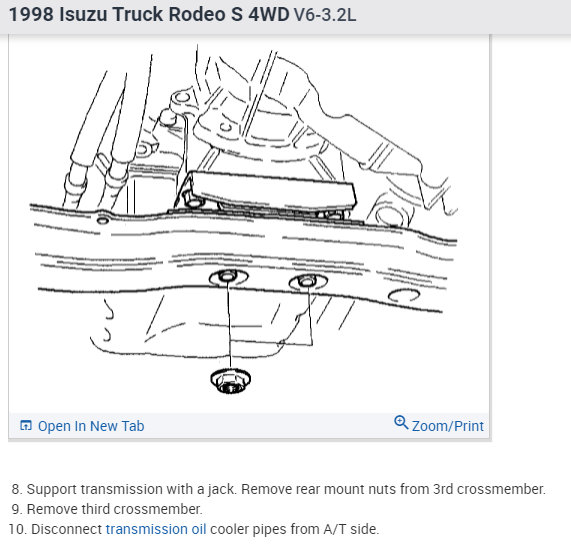

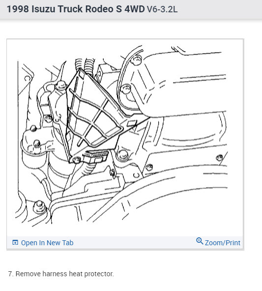

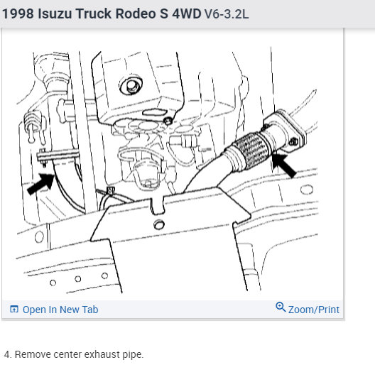

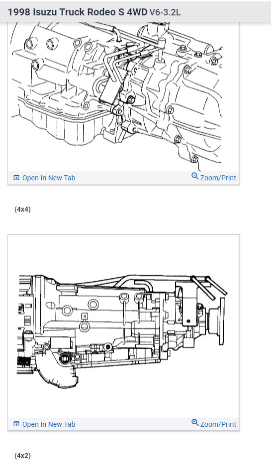

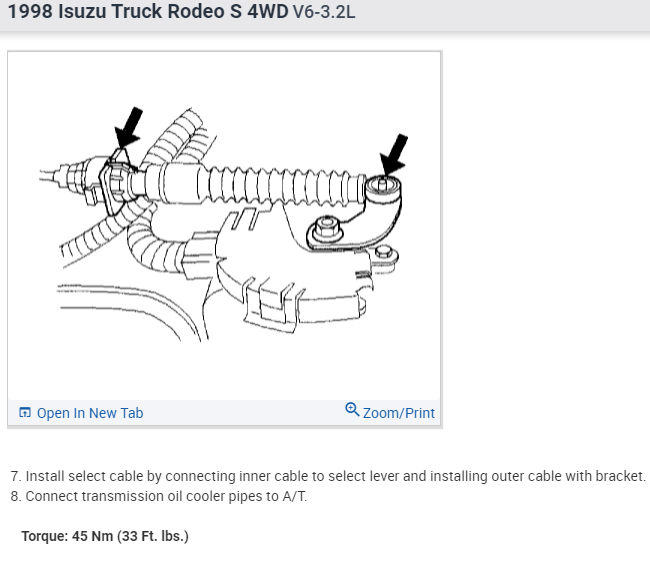

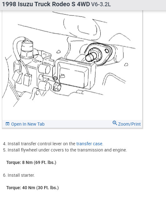

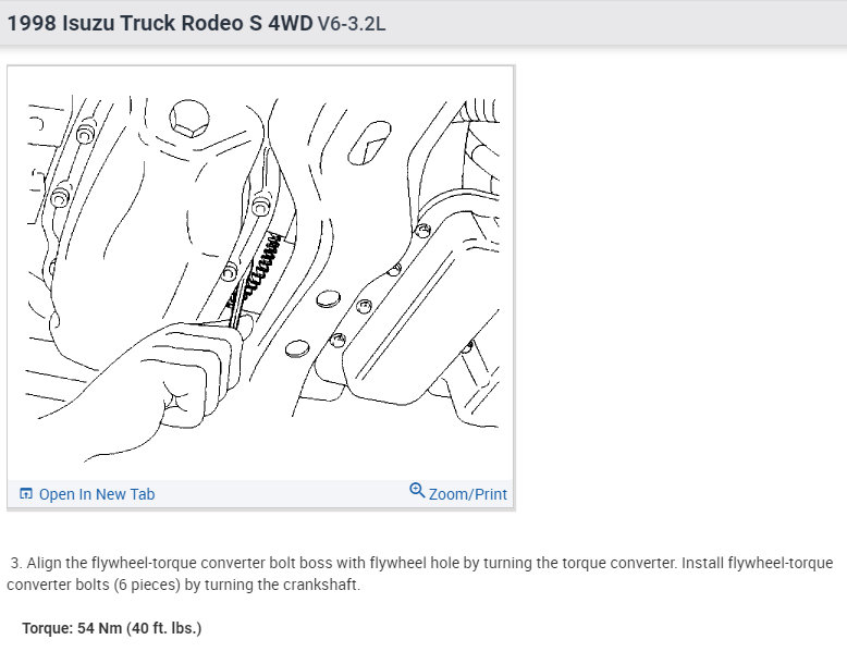

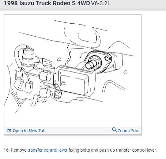

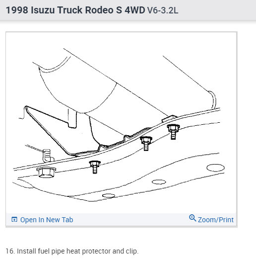

I have attached the transmission replacement procedure for the Rodeo below.
Pleas let me know of any questions.
