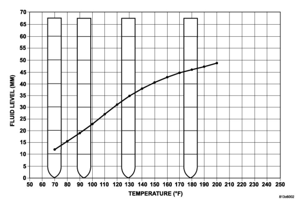

Transmission shifts gears great on normal city drives (30-55mph), but at highway cruising speed (65-75-80) the transmission slips even at steady acceleration. Any thoughts on the matter?

Here are the directions for checking fluid and condition. The attached pic correlates with the directions. The problem you may have is there is no dipstick. You need to have a specific one. Often times, parts stores sell them.

5. Warm up the transmission, wait at least 2 minutes and check the oil level with the engine running. Push the Oil Dipstick 9336 into transmission fill tube until the dipstick tip contacts the oil pan and pull out again, read off oil level, repeat if necessary.
NOTE: The dipstick will protrude from the fill tube when installed.
pic 1
42RLE Fluid Temperature Chart
6. Check transmission oil temperature using the appropriate scan tool.
7. The transmission Oil Dipstick 9336 has indicator marks every 10 mm. Determine the height of the oil level on the dipstick and using the height, the transmission temperature, and the Transmission Fluid Graph, determine if the transmission oil level is correct.
8. Add or remove oil as necessary and recheck the oil level.
9. Once the oil level is correct, install the dipstick tube cap.
