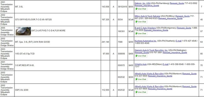

Here is a link to finding a used transmission:
Www.car-part.com
Feb 11, 2020 at 4:16 AM
