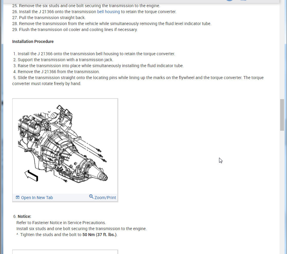

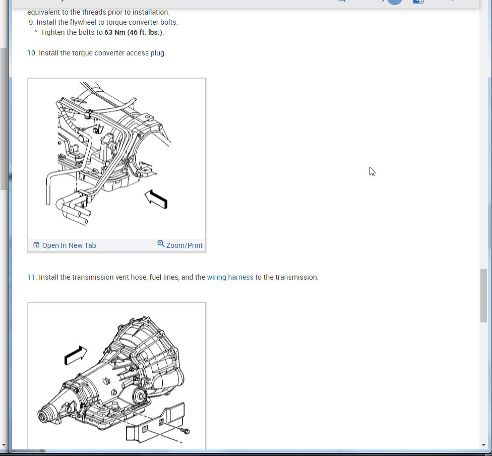

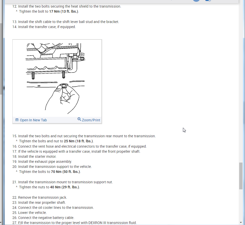

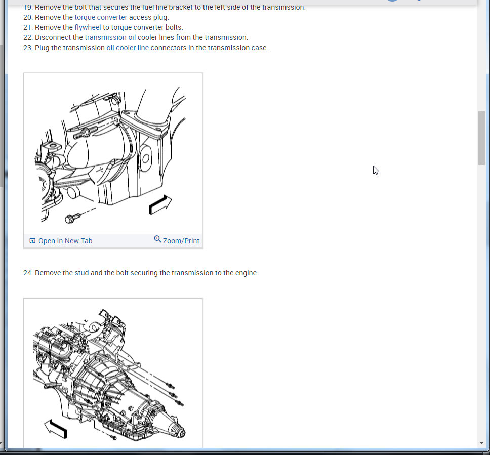

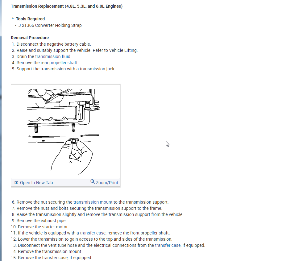

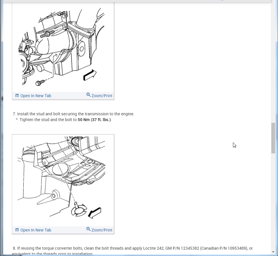

Need to know what transmissions interchange. At this point don't care if transmission is 2wd. Help
Mar 17, 2020 at 4:59 AM

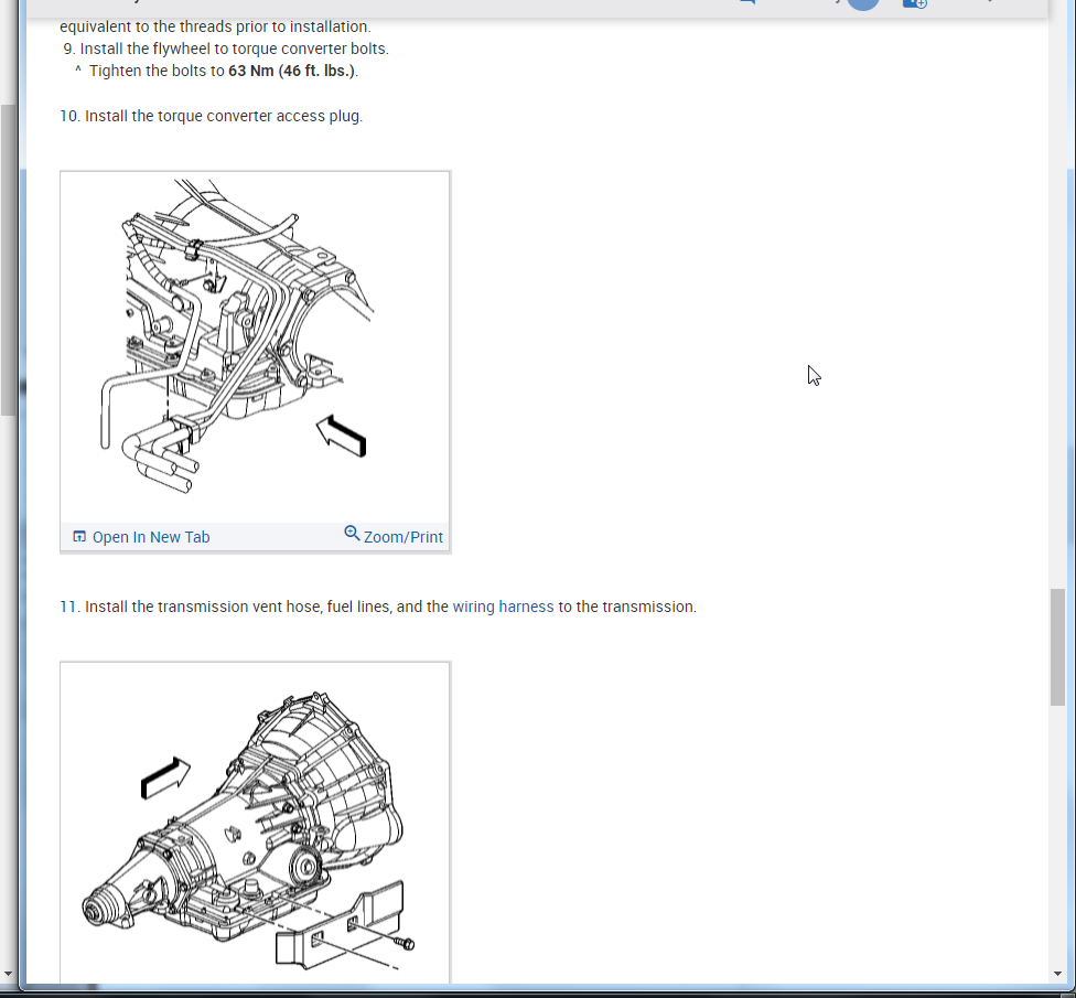

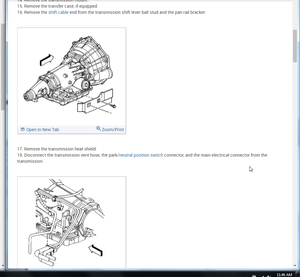

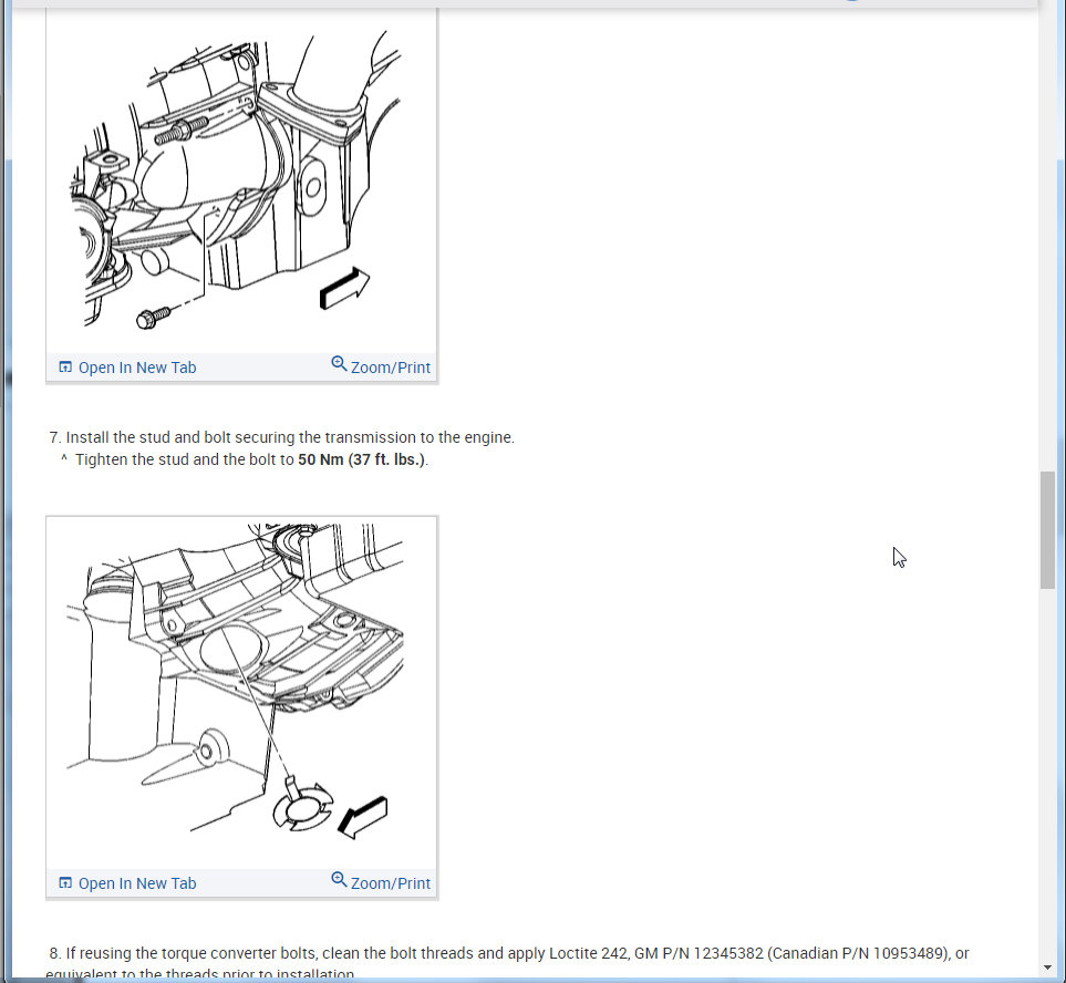

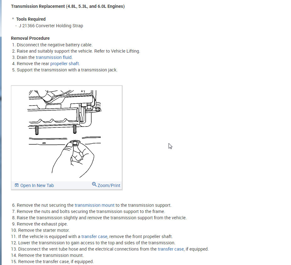

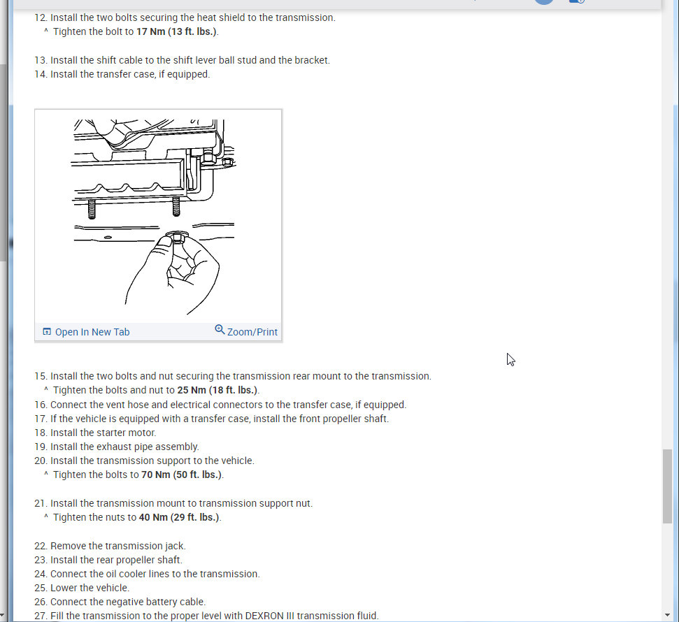

You should have the 4L60/65 or 80/85 E transmission. You can swap in any other E transmission but if it is out of a different body style then you may have some wiring alterations to make but it should fit with no issue.
Here is a video that will help with this:
https://www.youtube.com/watch?v=3vJAojsrfuU
Below you will find the process from the manual that will help with this the replacement.
Let us know if you have other questions. Thanks
