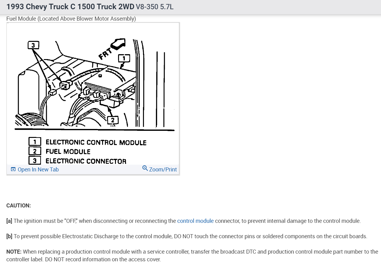

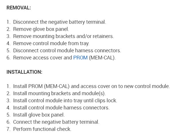

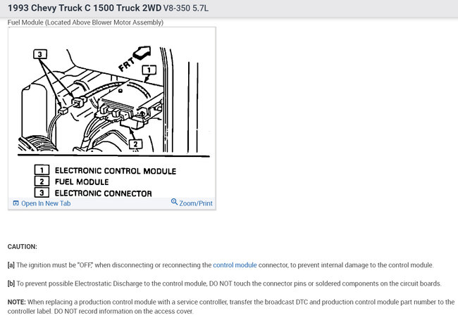

With that many codes I have seen the PCM be the problem FYI. Here is how to replace it if needed. Also, check the ground and power sources to the PCM. Check out the images (below). Please let us know what happens.
