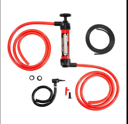

I bought this vehicle a few weeks ago. Noticed it shifts hard from 2 to 3. And reverse to drive is funky. Pulled plug from side of transmission to check fluid level. Extremely low. All mechanics I've contacted say to fill, I NEED a pump. There has to be another way. Can I run a hose to the hole to outside the vehicle and use a funnel and gravity? There has got to be a way to fill them without the pump.thanks for the help.

Hello, yes you will need a pump which can be purchased for less than $10 at Harbor Freight. Please see the attached screenshot for reference, SKU #63144.

Oh holy crap. I friggin knew that!!!! What's wrong with me? Thanks. Next time im gonna have my wife do it. Wow I feel dumb.
