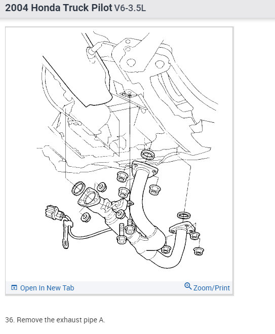

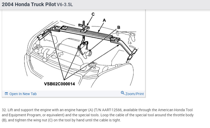

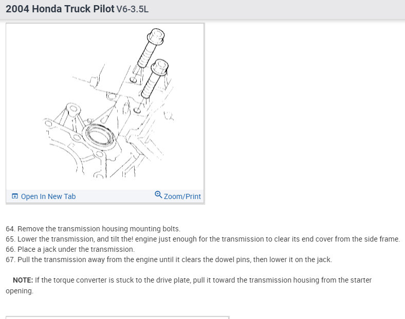

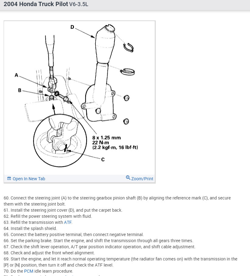

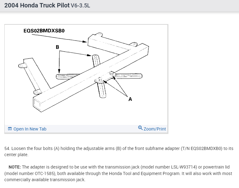

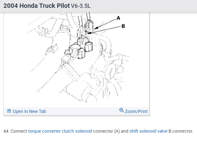

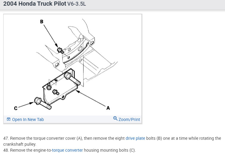

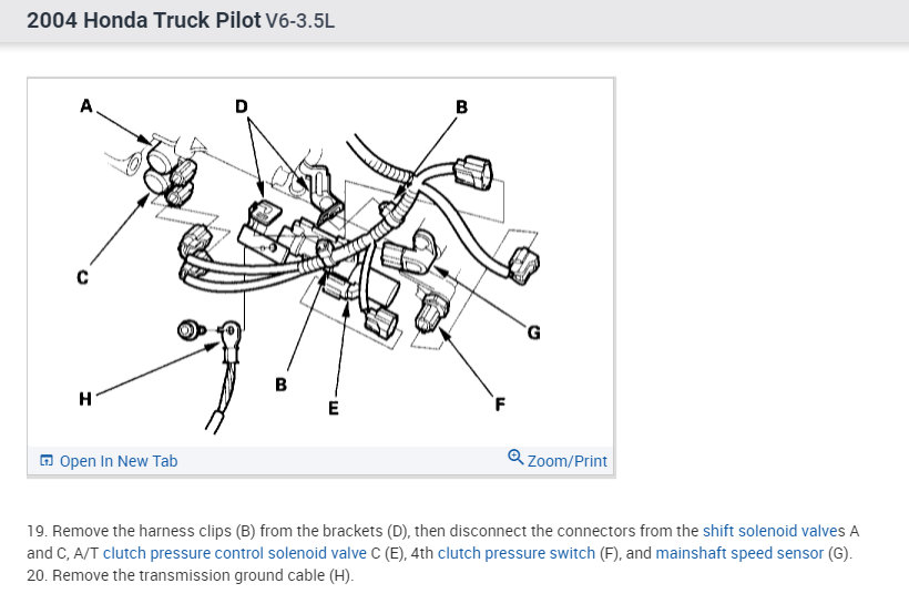

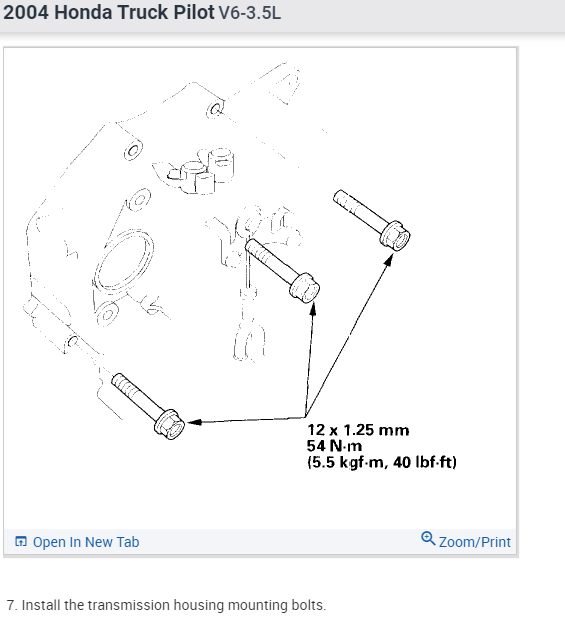

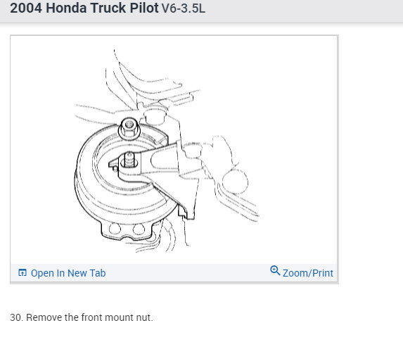

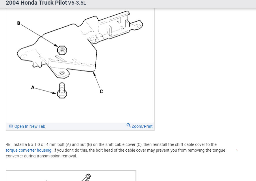

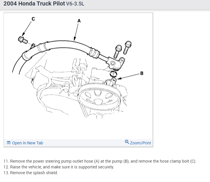

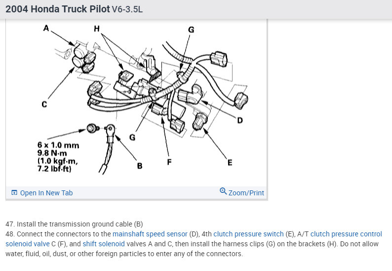

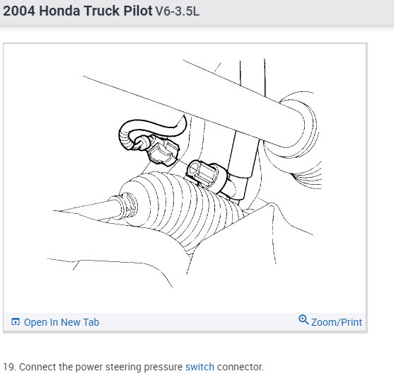

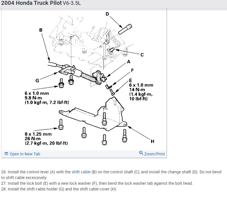

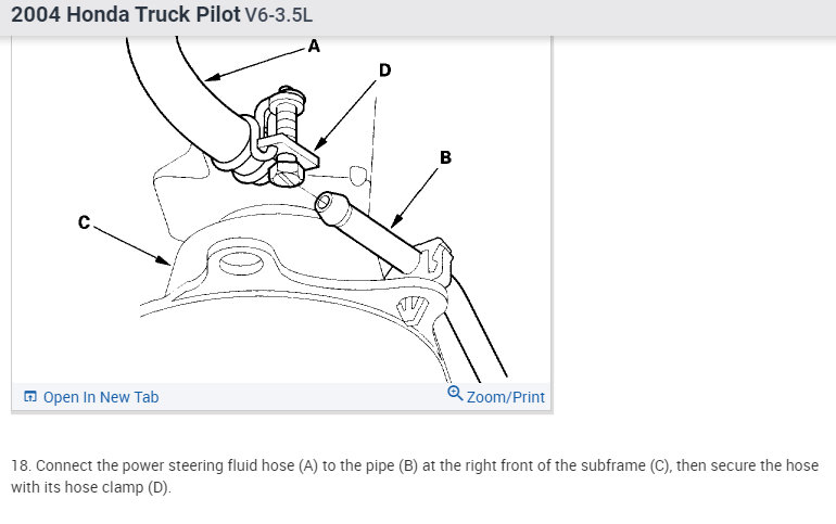

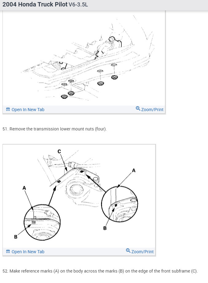

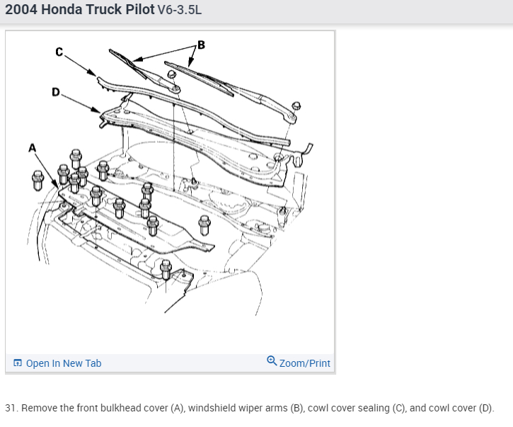

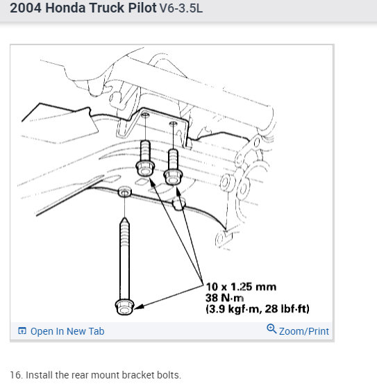

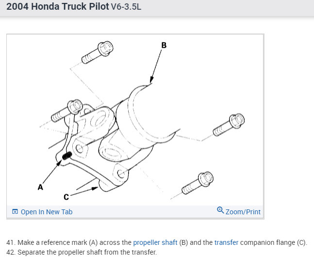

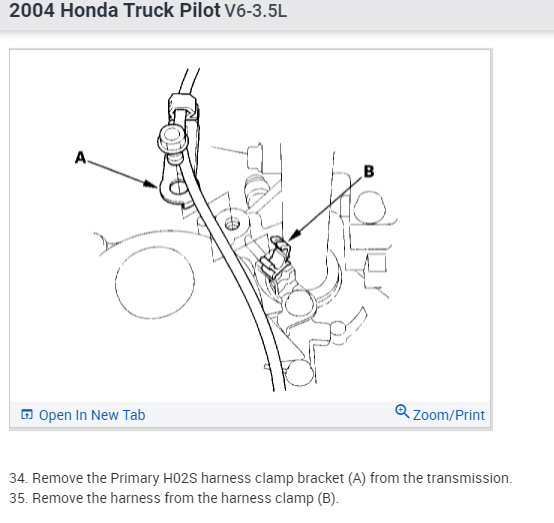

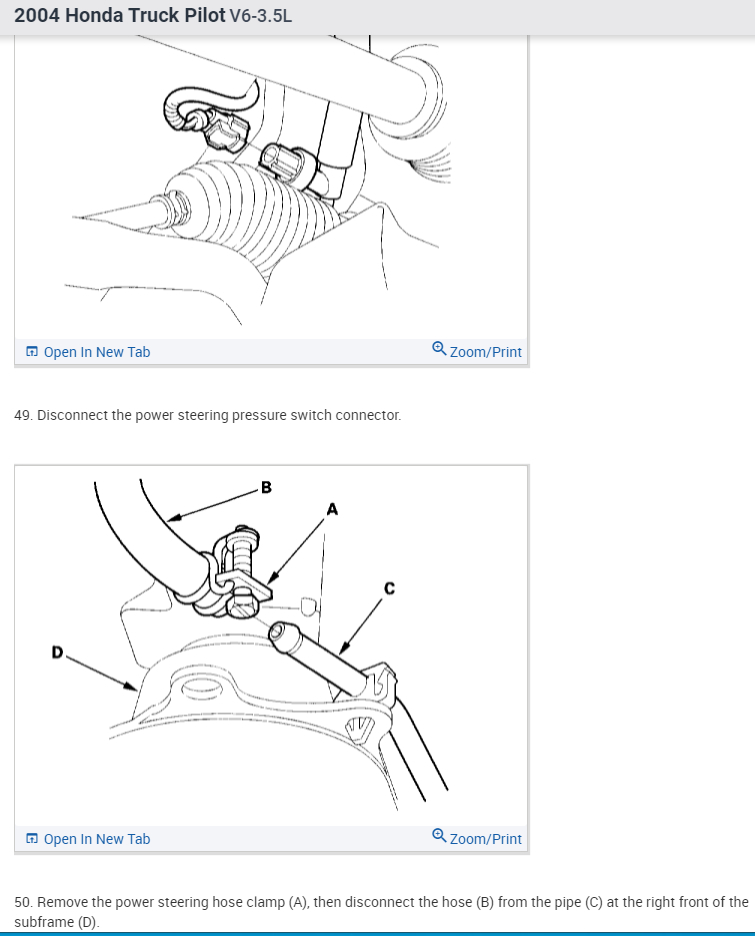

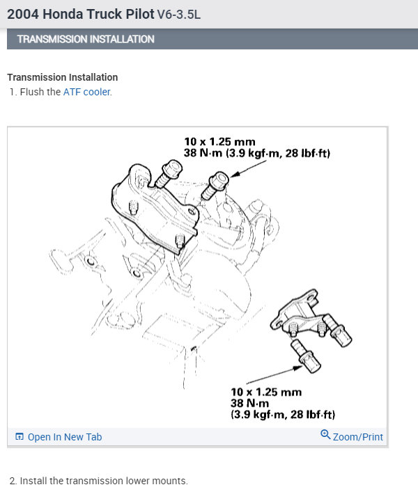

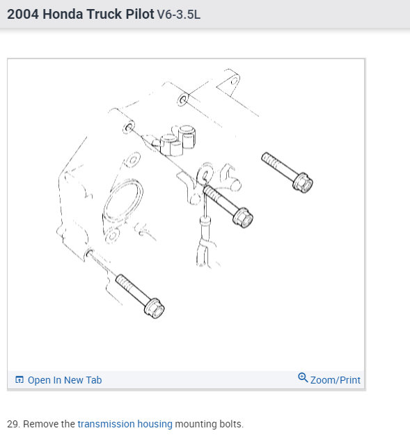

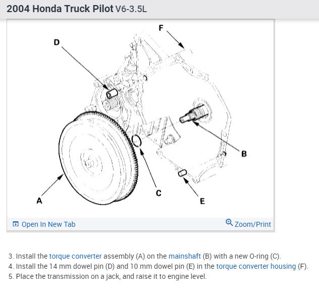

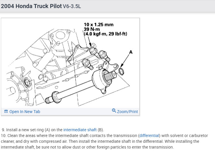

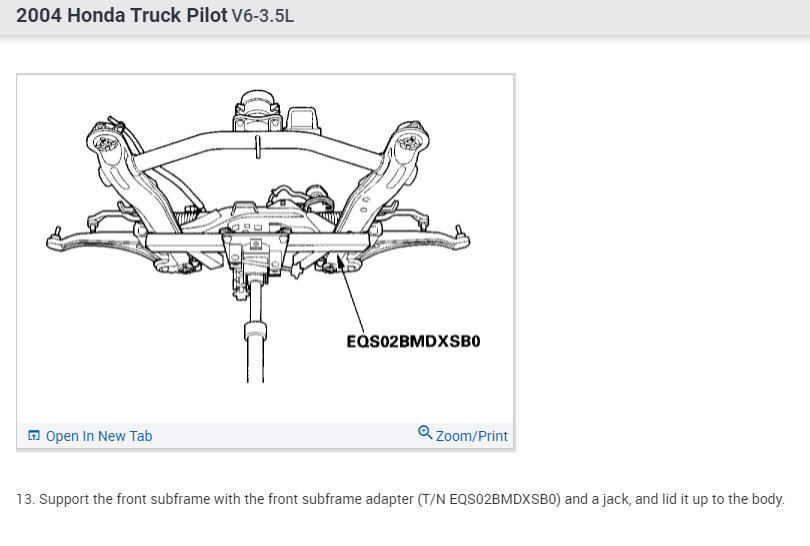

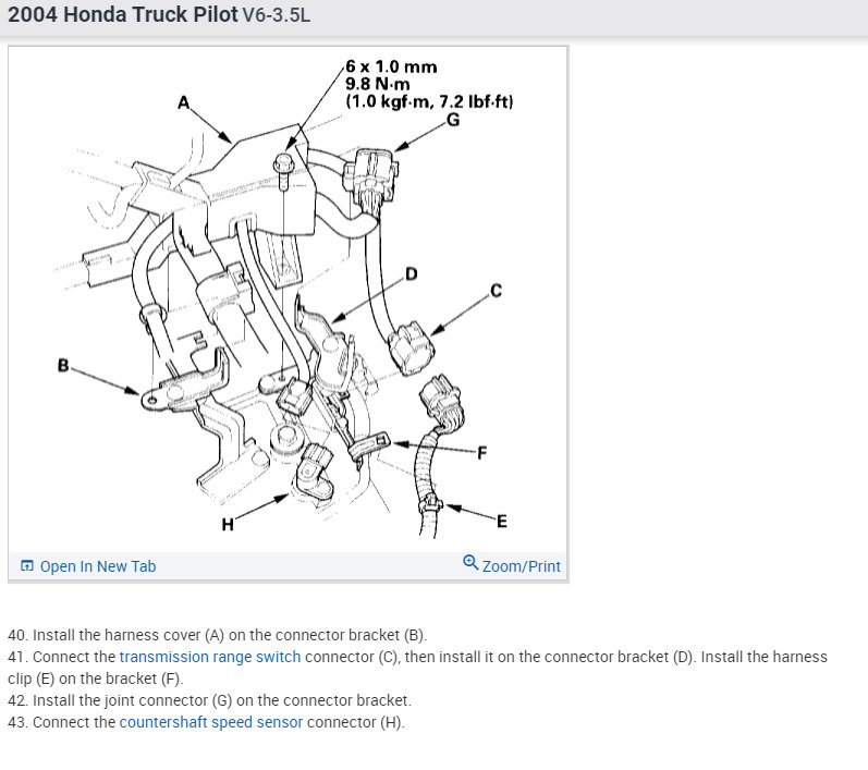

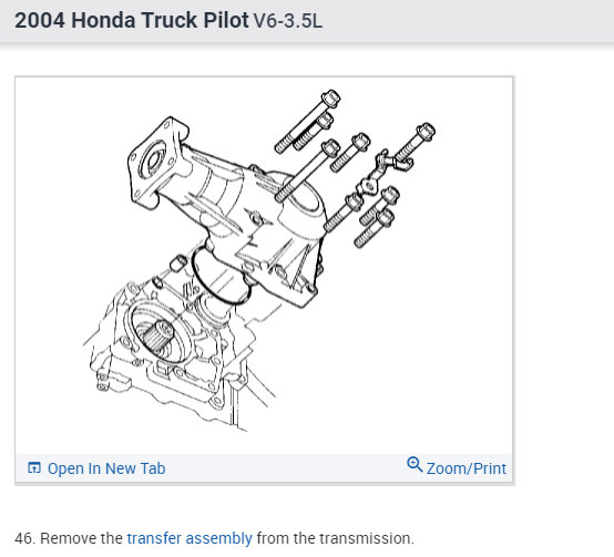

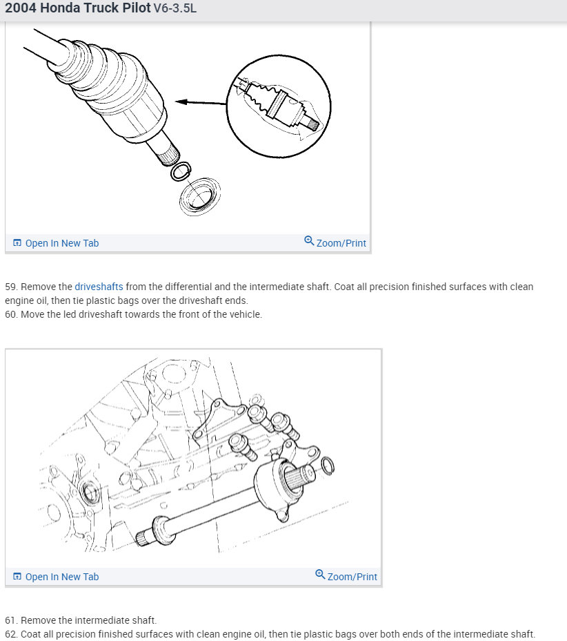

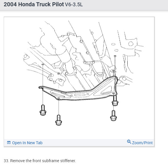

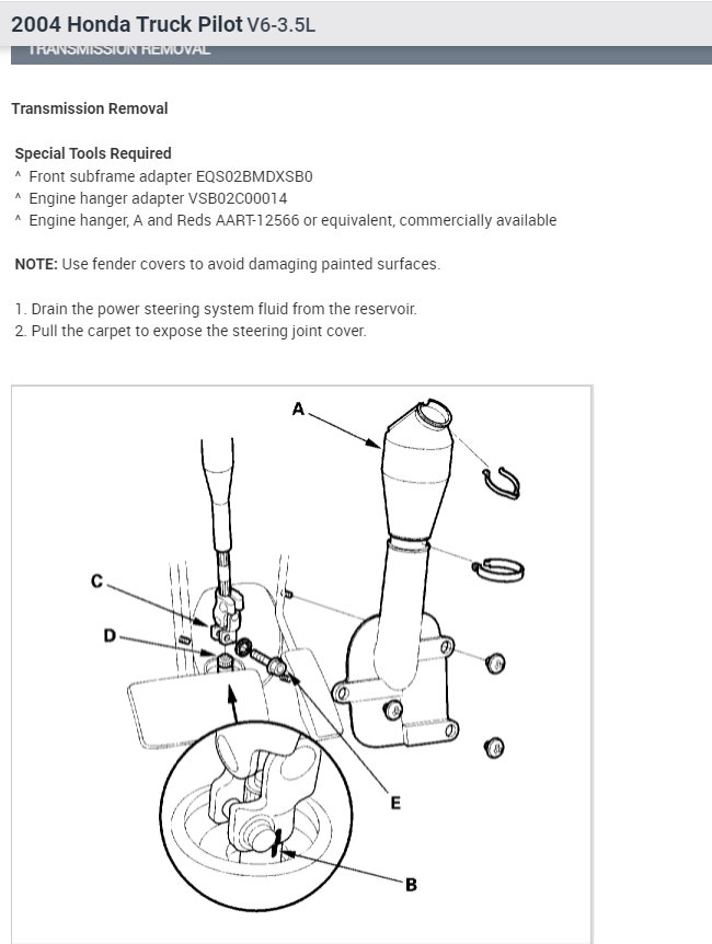

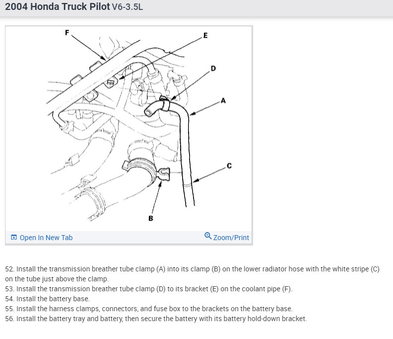

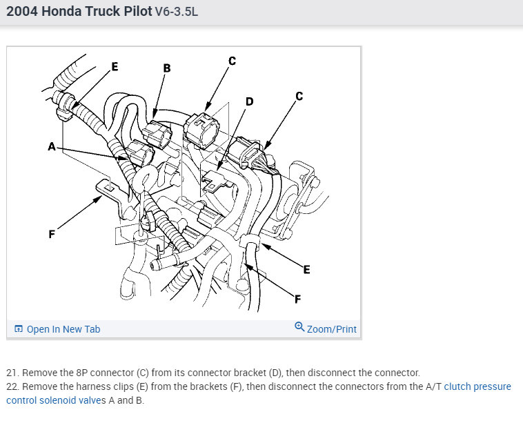

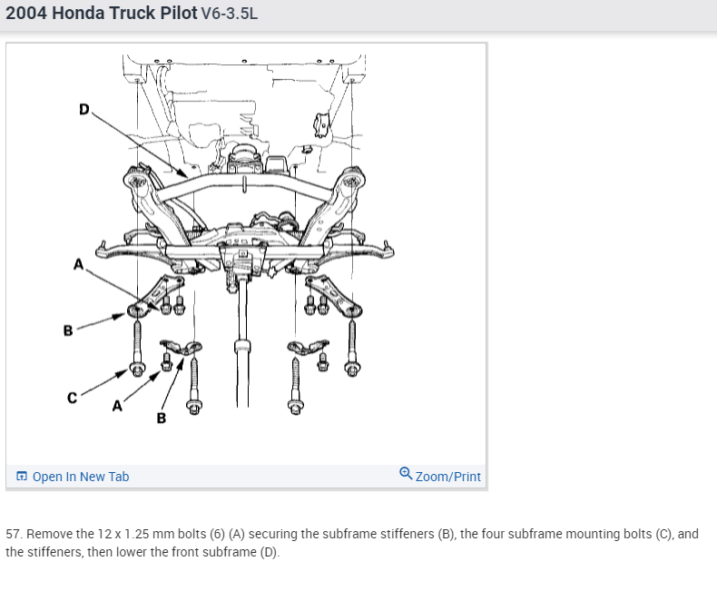

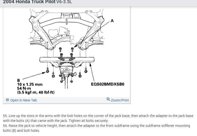

I can't afford the $7,000.00 cost of a transmission replacement. I found a YouTube video that is quite detailed on the replacement process. and I have purchased a transmission to replace the old one. Is there a site that can answer my questions if I run into some trouble or a manual on the replacement to use as a reference? The vehicle listed above is a 2004 not a 2002.
Oct 23, 2021 at 3:15 AM
SQM
  • 6,383 POSTS

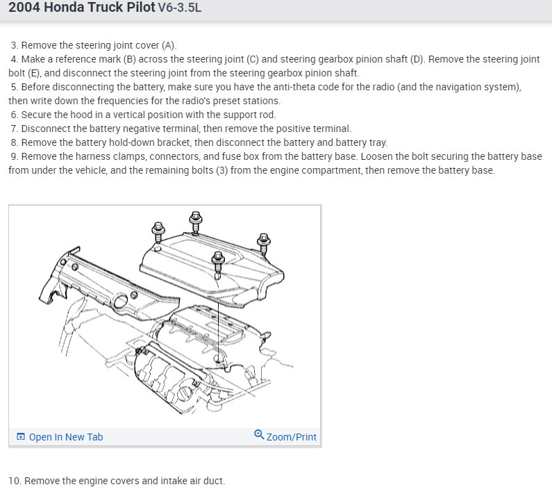

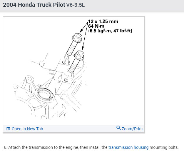

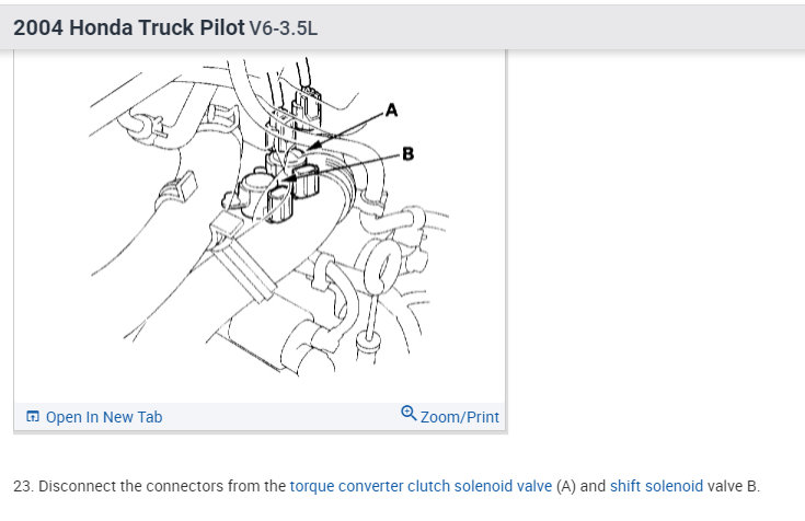

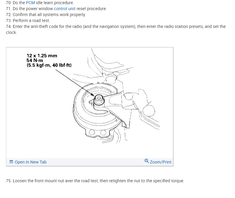

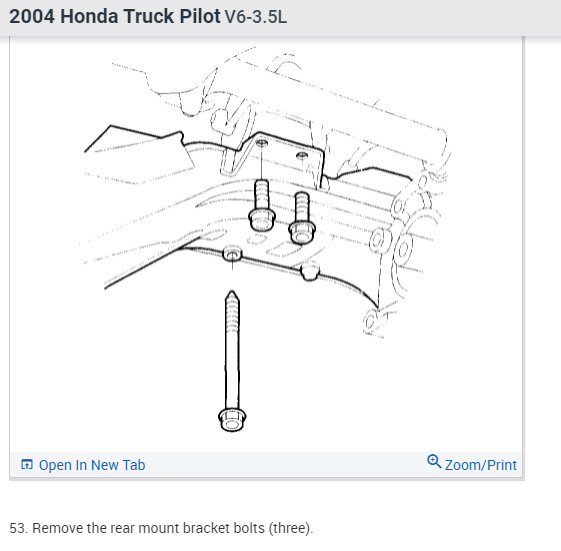

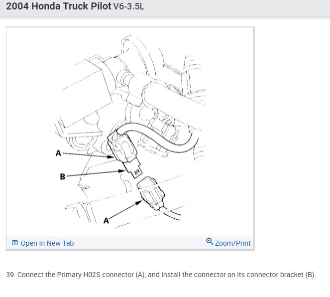

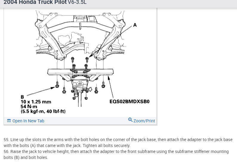

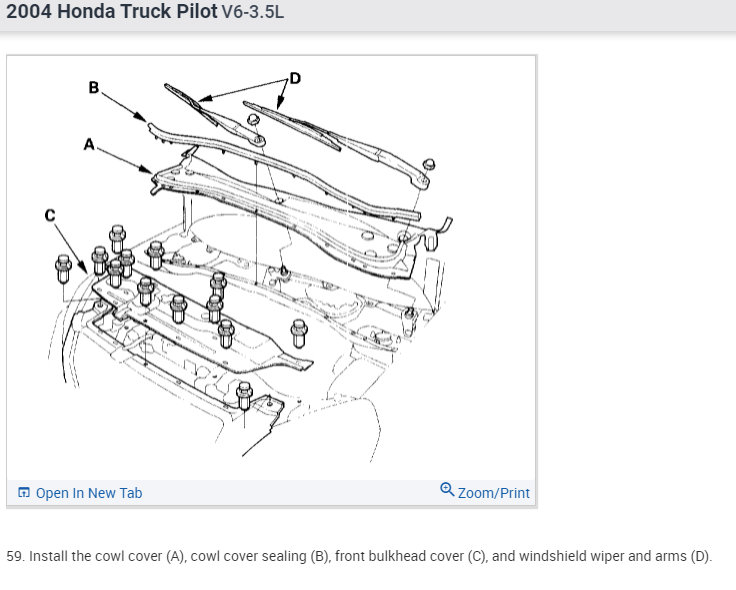

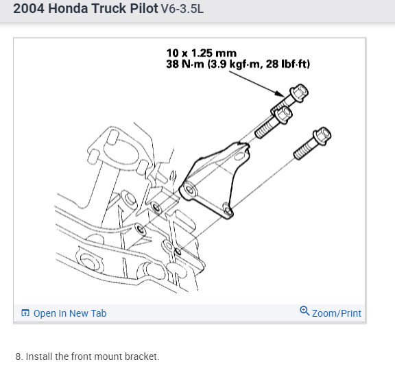

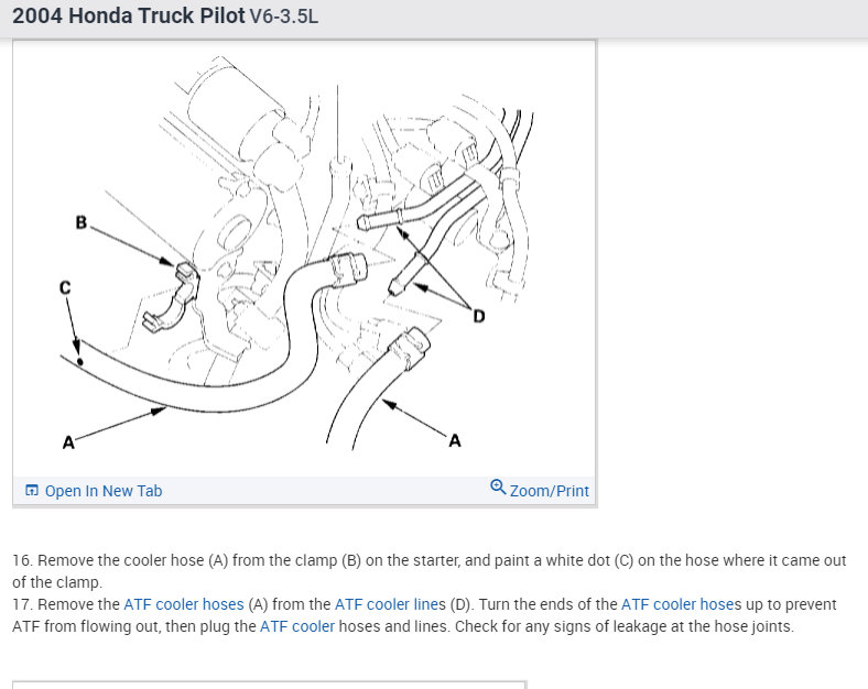

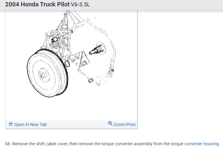

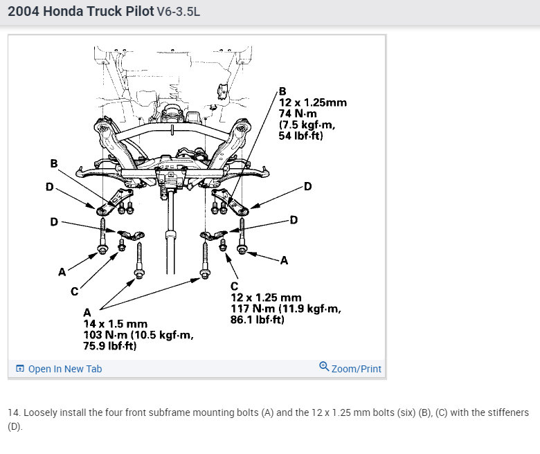

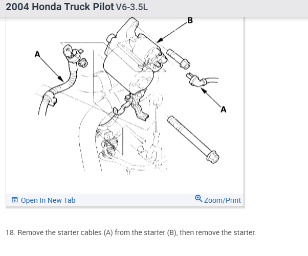

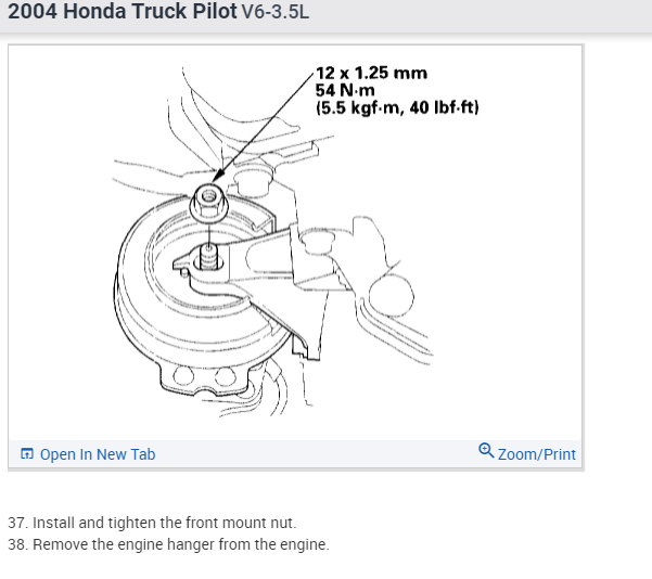

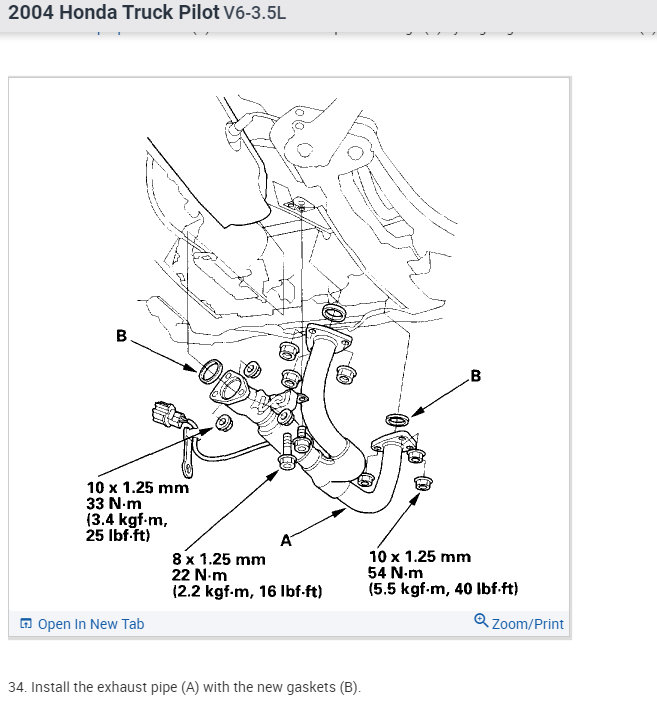

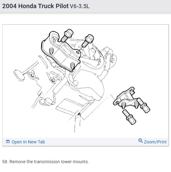

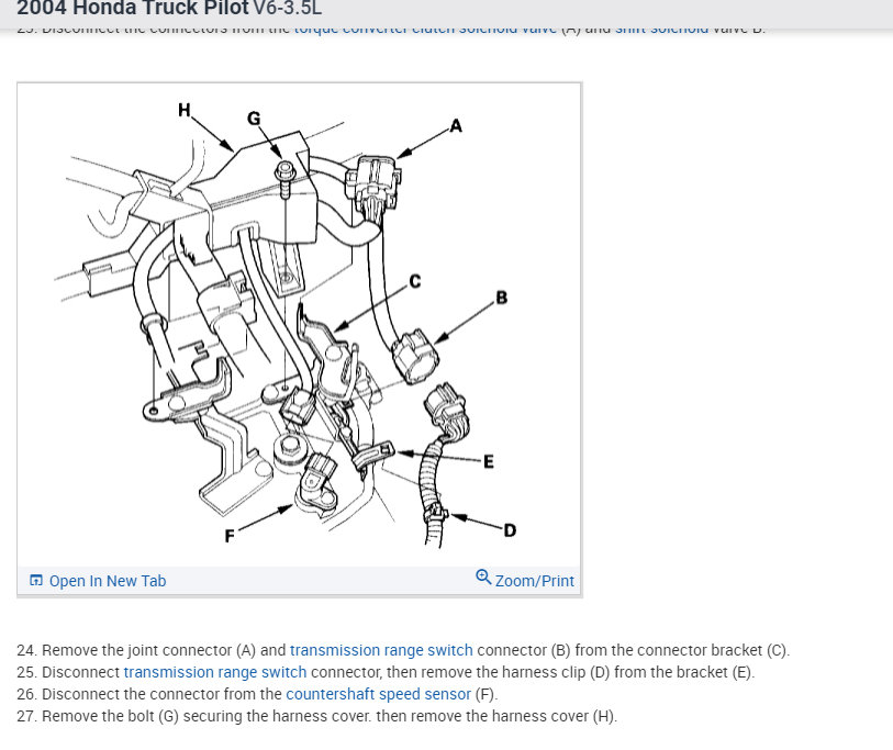

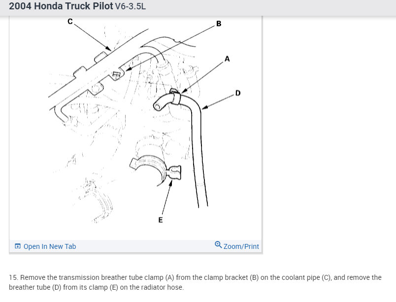

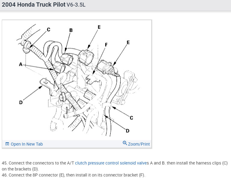

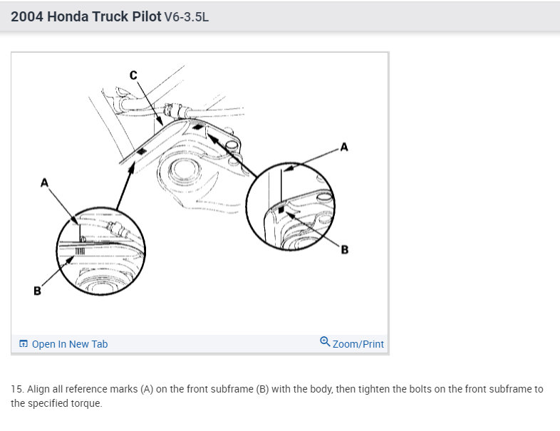

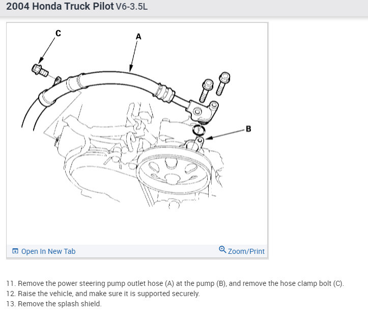

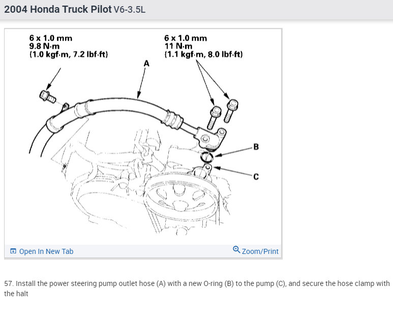

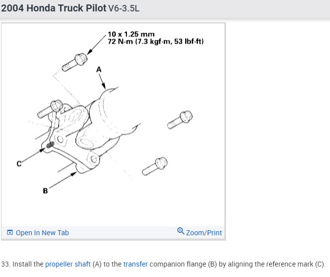

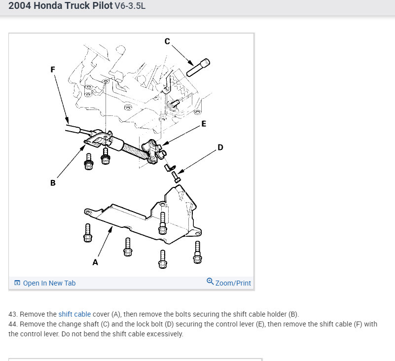

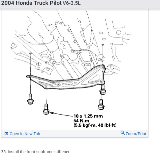

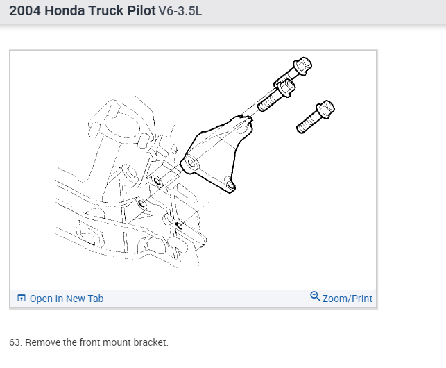

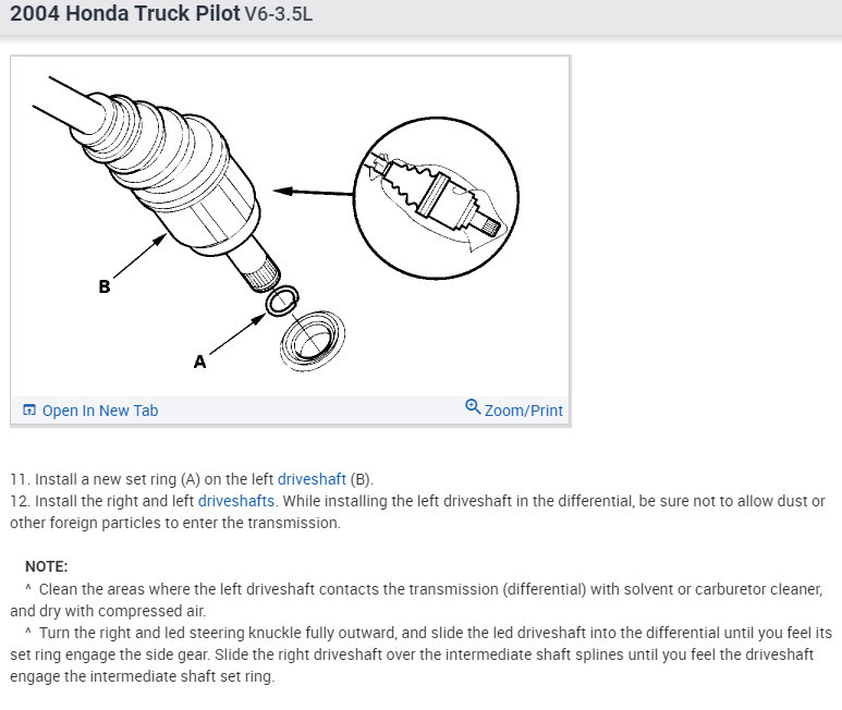

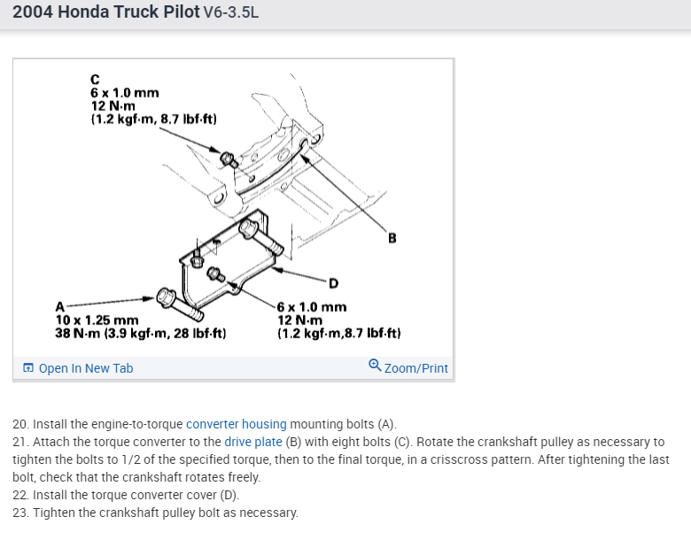

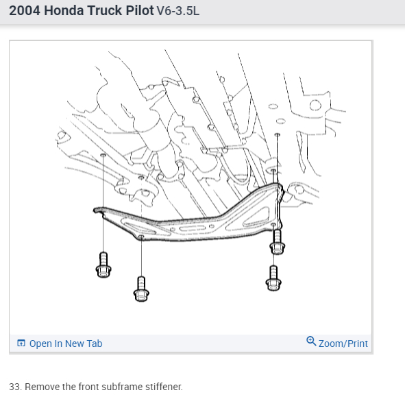

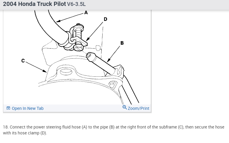

I have attached the step-by-step removal and installation for the transmission.
https://www.2carpros.com/articles/how-to-remove-an-automatic-transmission-rwd
