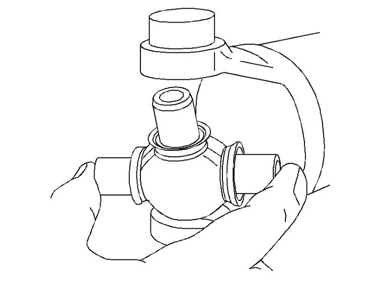

I would suspect the driveshaft universal joints maybe the noise if they are worn out and not lubricated.
https://www.2carpros.com/articles/how-u-joints-work
When they get tight or seized, they could make this noise. I would get them checked to be sure that they do not fail and leave you stranded.

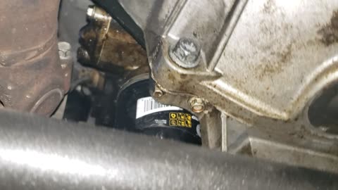

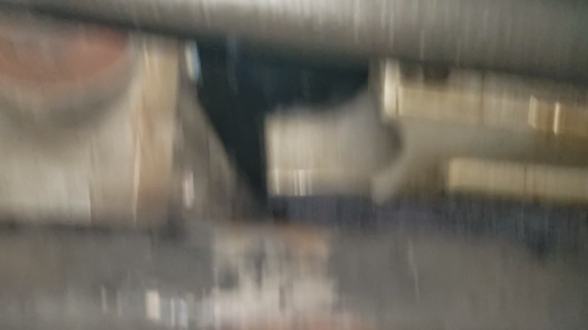

This is the transmission pil I was talking about.
Monday, June 8th, 2020 AT 7:11 PM

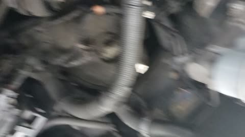

MTCM34
  • 9 POSTS
This is the oil I was talking about.
Monday, June 8th, 2020 AT 7:12 PM

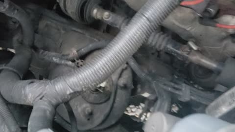

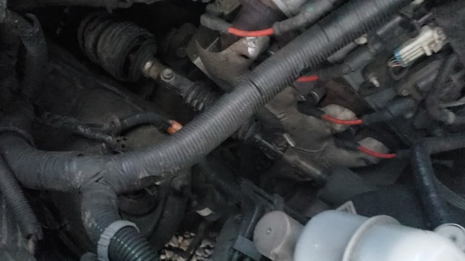

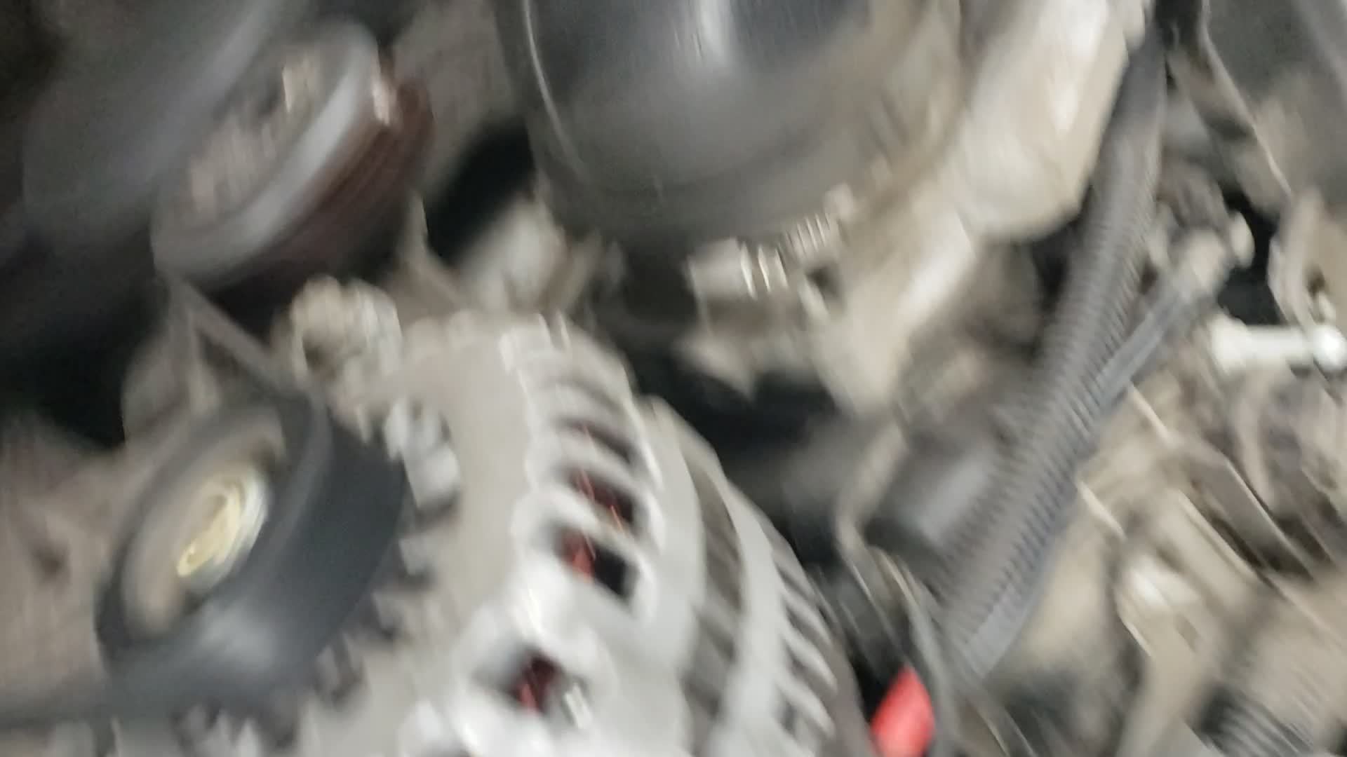

  • 52,797 POSTS
The oil leak is on the driver's side by the oil filter. Look up and see if it is coming down from the top.
Go to the top of the motor and see if you can see if it is leaking from the valve cover.
Tuesday, June 9th, 2020 AT 2:19 AM
MTCM34
  • 9 POSTS
Not from anywhere I can see.
Tuesday, June 9th, 2020 AT 5:50 AM
  • 52,797 POSTS
You will need to clean off the motor both top and bottom of all oil.
Then get an oil dye at a parts store and add it to the oil.
Run the car a few days and then check for the leak. Use a bright LED light to find the source of the leak.
