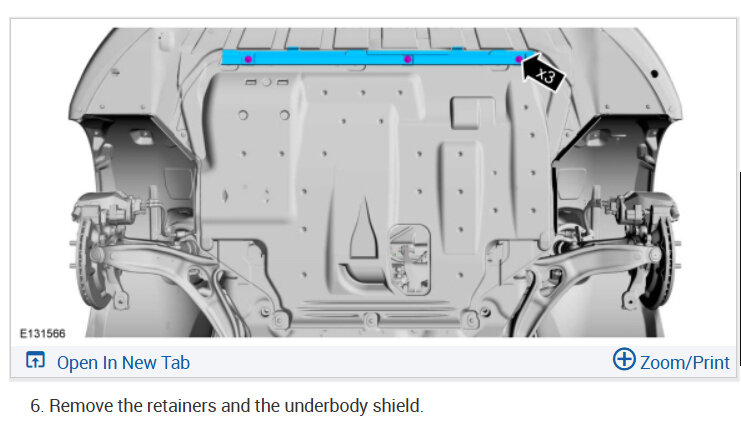

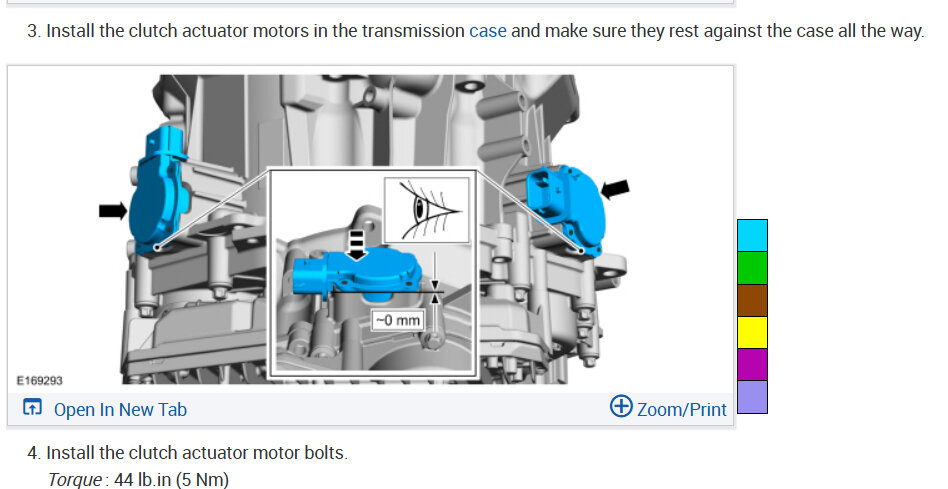

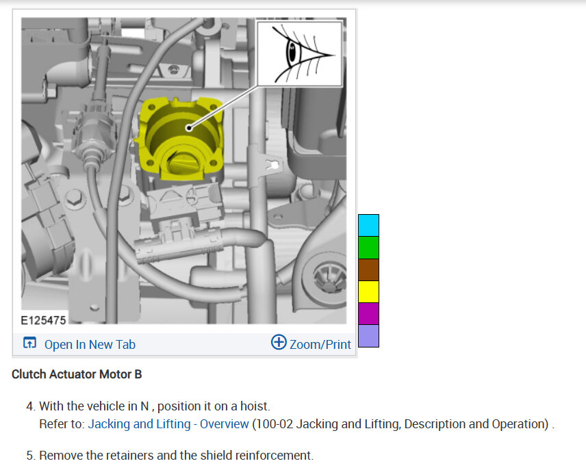

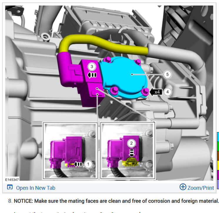

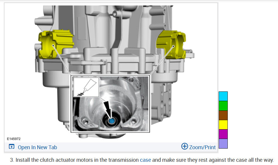

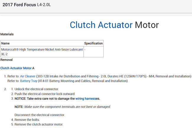

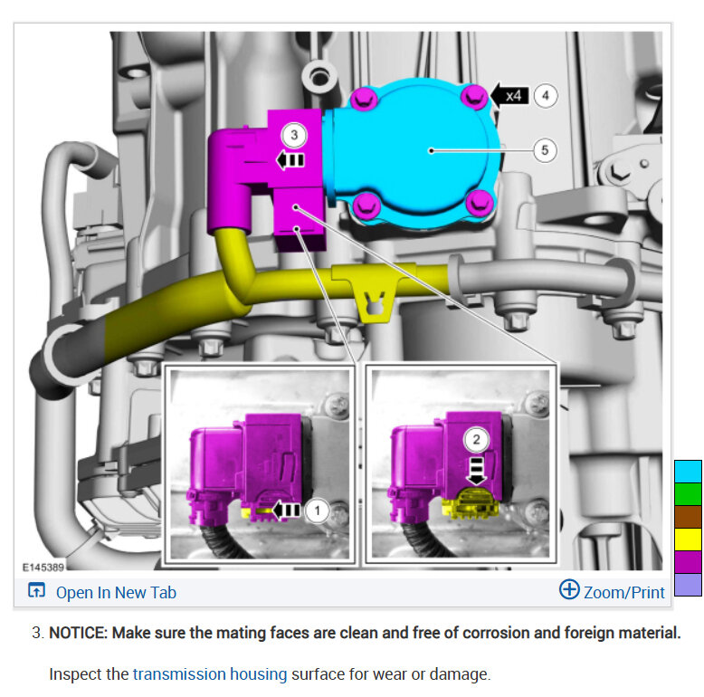

Code P07A5 and P07A05-00 Transmission Friction Element B stuck on. Is the repair only to replace the clutch actuator or are additional repairs needed? Approximate cost and time of repairs. Thank you.
Nov 6, 2024 at 8:10 PM
  • 55,721 POSTS

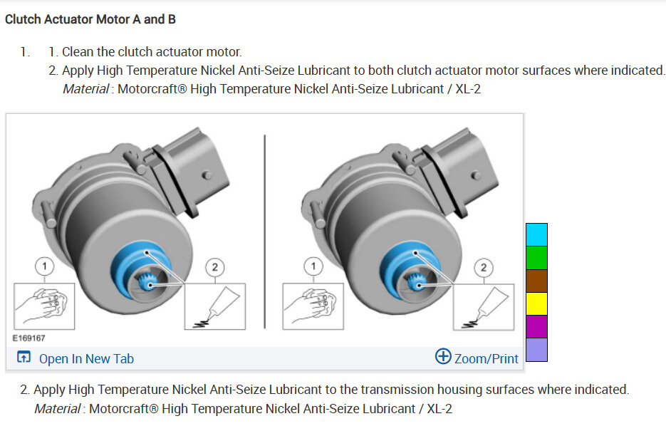

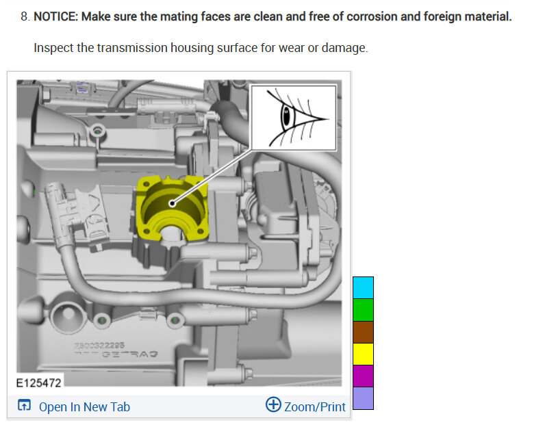

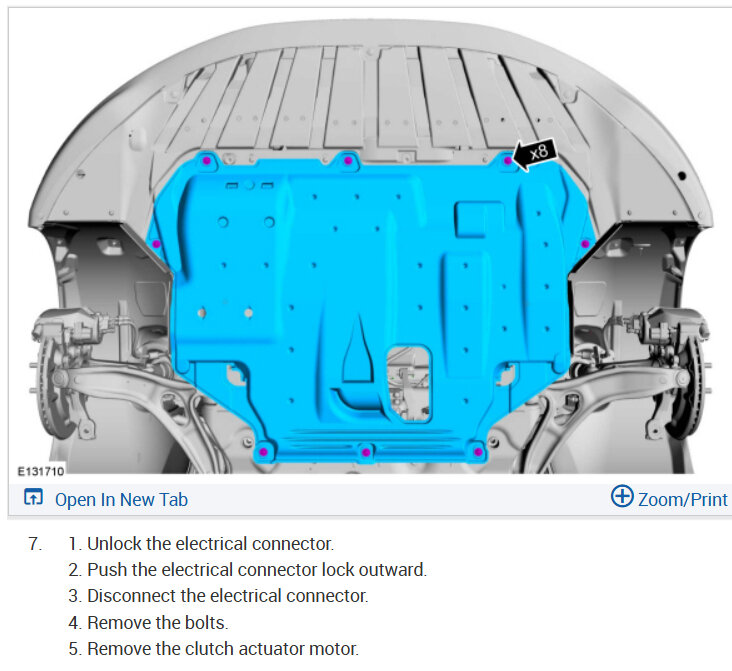

Sometimes the clutch itself falls apart which the transmission will need to be removed for, but I can tell you they had problem with the clutch actuators on these cars. I would replace both, here is how. Once completed clear the codes and take the car for a drive to see what happens.
