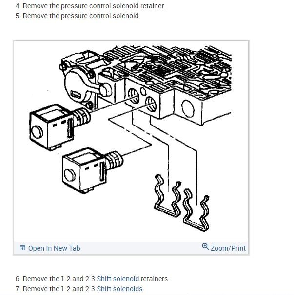

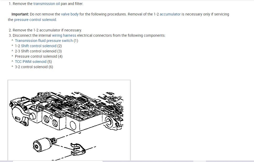

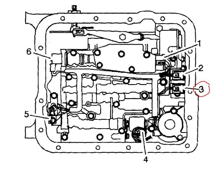

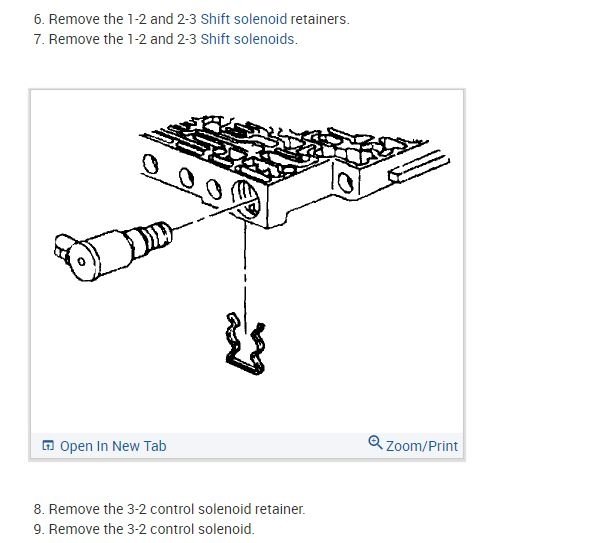

When I go from 2nd into 3rd gear my RPMs rev really high and the truck does not shift into gear. I have to let off the gas and wait for it to fall back before I can press on the gas and it go into gear. This is the only gear it does it to.
Mar 31, 2021 at 12:01 AM
Good morning,
This could be the 2-3 shift solenoid not working correctly. You will need to drop the pan and filter to access the solenoid.
I attached the procedure and pictures for you below. When one of these solenoids fails, they usually set a code with a check engine light.
