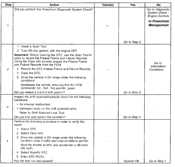

Code po751, transmission not shifting properly?
269,400 MILES • 5.3L • V8 • 4WD • AUTOMATIC
BLESSING4334

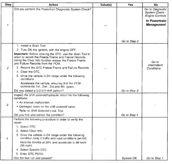

not shifting very good into overdrive. it pulled code po751. what do i need to do to fix this?
Dec 2, 2022 at 1:08 PM
  • 110,248 POSTS

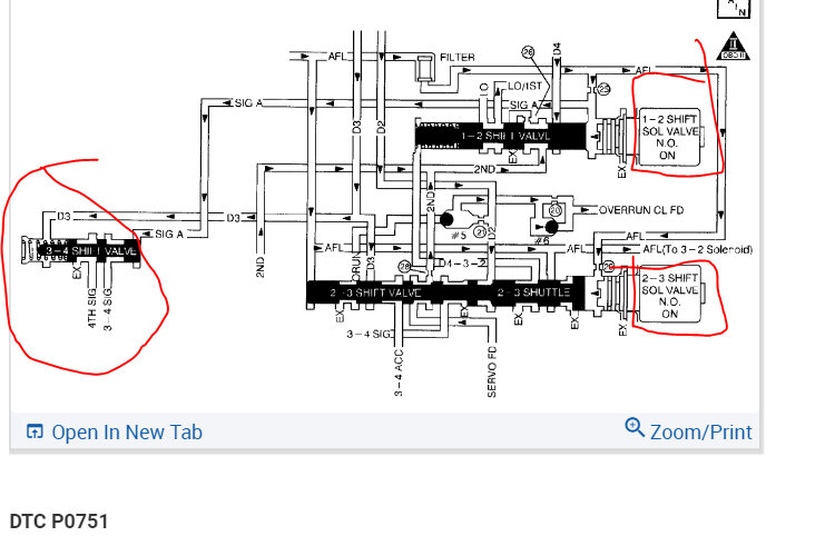

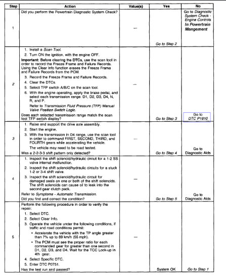

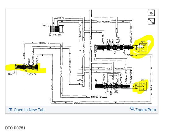

There are two different transmissions available on this vehicle. Do you know which you have?
4L60-E / 4L65-E Automatic Transmission
4L80-E / 4L85-E Automatic Transmission
Also, is this the only code set? The issue is similar for both transmissions, but there are different basic tests. If you look below, pic 1 is the diagnostics for the 4L60 and pic 2 is for the 4L80.
Let me know if there are other codes. Also, let me know if the fluid is both clean and full.
