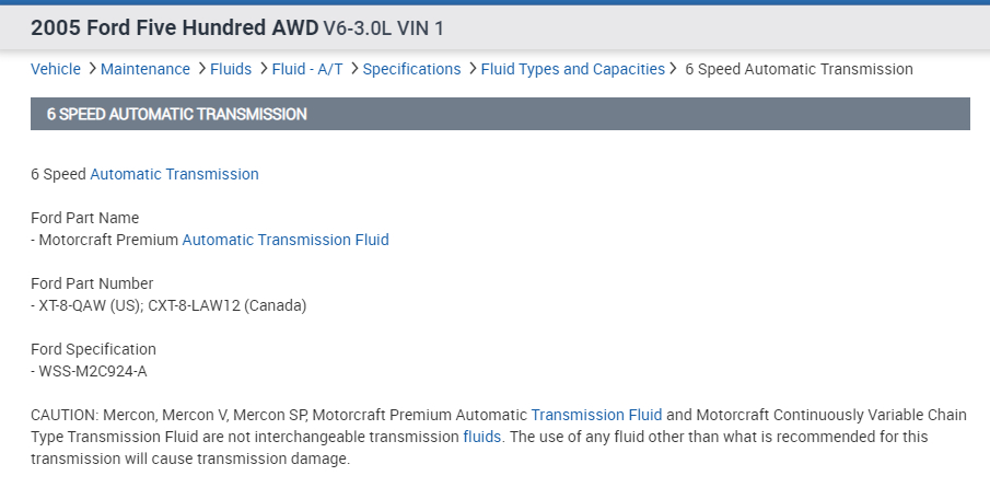

What are the three fluids I need for my rear end, ptu and haldex oil change?
2005 FORD FIVE HUNDRED
154,000 MILES • 3.7L • 6 CYL • 4WD
JONNYDIRT2

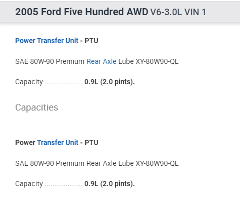

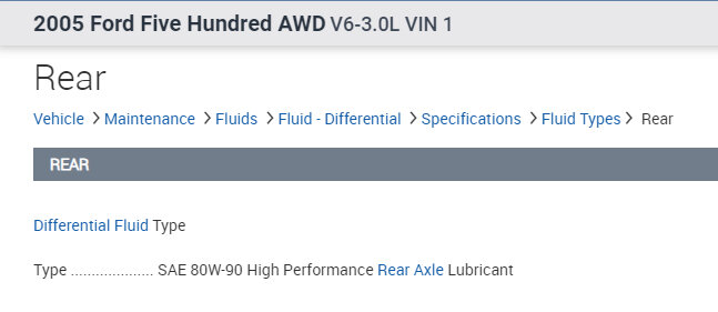

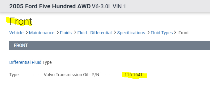

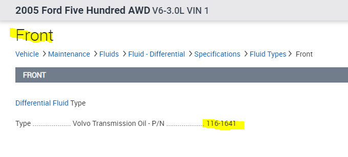

What are the three fluids i need for my rear end, ptu and haldex oil change.
Oct 15, 2023 at 2:25 AM
  • 110,244 POSTS

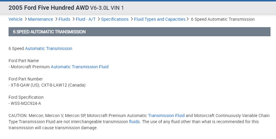

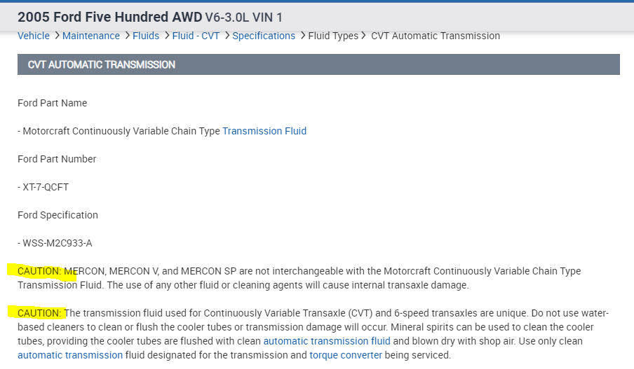

I attached the information available to me regarding your request. I need to point out that there are two different transmissions that were used. One is a 6-speed automatic and the other is a CVT (continuously variable transmission). Make sure you get the correct fluid.
Take a look at the pics below and let me know if it helps.
See pics below. Note: In some of the pics, a part number only is provided.
