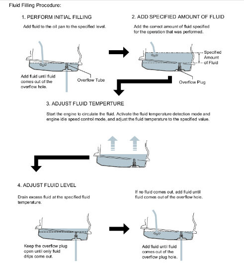

All of the codes are related to the transmission pressure control system. When you drive the vehicle, have you ever noticed a slipping when it shifts?
Also, is the transmission fluid clean and full?
Let me know. Also, let me know if the vehicle only has 12,000 miles.

I meant 120,000. The transmission oil is dark brown, but I doubt if it is full. I added a total of 7 liters of oil.

Yes, the car slips.

If the transmission was dry, totally empty of fluid, it only holds 6.5 liters. You must have it overfull.
Take a look at the directions below. Let me know if that is how you checked level. Also, let me know what type of transmission fluid was used.
See pic below.
