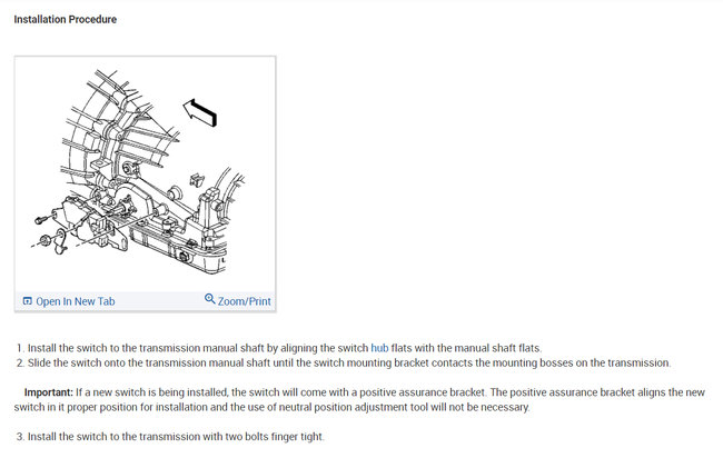

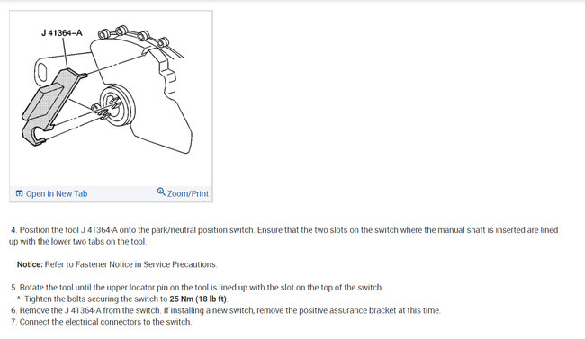

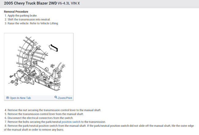

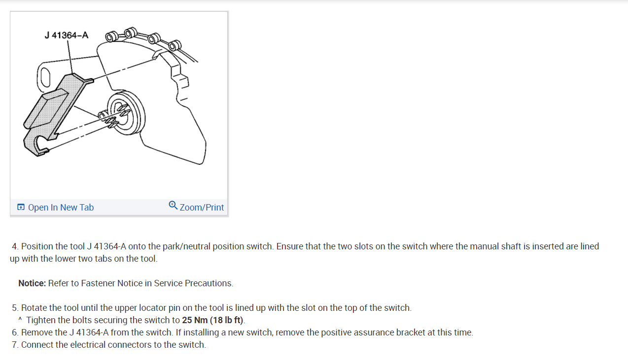

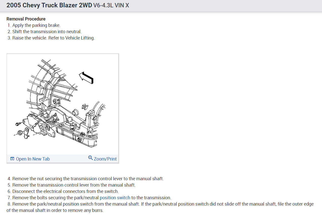

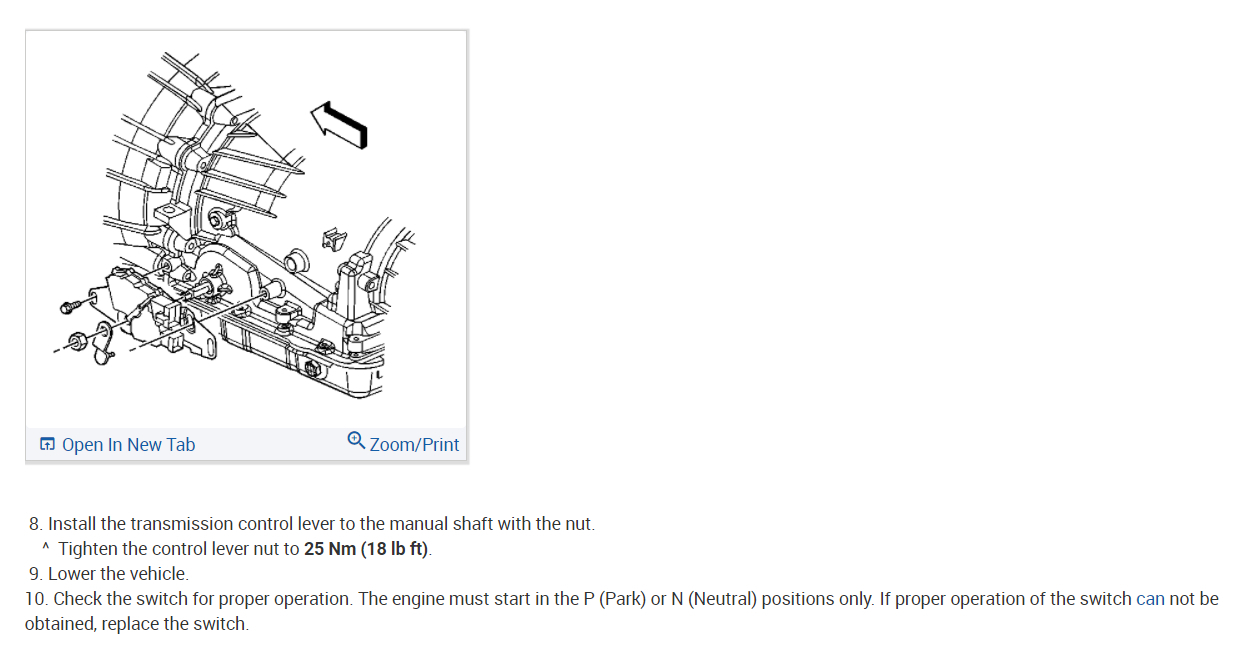

Truck shift to all gears, but doesn't move in reverse.
Sep 20, 2022 at 7:37 AM
  • 55,628 POSTS
When you put the transmission in reverse does the indicator light up? If not, the gear range sensor has gone bad. Here is how to replace it. Also, I have included a guide that may help as well.
