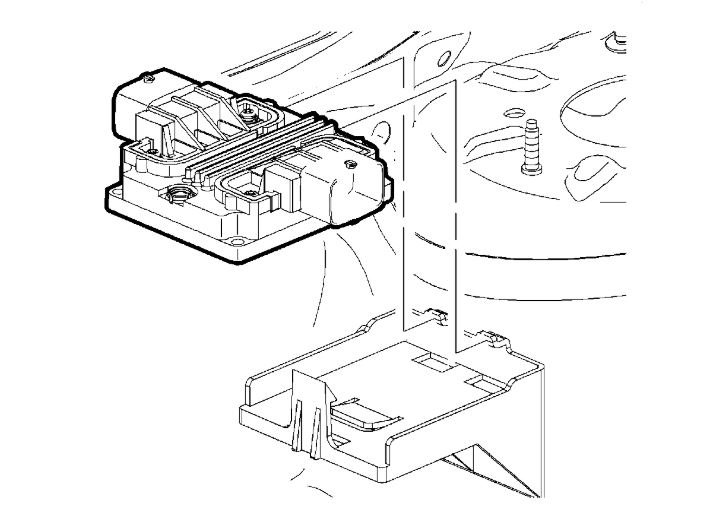

After stopping and then going, the revs go up and it is slow to go for three seconds or so and then kicks in. When this happens the DRNL2L1 light indicators do not light up as well as the automatic locks do not work when turning off vehicle. Last night I went out and it was fine.

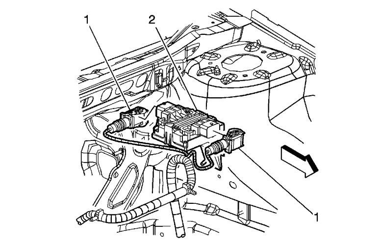

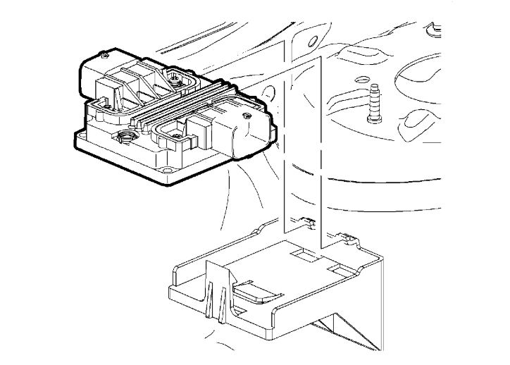

U0073 control bus off and P0700.
Oct 7, 2018 at 10:42 AM
Okay, the 73 code is a serial data line code. In other words, there is no communication between modules. It looks like the issue is with the transmission control module. It could be just a connector needing to be cleaned or it may be the module itself.
The 700 code is a general code for a transmission fault. There is usually another code along with this code.
