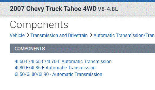

At this point, let me know as much as you can so I know which direction to go. Also, I need to know if the engine size and transmission (see pic 1). It appears there are several different transmissions that may have been used. Let me know if it is 4wd also.
If you haven't already, I recommend having the computer scanned to see if there are any diagnostic trouble codes that can point us in the right direction. Most parts stores will do it for free.
See pic below.
