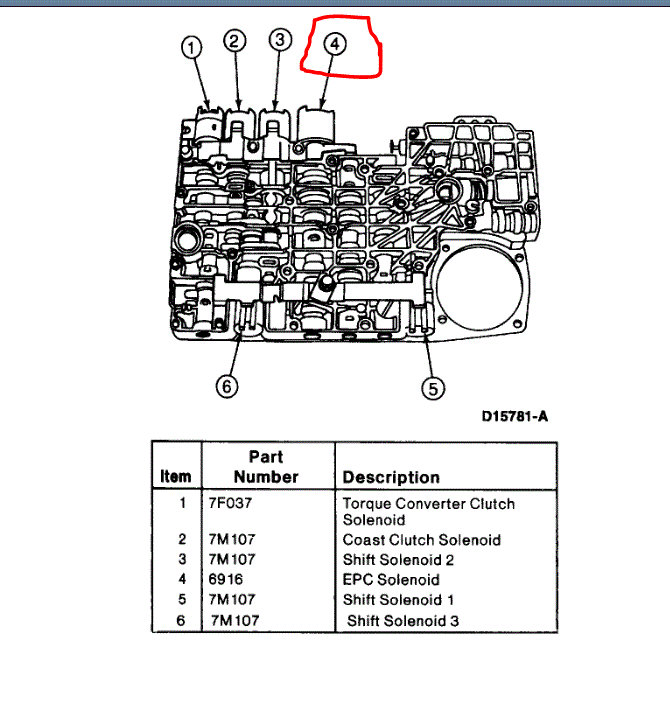

I drove it to work one day came back home ran perfect.
next morning started find then the overdrive light started blinking. I put the truck in gear no power forward and back no power.
code p1747 I checked the wiring looks good .
has anybody had this problem?

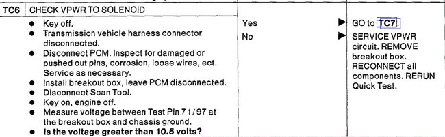

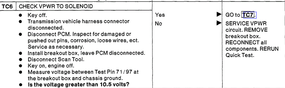

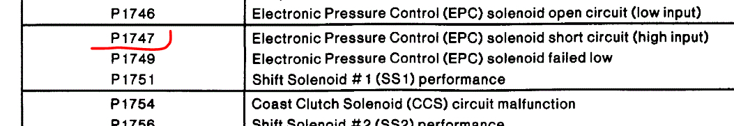

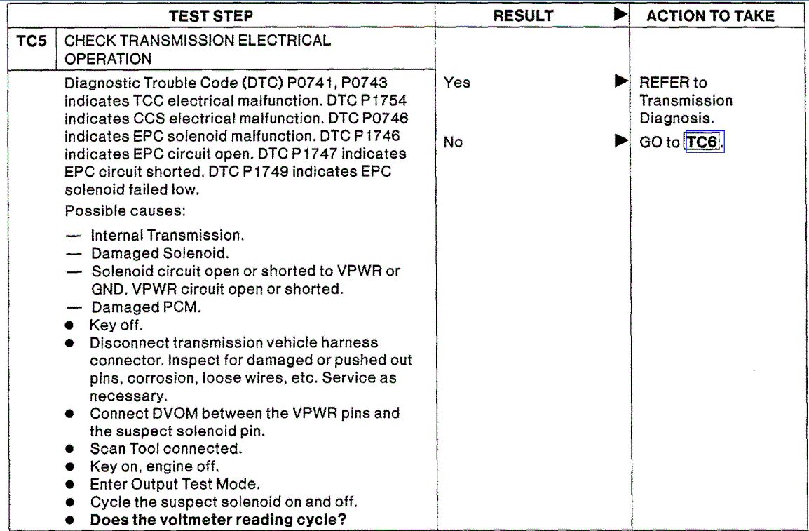

At some point there is a short to the electronic pressure control solenoid. It is located on the valve body in the transmission. Based on the code, I suspect there is a short to power (12v).
If you look at pic 1, it defines the code. Pic 2 and 3 are the start of the diagnostics for repair. I don't know if you are comfortable with the procedure, so let me know. The last pic shows the solenoid I am referring to.
If you feel comfortable testing, here are a few links you may find helpful.
