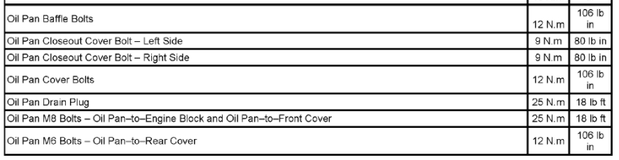

Okay, also is there any way you could show me the tightening sequence and the torque specifications for all the bolts?? I have done this two times already and for some odd reason every time I start tightening the pan up I end up cracking one side of it from either tightening it wrong or something.

Here is the torque specifications for the oil pan bolts on your GMC and I've attached below. Always start from the middle and circle your way outward. Hope this helps and thanks again for using 2CarPros.

GM doesn't have a specific pattern for them, once you have the rear bolts in place and torqued down you can use a simple X pattern to tighten them starting in the center and working out, the larger bolts are torqued to 18 ft lb. while the smaller ones are tightened to 106 inch pounds. Basically it's just enough to squeeze the gasket tight. To crack the pan you are going way over the torque spec.
