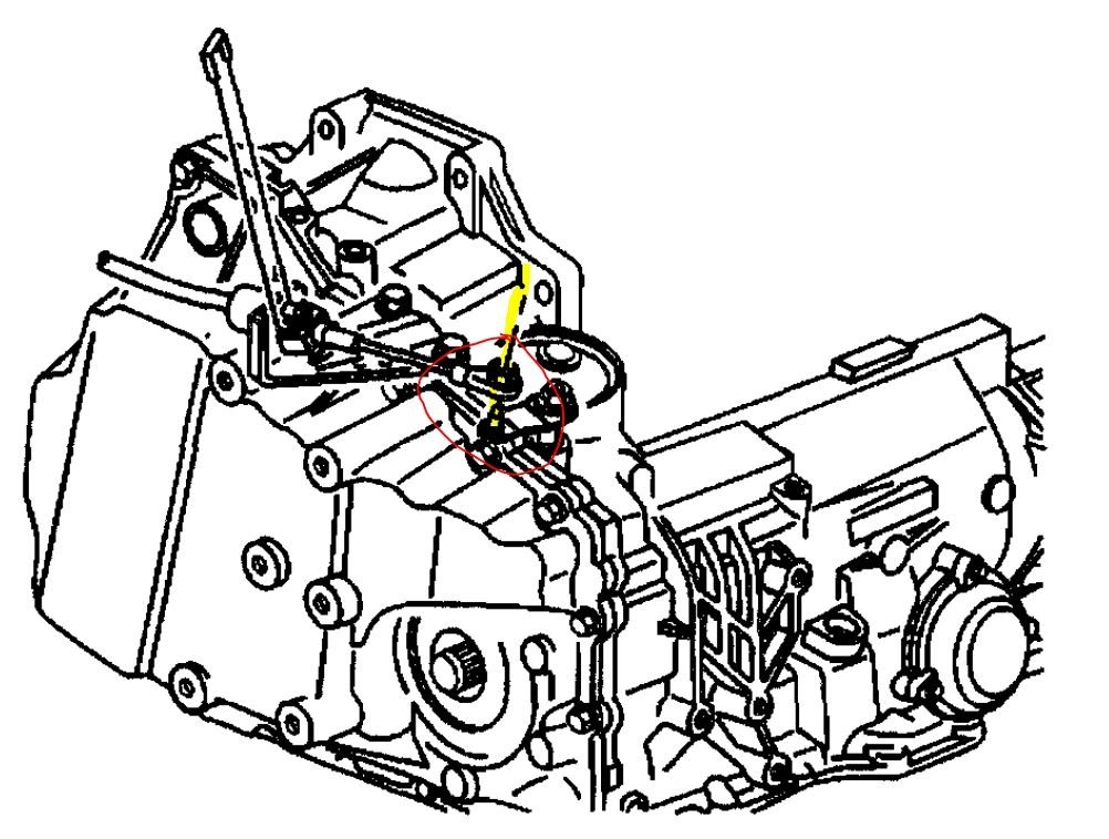

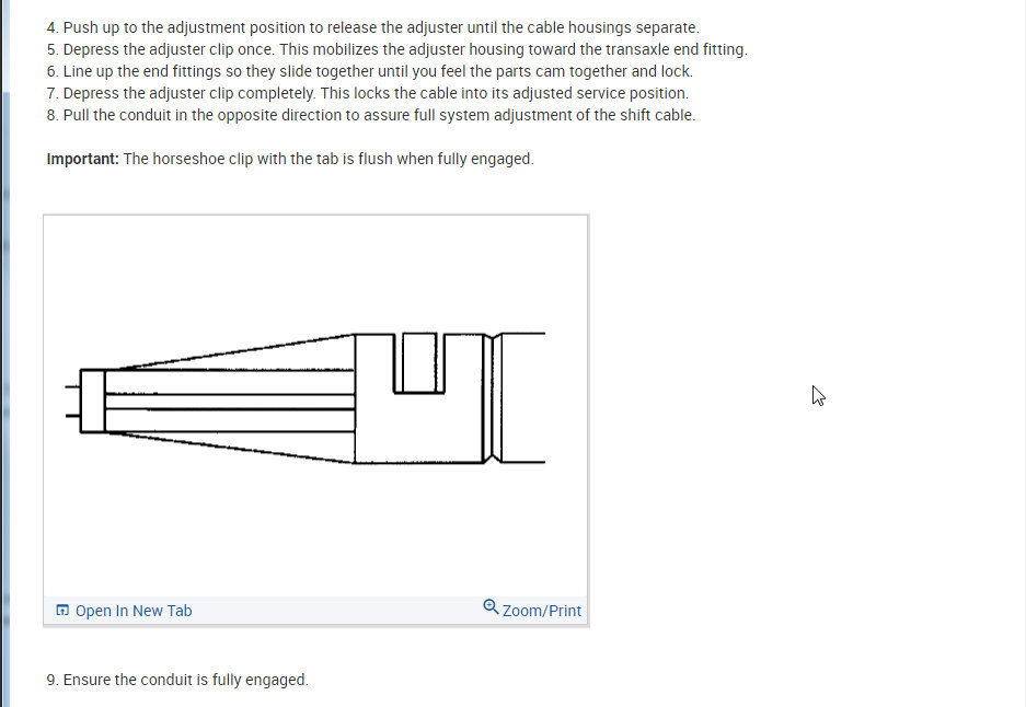

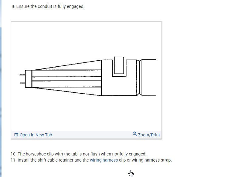

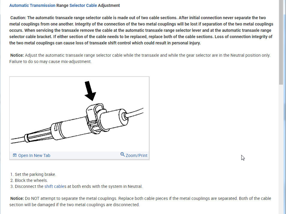

Any time we have a new or emerging transmission issue we want to start with the fluid. I see you checked it but what was the condition of it? Also, have you checked the linkage to make sure it is connected and adjusted properly.
I attached below the process to adjust it. I would suggest starting with this and go from there. Let us know what you find with this but if this all checks out then a solenoid issue would make sense.

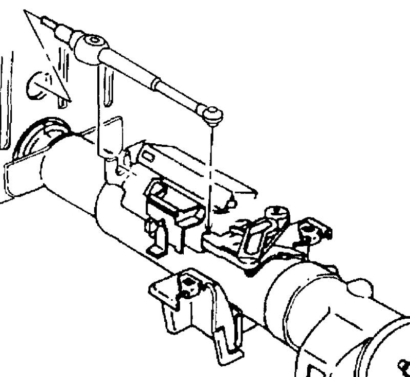

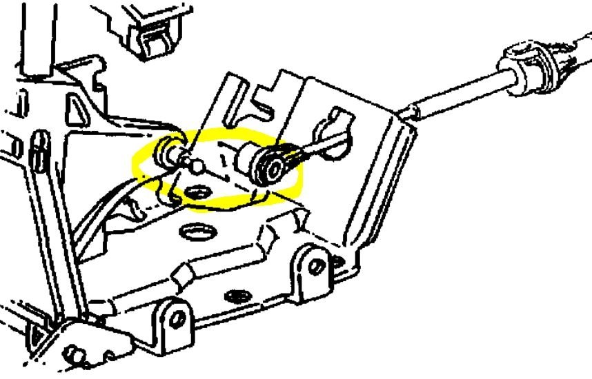

Okay, if you start the car and put it in gear does the engine sound change like the transmission is working or does it stay the same as if it was in park? How about if you shift into low, what does it do then? You say nothing moves in neutral? Is that all 4 tires or only the front drive tires you checked? Does the shift lever feel like it is moving the transmission selector itself. It's possible that the insert bushing in the shift cable failed or was damaged and the car isn't shifting out of park. Have someone watch the shift lever under the hood as you try to shift it inside the car. If it's not moving or the cable is off on either end then that is the issue.

Okay, so you move the lever and nothing, does the lever seem to move easier than normal or anything like that. Can you have someone watch the lever on the transaxle while you shift it to make sure it's actually moving? as I said earlier, the cables on them have inserts that fail or pop off on the studs that they just snap on. Those are on both ends.
