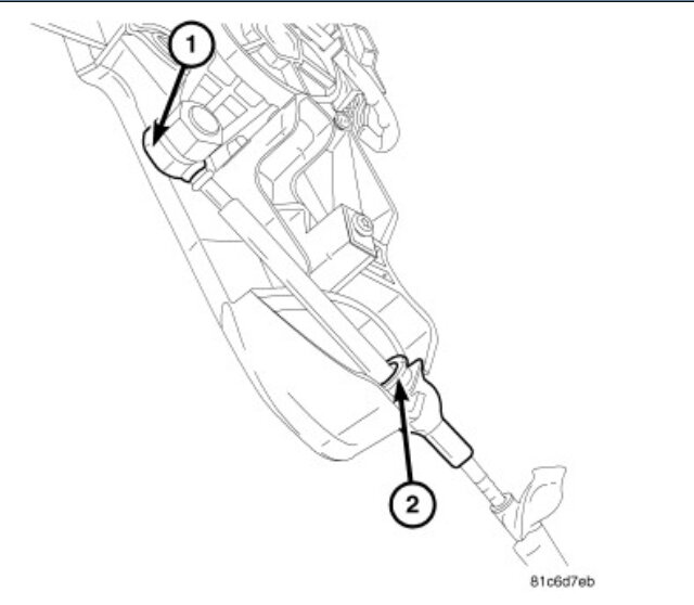

I have a few questions. First, is the fluid clean and full? Next, you indicated you can't push the vehicle. It sounds like the linkage isn't working for anything other than drive. Have you checked the shift cable for damage resulting from the accident? The cable is mounted to the side of the transmission to the manual transmission lever. (Pic 1)
Next, when you shift through the gears, does the gear indicator show the correct gear?
See pic below.

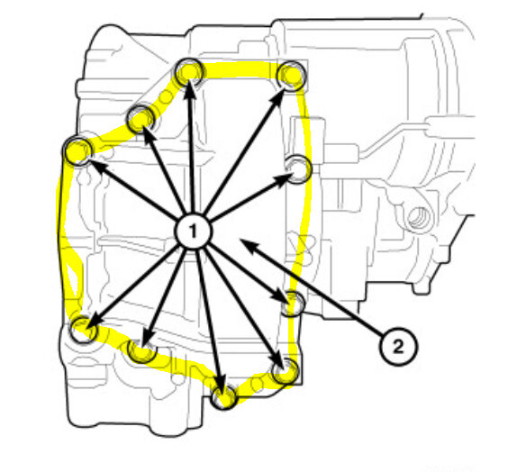

It shouldn't require a full overhaul if this is the issue. The first thing I would do is remove the differential cover and inspect the bearings and components. I attached a pic below showing the pan.
Nov 8, 2022 at 10:36 AM
BLOBLOGIC
  • 9 POSTS
Is the differential cover considered the pan?
Nov 9, 2022 at 12:18 AM
  • 110,251 POSTS
No, the pan is what is removed to drain fluid.

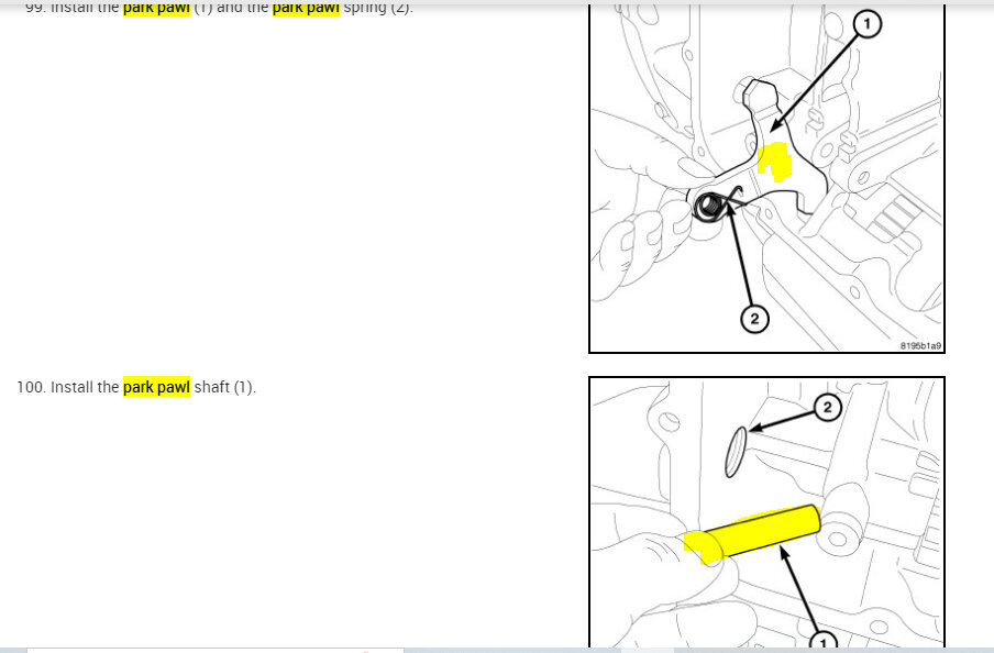

A parking pawl. That makes sense. I didn't realize it was in park when it was in the accident. I attached a pic below of the part. It is nothing more than a steel shaft.
When you said the transmission felt like it was placing a load on the engine but not moving, I had a feeling it was something like this. I didn't suspect this part because I assumed it was being driven when it was in the accident. Maybe the vehicle was hit when it was parked.
If you have a chance, let me know how things turn out for you. I'm interested in knowing.
See pic below.
