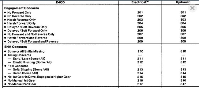

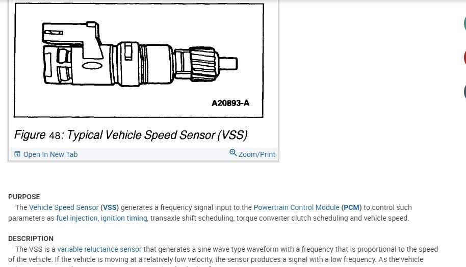

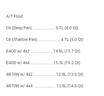

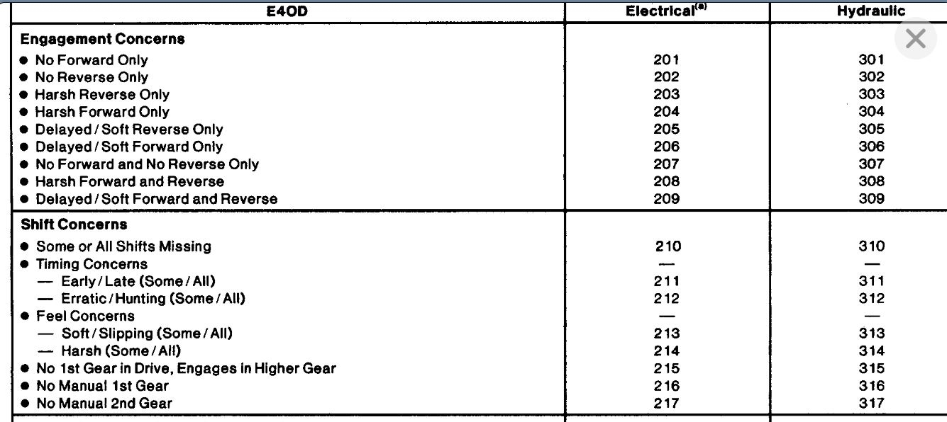

Transmission intermittently disengages at highway speed then drops back in with a bang. Speedometer also jumps over 40 mph. Related?
Feb 6, 2020 at 6:33 PM
Experienced Mechanic
52,796 POSTS
Good morning,

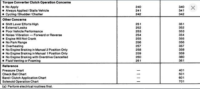

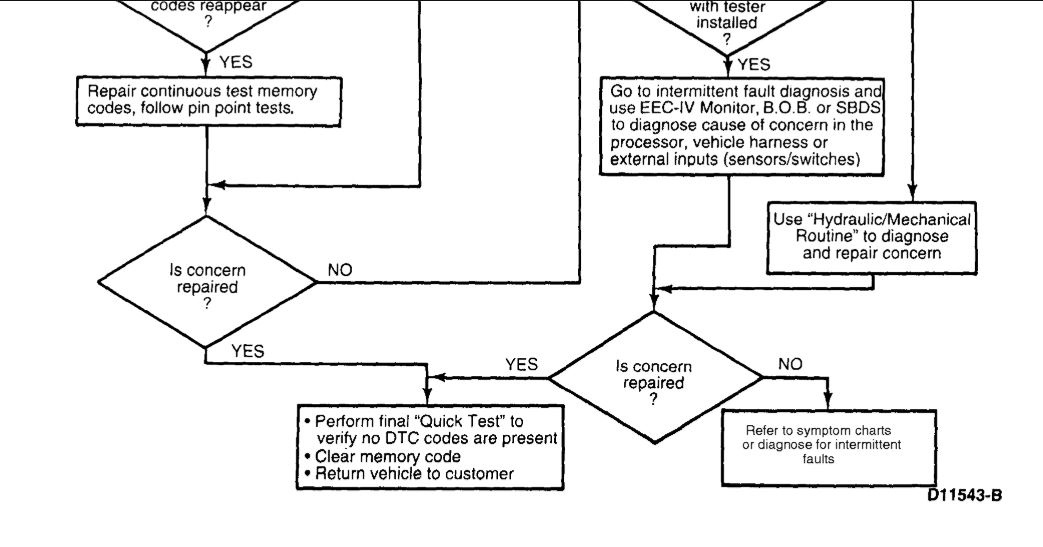

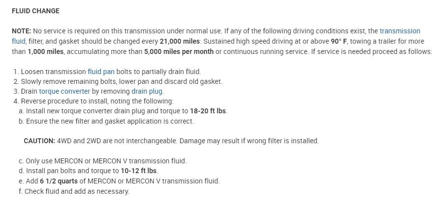

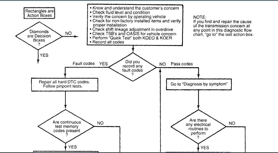

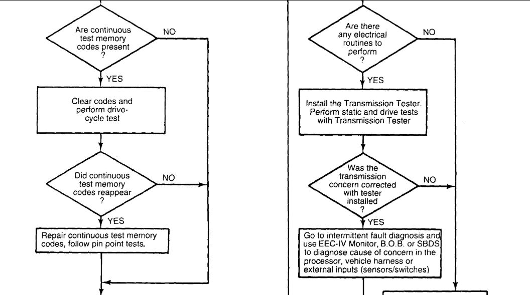

Did you check the fluid? A low fluid level or a clogged filter would cause this issue. I would start by changing the fluid and the filter.
Are there any codes set?
Hopefully changing the fluid and filter will resolve the issue. This transmission did not have a good reputation. It had a high failure rate.
