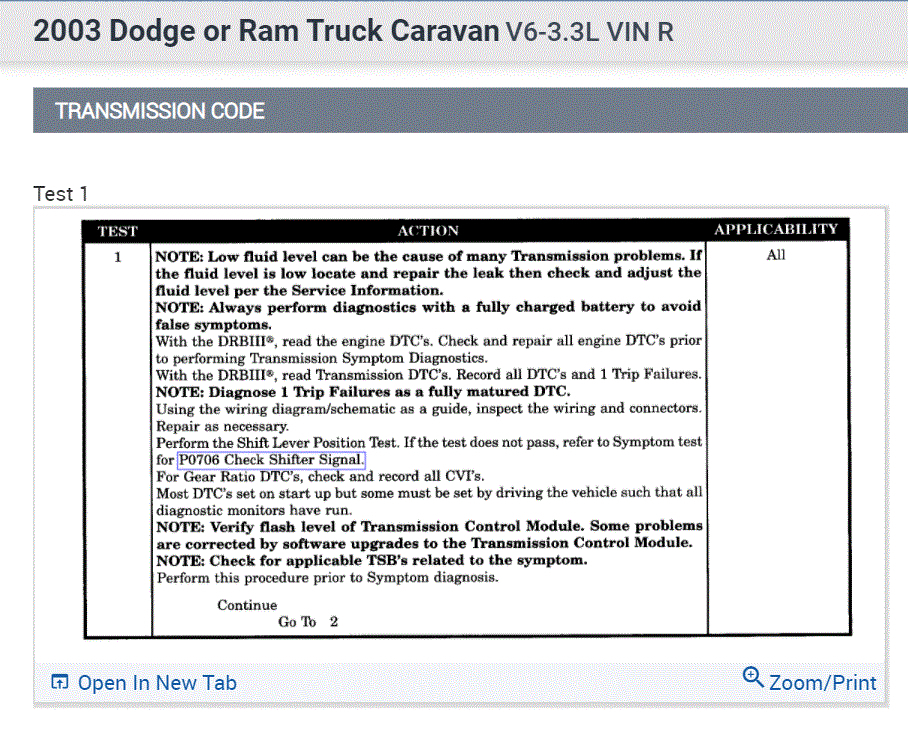

transmission stuck in second gear
2003 DODGE CARAVAN
184,000 MILES • 3.3L • V6 • 2WD • AUTOMATIC
2315269293

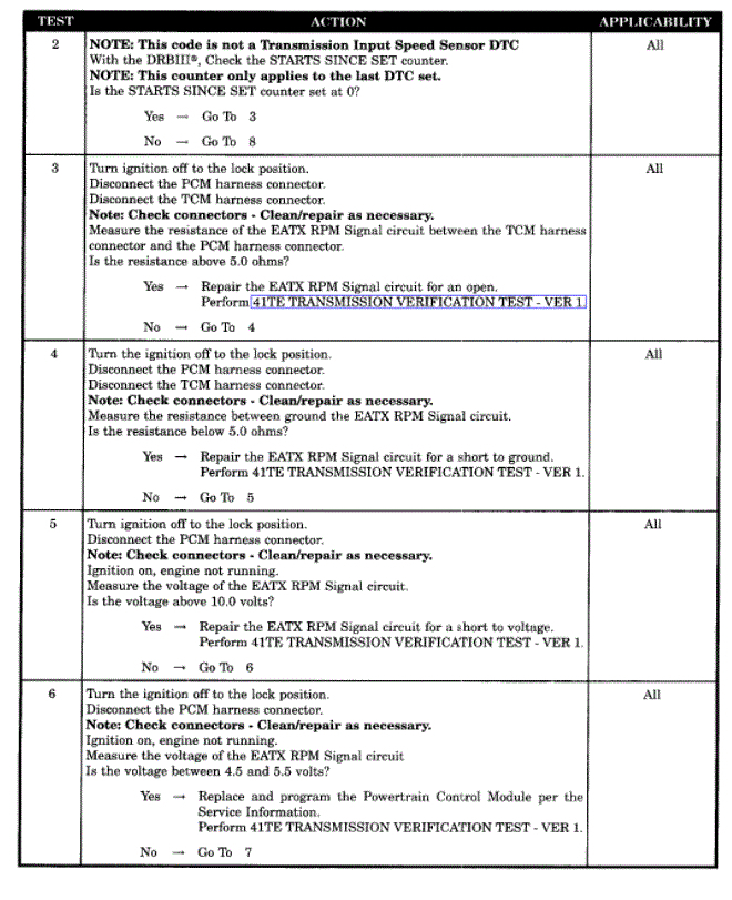

Transmission computer cannot find a tack reading.
Jan 7, 2022 at 8:43 AM
  • 110,244 POSTS
When you say tack reading, are you referring to the vehicle speed or the tachometer? Also, could you provide me with the diagnostic trouble codes that were retrieved? That will help me diagnose possible causes.
Take care and I'll watch for your reply.
Jan 7, 2022 at 1:17 PM
2315269293
transmission computer couldn't find the tack scanner had vehicle speed and both input and output sensor were working code was p0725.
Jan 8, 2022 at 7:34 AM
  • 110,244 POSTS

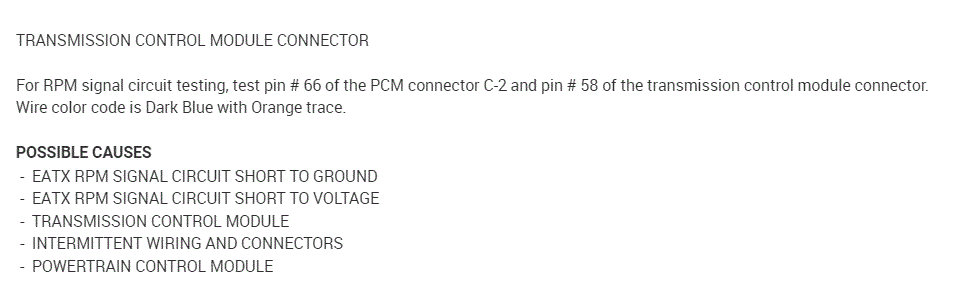

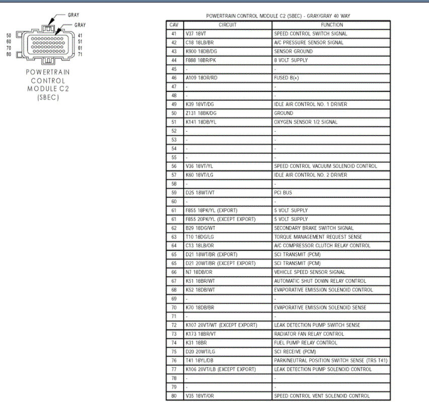

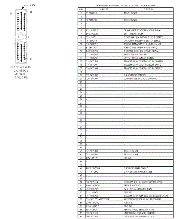

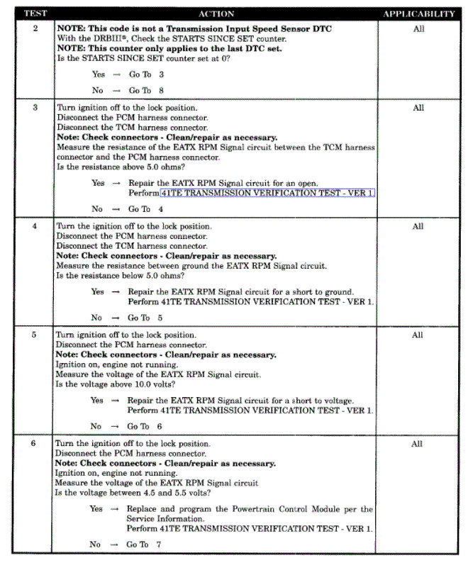

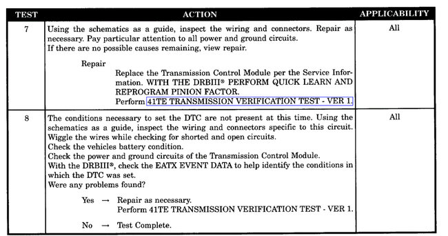

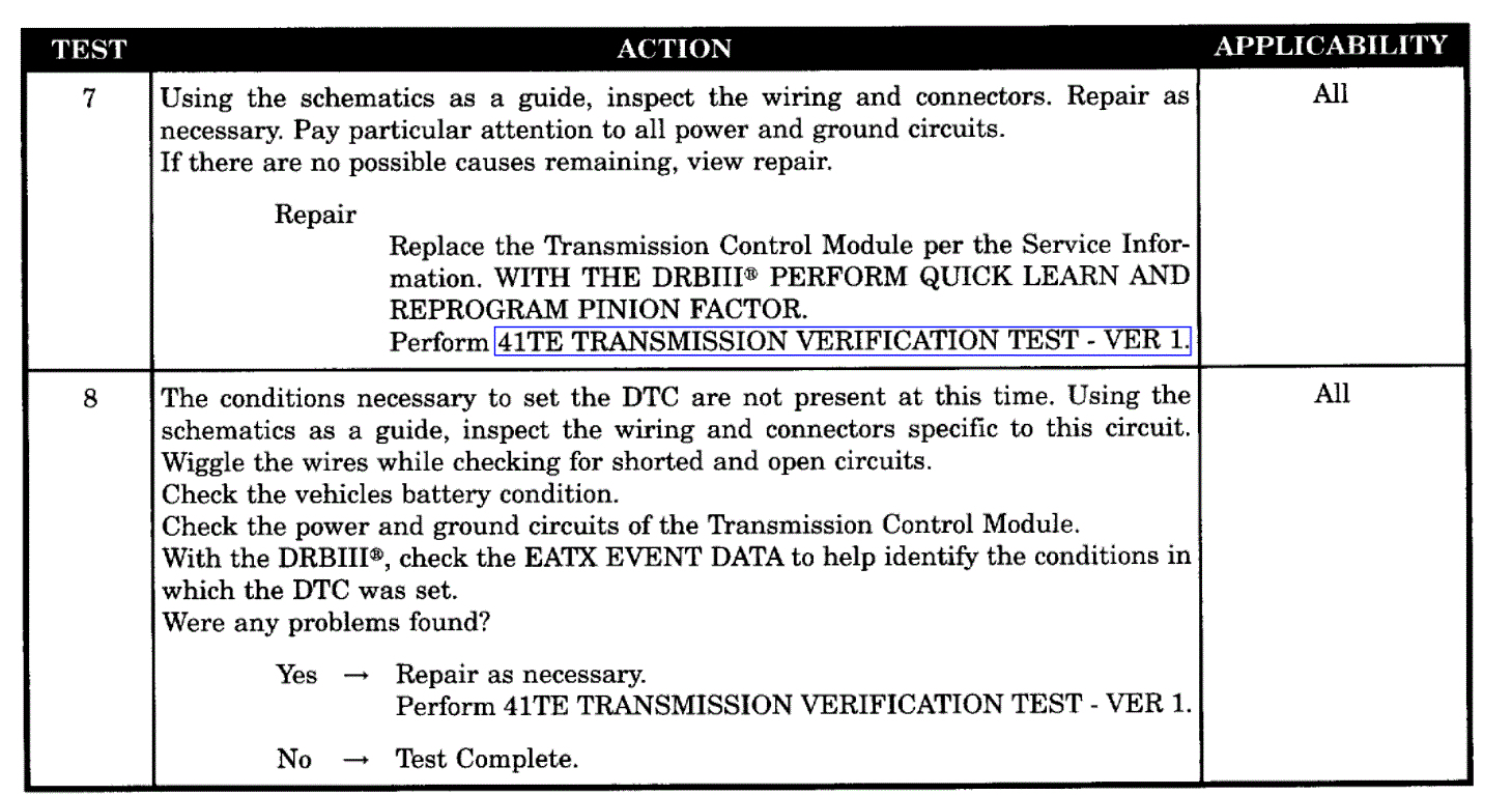

It sounds like there is a short between the PCM and transmission. I attached diagnostics below. Take a look at them and let me know if it is something you are comfortable doing.
