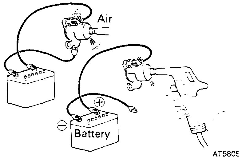

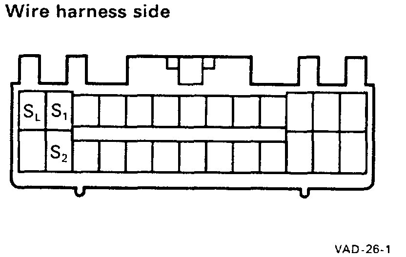

Has the transmission been serviced? I could be a shift solenoid that is hanging up due to dirt. I have the tests for the solenoids if you feel confident testing, but it will require some basic electrical testing. Here are the directions. The attached pics correlate with the directions.

Connector ID
Pic 1
Inspect Solenoid Resistance
- Disconnect the connector from Engine and ECT ECU.
- Measure the resistance between S1, S2, SL and body ground.
Resistance: 11 - 15 ohms
- Apply battery voltage to each terminal.
- Check that an operation noise can be heard from the solenoid.
Solenoid Inspection
Pic 2
Check Solenoid Operation
- If there is foreign material in the solenoid valve, there will be no fluid control even with solenoid operation.
- Check No. 1, No. 2 and lock-up solenoid valves.
- Apply 490 kPa (5 kg/cm2, 71 psi) of compressed air, check that the solenoid valves do not leak the air.
- When battery voltage is supplied to the solenoids, check that the solenoid valves open and air flows.
______________________________________

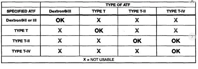

Yes, I did fluid and filter changed every year. I heard that if I increase fluid viscosity it will help eliminate the problem.
Feb 10, 2020 at 10:34 AM
  • 110,194 POSTS
The idea of getting a heavier viscosity isn't relevant to ATF. People would use a heavier oil in the engine with hopes of fixing ticks, knocks, low oil pressure and so on. However, not in a transmission. Actually, it will make things worse.
If you look at the picture below, it shows what can be used and what shouldn't.
Let me know if this helps. I still suspect there is a solenoid issue. Did you ever have the chance to check?
