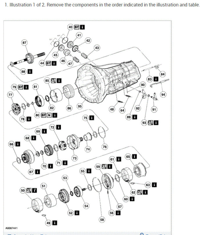

Transmission installation full parts diagram that shows each part and gives their name needed

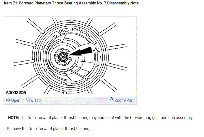

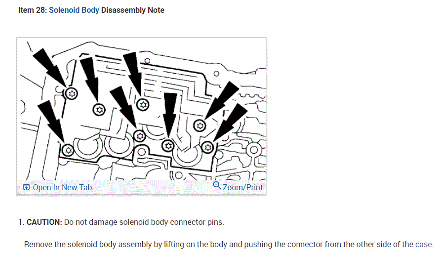

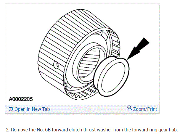

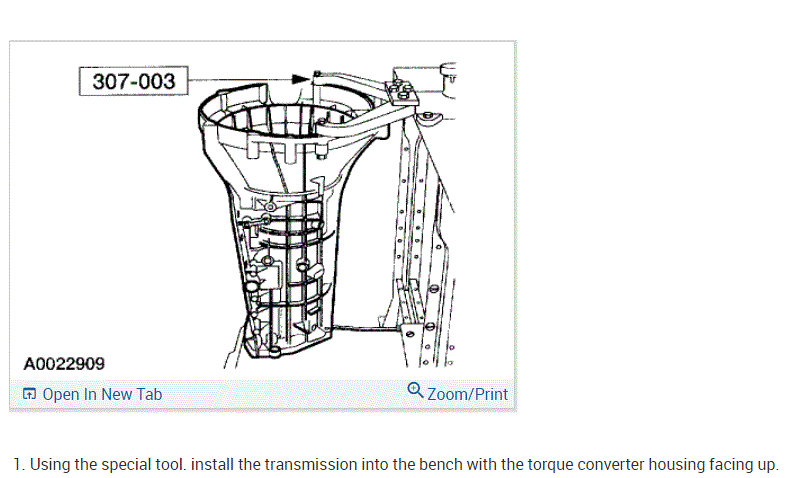

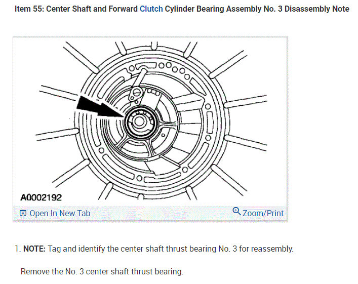

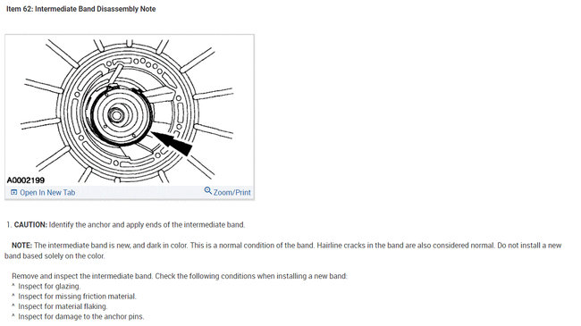

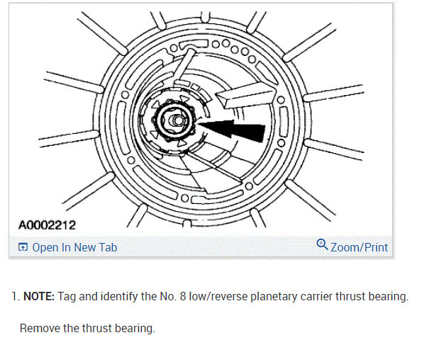

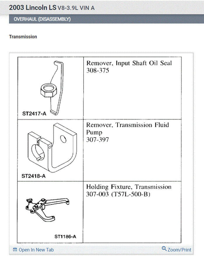

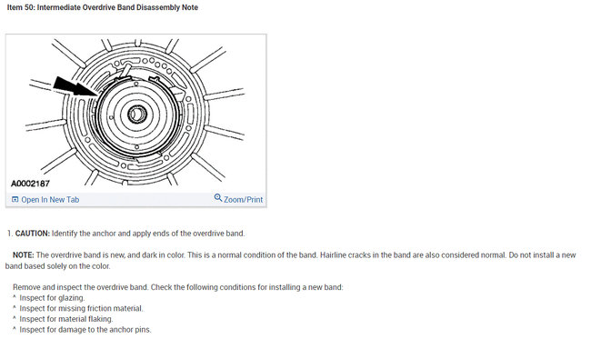

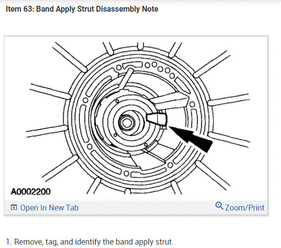

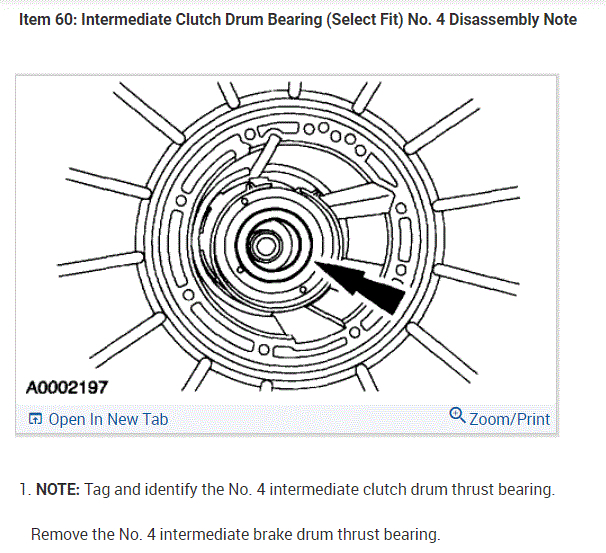

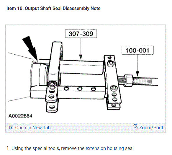

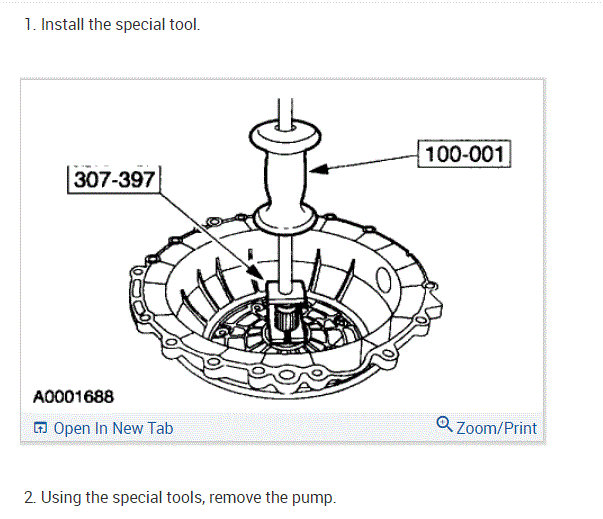

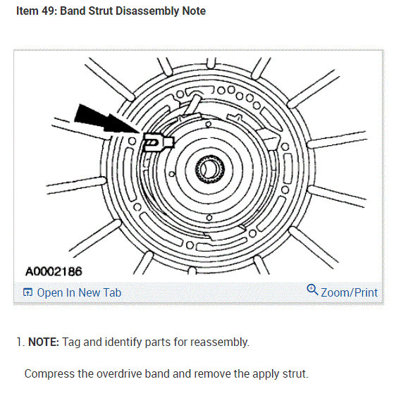

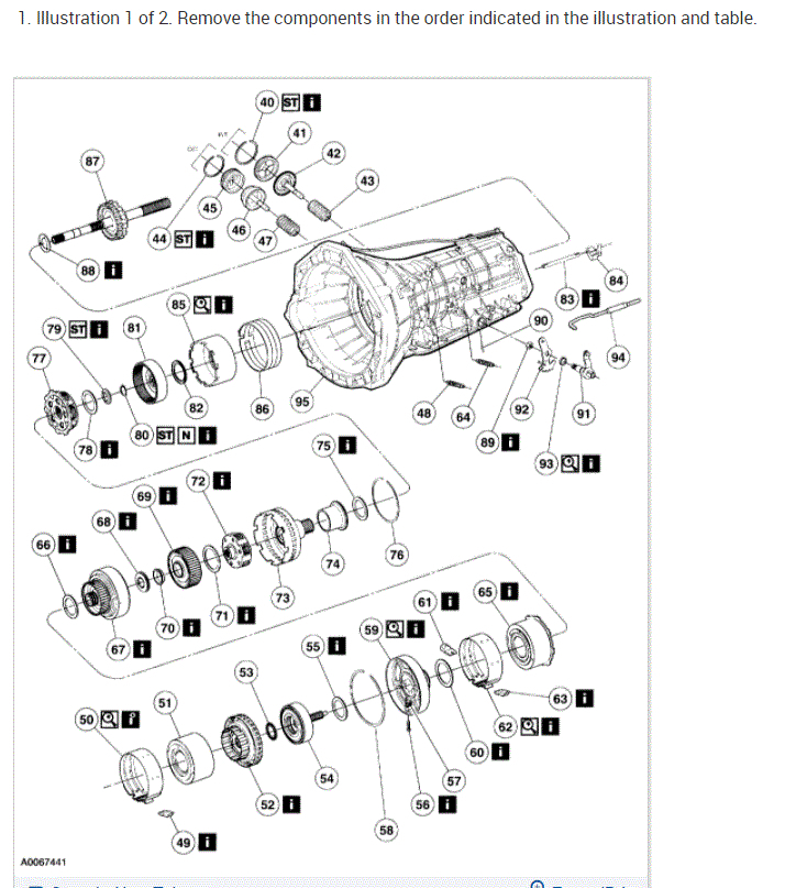

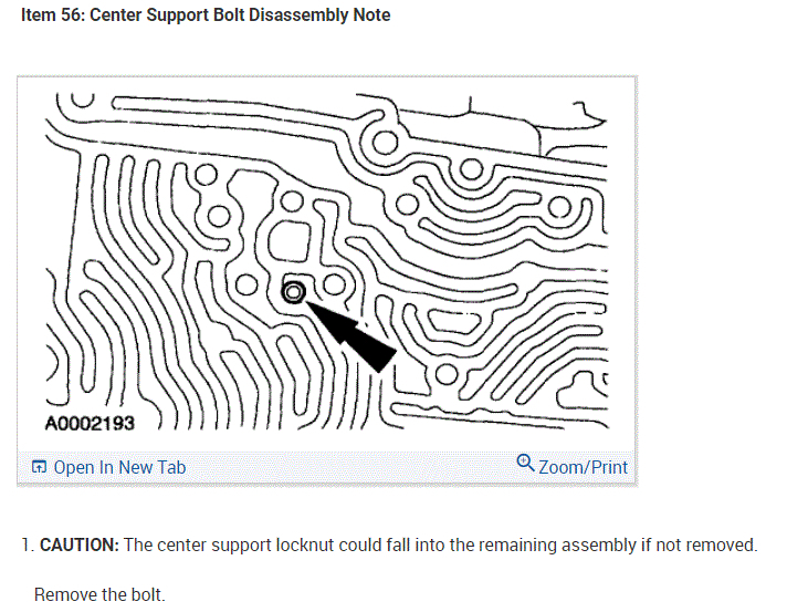

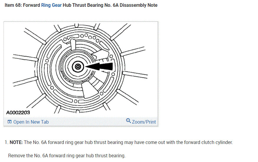

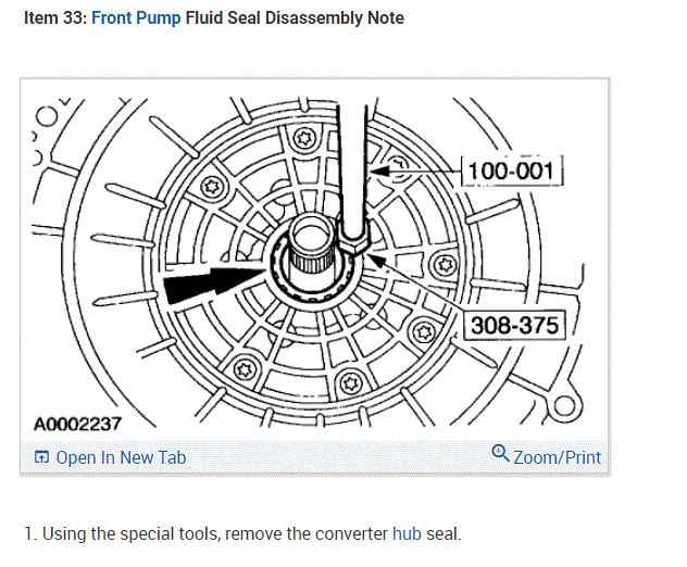

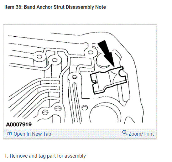

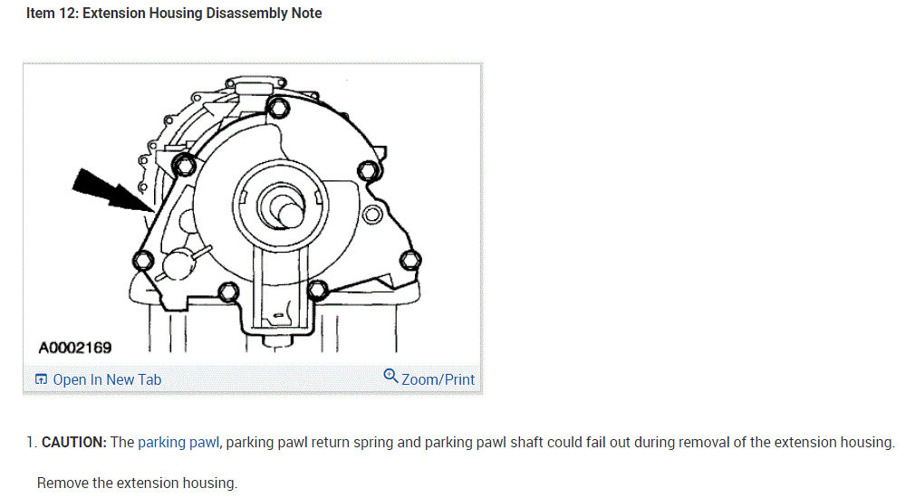

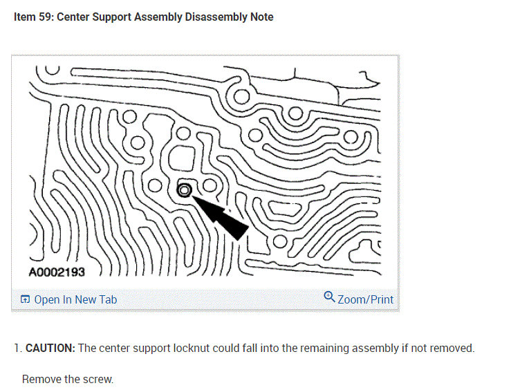

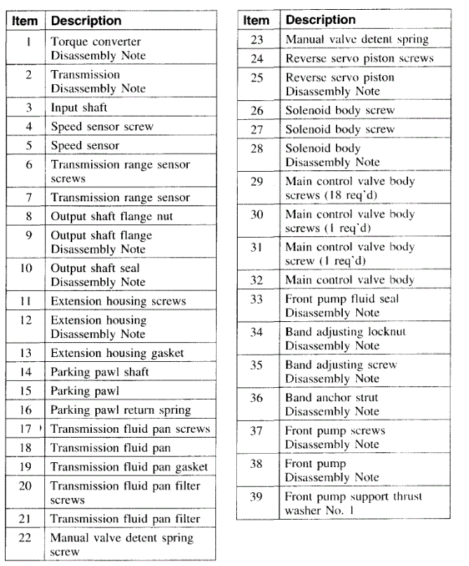

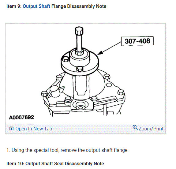

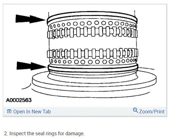

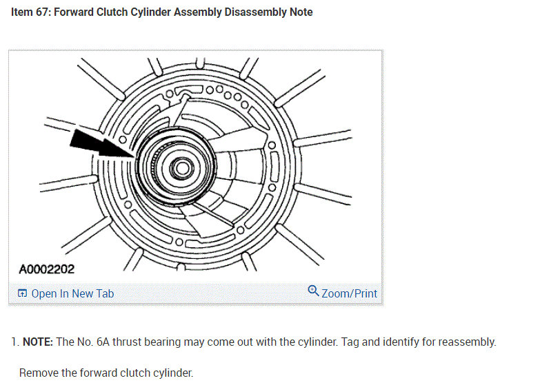

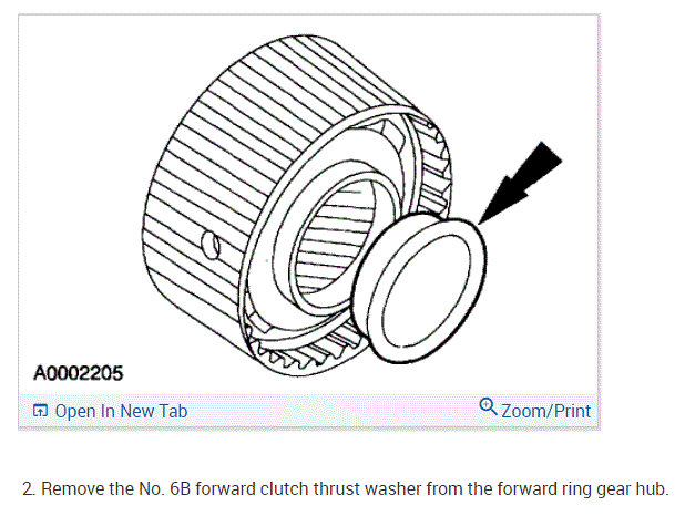

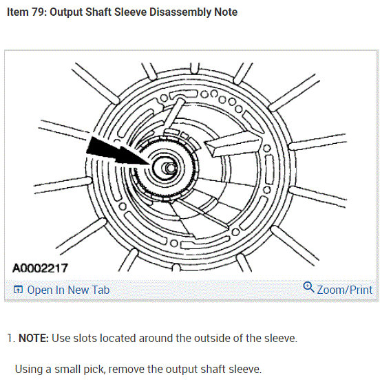

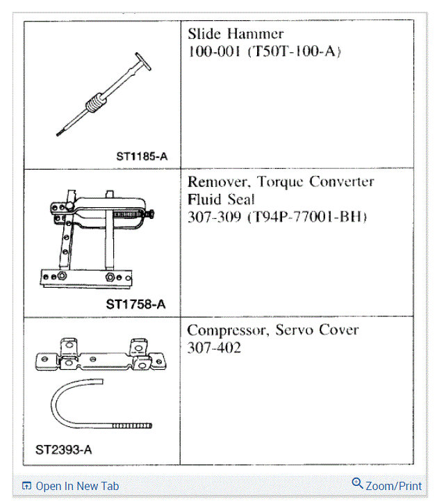

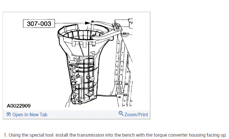

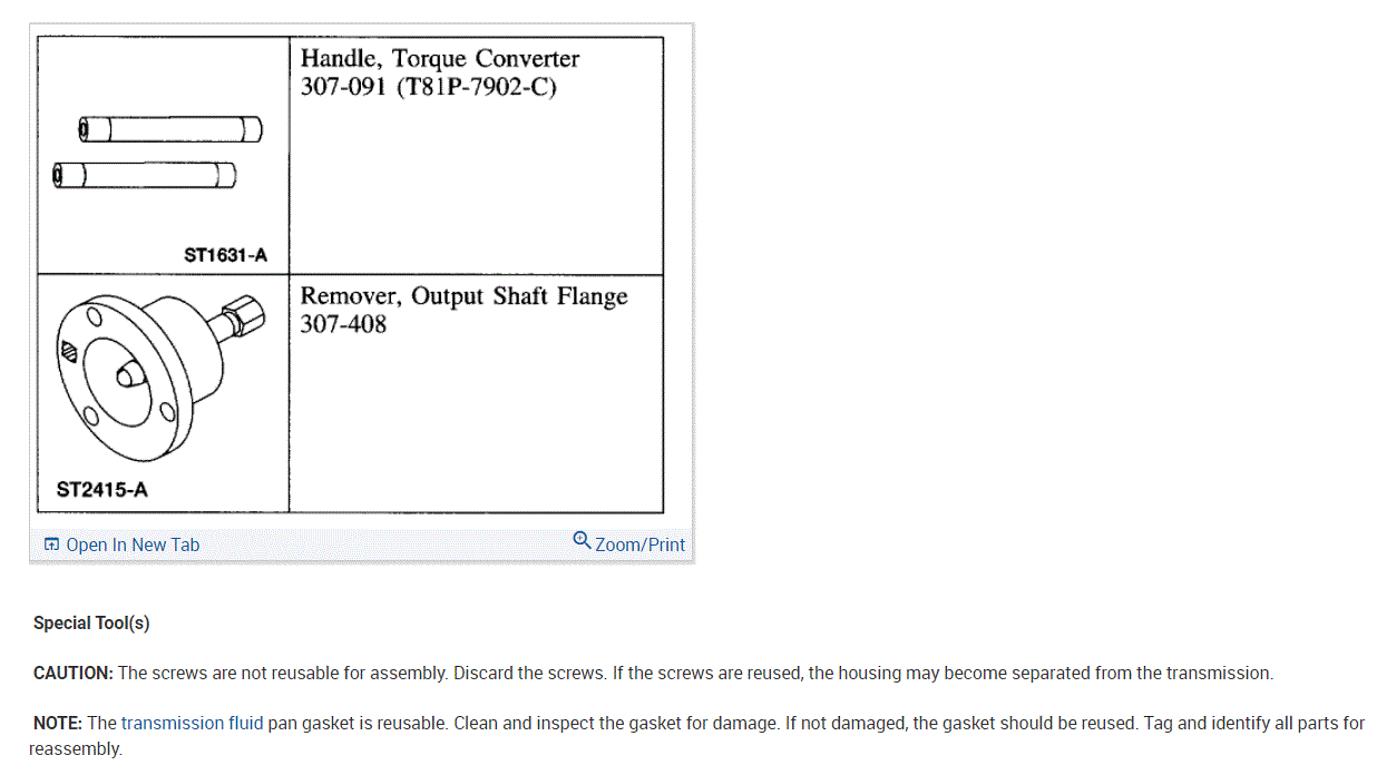

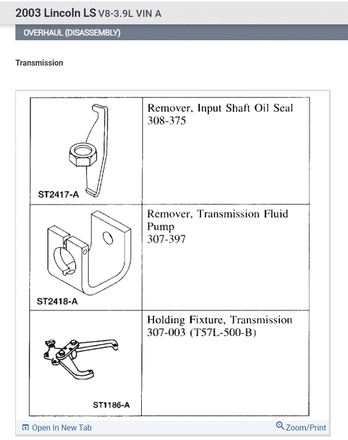

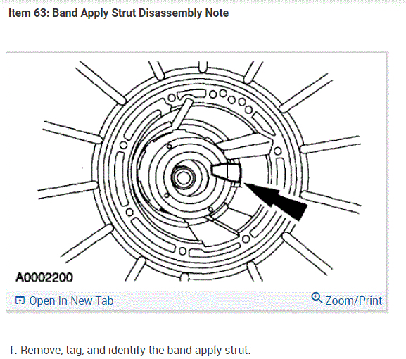

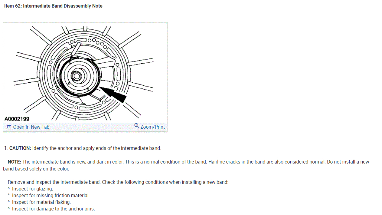

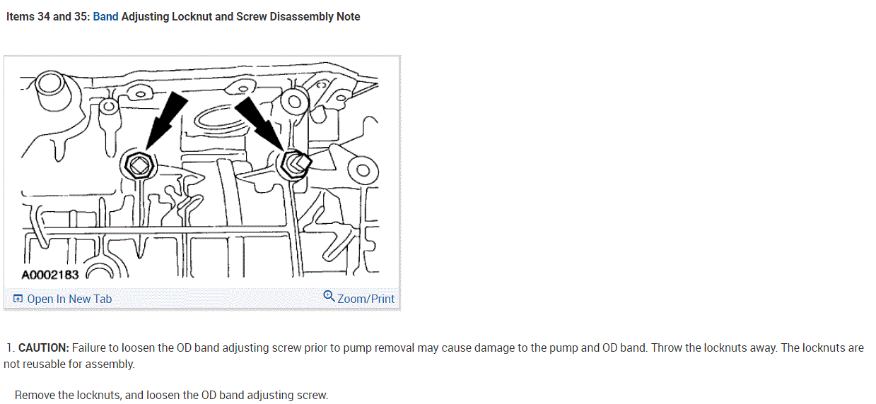

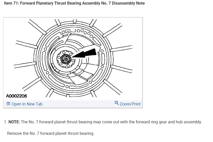

I'm changing transmission in my car, and I am having trouble ordering some of the parts I need and I don't remember exactly how they go back together. Can I get a full parts diagram that shows each part and gives their name so I can order the correct parts and put them back together?
Oct 22, 2021 at 9:18 PM
  • 110,244 POSTS
Hi, Brian.

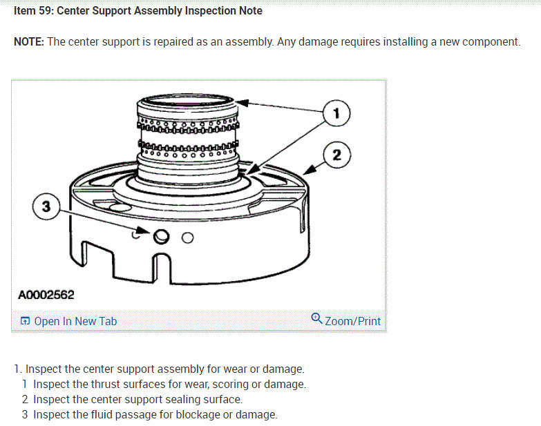

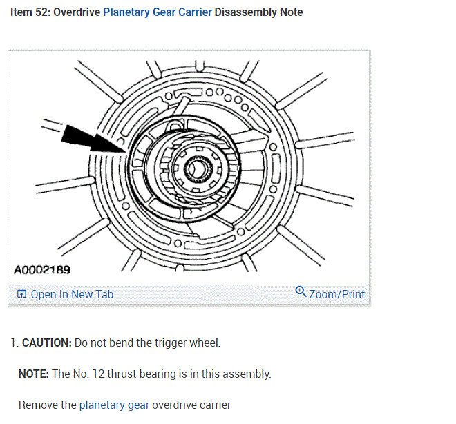

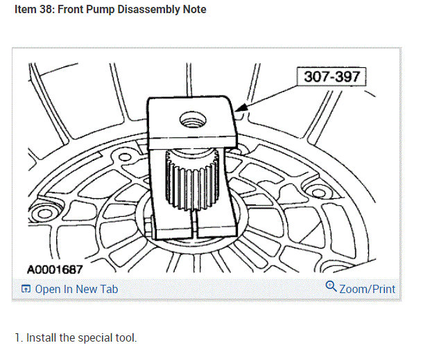

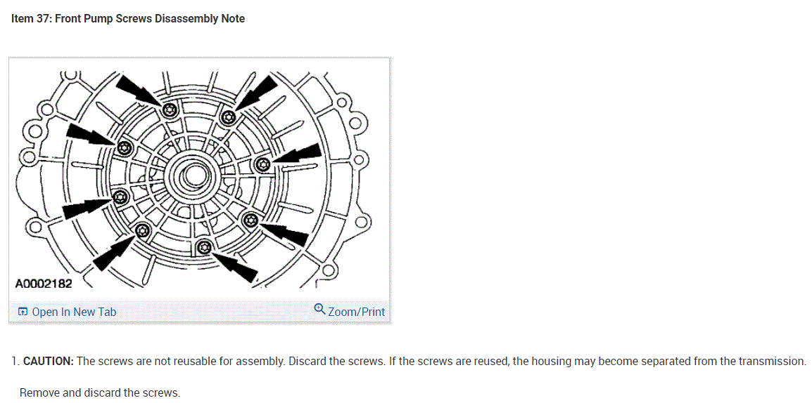

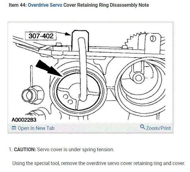

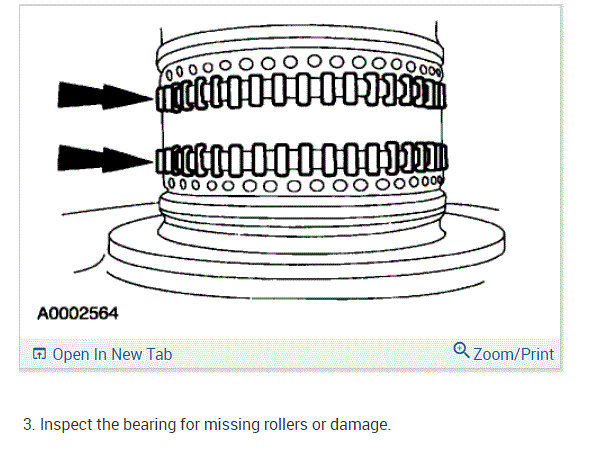

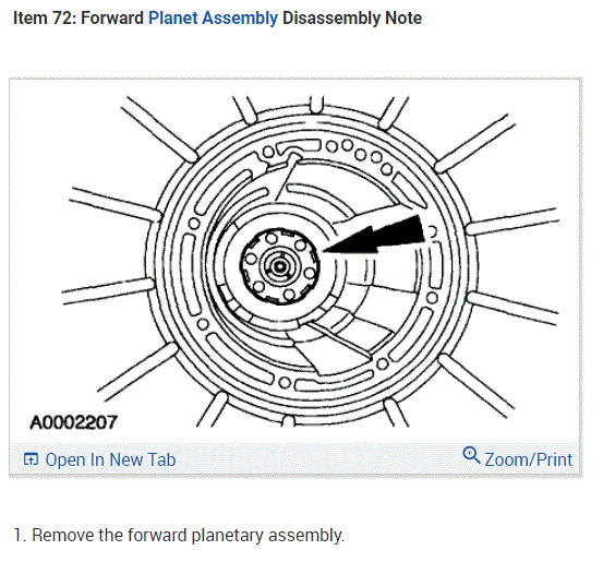

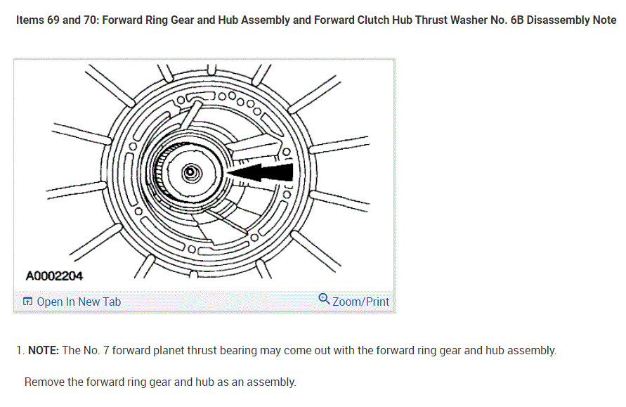

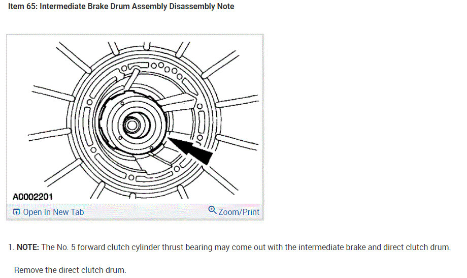

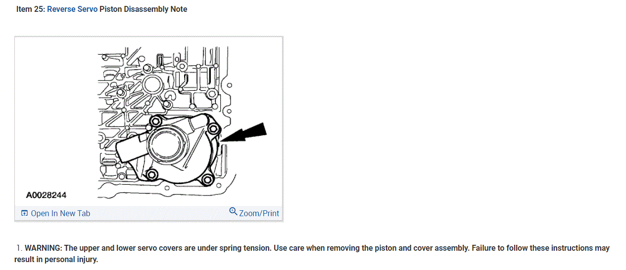

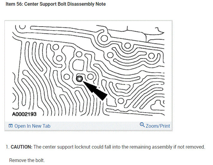

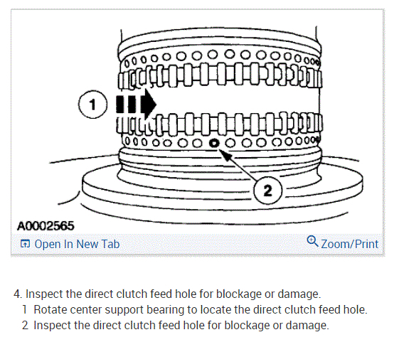

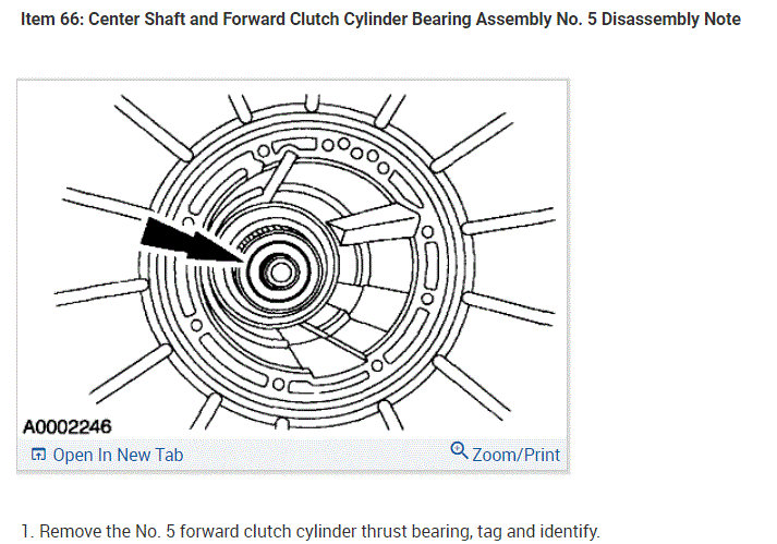

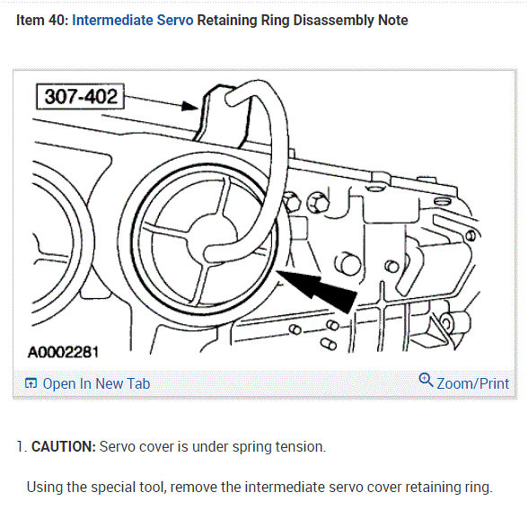

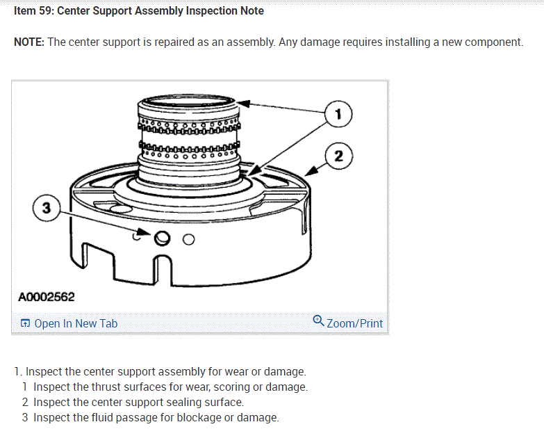

I attached the directions for disassembly and inspection of the entire transmission below. These directions begin with exploded views and part identification. Let me know if this is what you needed.
