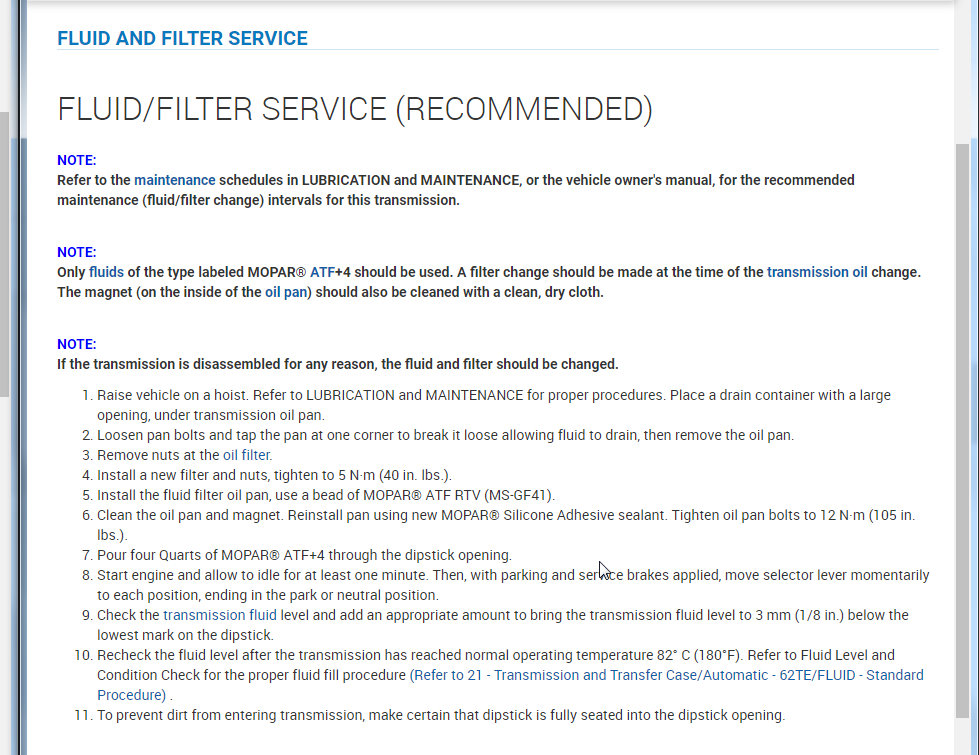

He said I need a transmission service I need to do the job myself.
Sep 12, 2020 at 5:01 AM
Here is a guide that will help with this:
Below you will find the process from the manual on how to replace the filter and fluid. Please let us know if you have other questions. Thanks
