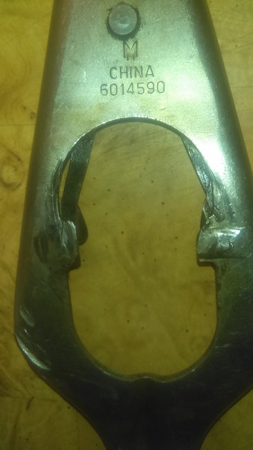

The fork that holds the throw out bearing in place came loose. Also the clips that hold the bearing on the input shaft got bent. I did straighten it out somewhat. Can the fork be reused? It was not installed correctly.

The fork that holds throw out bearing in place got bent. I straightened it out the best I could. It is made like the bearing goes into a big end then slides over to a smaller end. Like a curtain rod mount. Can it be reused or does it need to be replaced? And clutch fluid leaks from between the engine and transmission. Slave cylinder has never given me any problems until now. Boot is not busted or anything. But fluid still leaks.
Jul 31, 2016 at 6:58 AM
SATURNTECH9
  • 30,869 POSTS
If everything fits and works like its supposed to then I would say you can reuse it. If it does not then just replace it if your not sure replace it. better to be safe then sorry. As far as the leak goes if the slave cylinder is leaking replace it. It could have been damaged by what happened.
Jul 31, 2016 at 7:23 AM
CAJUNGUY1965
  • 39 POSTS
A friend who owns a transmission shop told me after looking at the fork, it will never hold the throw out bearing in place. The fingers are so worn. So j will order one from a dealer tomorrow for 75$. Thanks a lot for your help

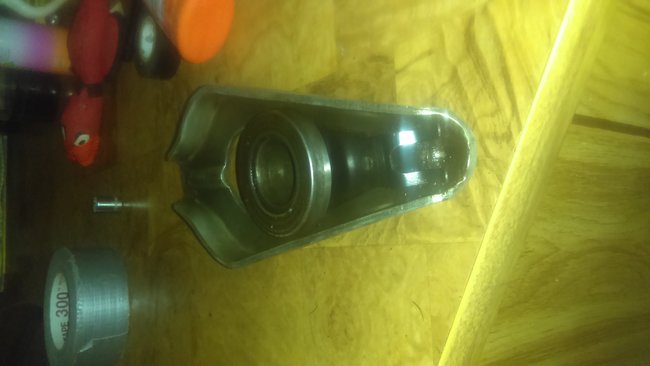

It appears the clutch fork came loose again. I installed it the way that was shown to me. There is no springs holding it in place. I have to take things apart to place fork right. This is the third time this has happened to me. The fork is new from a dealer. Throw out bearing is the same as what has been on truck. It spins freely like it's supposed to but just the clips that hold it in its place keeps coming loose. What causes this?
Aug 9, 2016 at 5:14 AM
CAJUNGUY1965
  • 39 POSTS
It appears the clutch fork came loose again. I installed it the way that was shown to me. There is no springs holding it in place. I have to take things apart to place fork right. This is the third time this has happened to me. The fork is new from a dealer. Throw out bearing is the same as what has been on truck. It spins freely like it's supposed to but just the clips that hold it in its place keeps coming loose. What causes this? Throw out bearing is installed the way this picture shows. Is it right or wrong?

If the fork is moving out of place of course the throw out bearing is going to come out of the fork.Most of the time there is a clip the holds the end of the fork on the ball on the transmission.
Aug 9, 2016 at 5:31 AM
CAJUNGUY1965
  • 39 POSTS

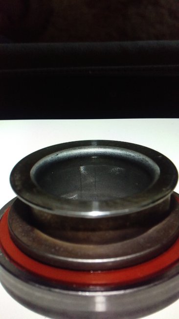

Yes there is a ball that holds the fork in place. That's what keeps coming loose. I clipped it on Luke it supposed to be. Or at least I'm pretty sure it's clipped on correctly. It keeps coming loose tho. I can't figure out what's going on with it. Is the throw out bearing in picture installed correctly?
Aug 9, 2016 at 6:26 AM
SATURNTECH9
  • 30,869 POSTS
It's hard to tell in that picture do you have the large part of the bearing going against the pressure plate?
Aug 9, 2016 at 7:12 AM
CAJUNGUY1965
  • 39 POSTS
No. The large part of throw out bearing is towards the transmission/truck. The large part of bearing is on the inside of clutch fork
Aug 9, 2016 at 7:23 AM
SATURNTECH9
  • 30,869 POSTS
So you have the side facing up in the picture sitting against the pressure plate?if so there's your problem.
