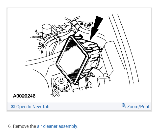

Got stuck in a snowbank. When it was pulled out out the car will go in reverse but not forwards.

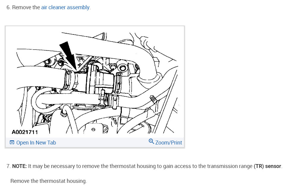

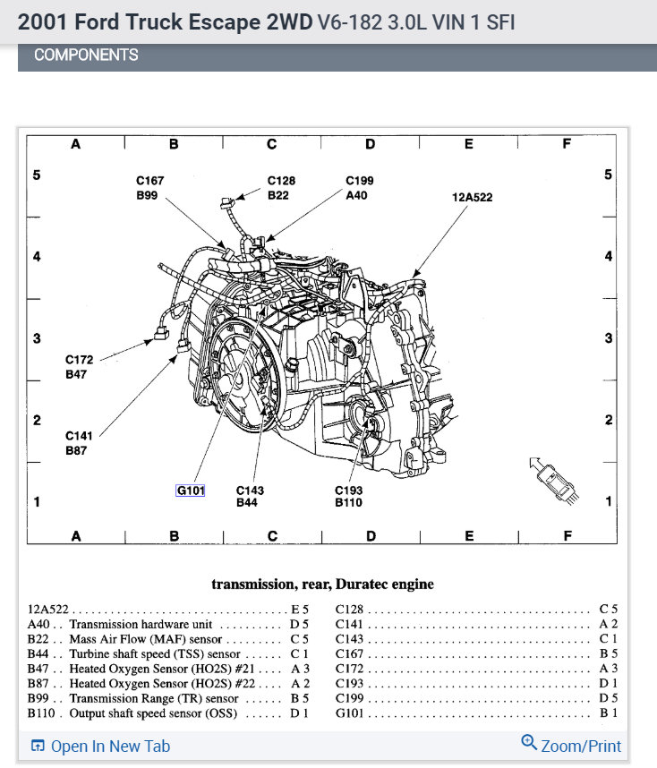

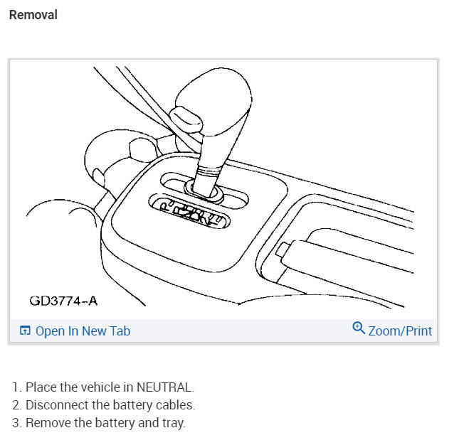

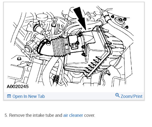

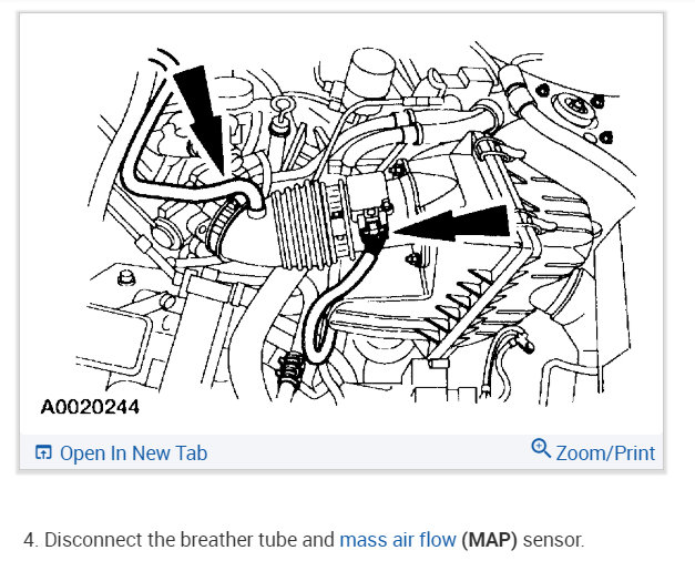

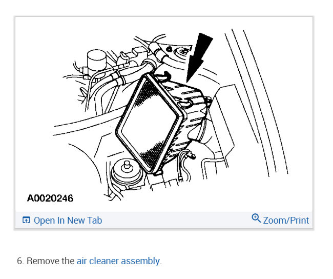

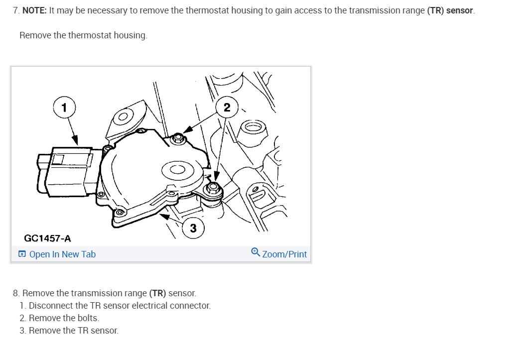

Okay, did you ever run the codes? It could be the gear position sensor that has gone out. Check out the diagrams (below). Please let us know what happens.

My obd2 reader doesn't show any codes for the transmission. I will let you know what I find out.
