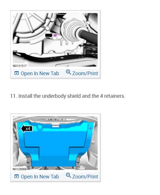

transmission is not changing into gear once I take off from complete stop?
2012 FORD EDGE
202,300 MILES • 2.0L • 6 CYL • TURBO • 2WD • AUTOMATIC
KIMYA92!
When get on highway the transmission isn't changing into gear once I take off from complete stop and as I'm accelerating the vehicle seems like the humming sound gets louder and louder.
Jan 20, 2023 at 2:40 PM
  • 55,399 POSTS

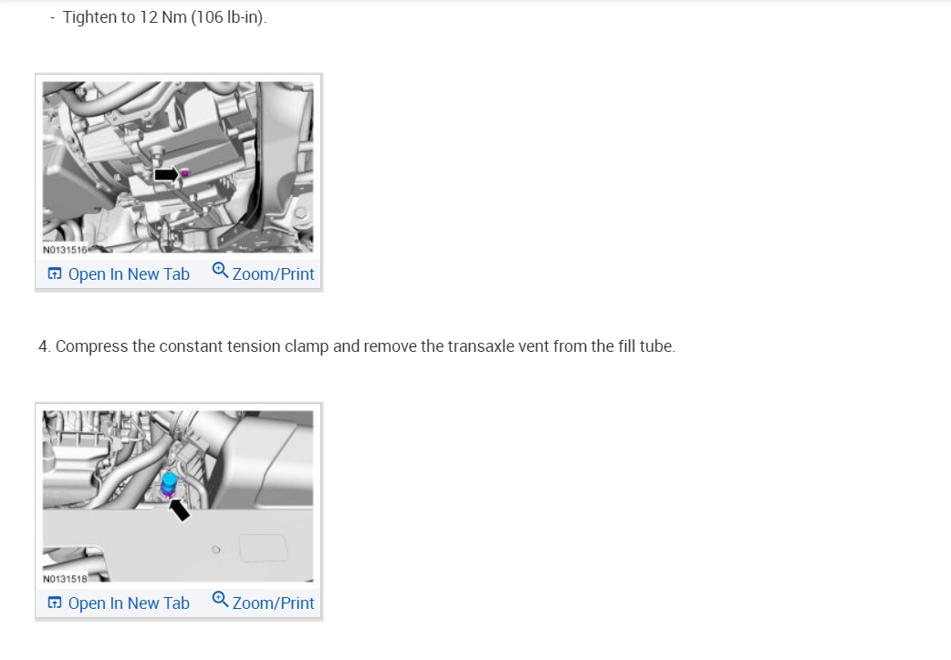

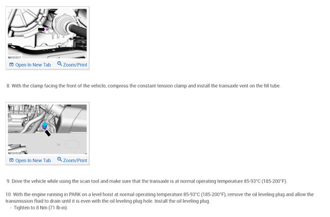

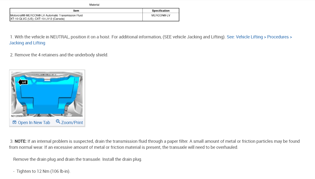

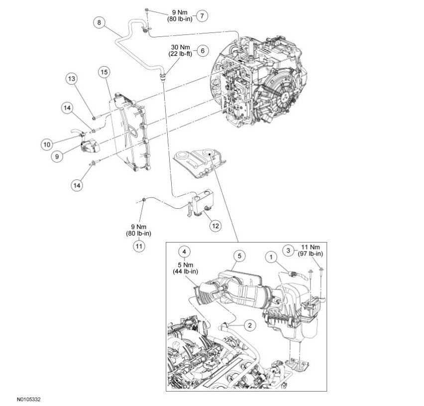

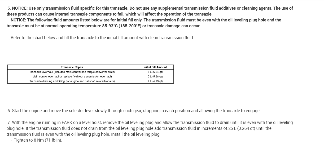

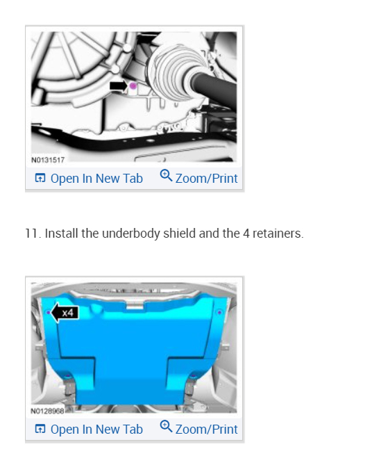

This humming sound could be the transmission filter being plugged which will affect the transmission operation. Here is a generic guide to help you step by step with instructions in the diagrams below to show you how to on your car.
Jan 21, 2023 at 3:39 AM
KIMYA92!
Okay, I appreciate you. I haven't taken it to the shop yet, but it's in progress of going I just hope I don't have to get new transmission. My vehicle listed above is a Limited model.
Jan 21, 2023 at 3:53 AM
  • 55,399 POSTS
Yep, we try to fix the problem and use a new transmission as the last resort. Let me know what happens please.
