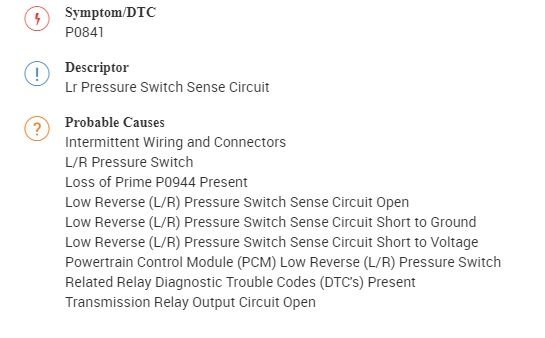

Most of the codes are saying that there is low voltage. How do I know it's electric, and not the transmission? I changed the transmission fluid and filter and it still does it. How can I determine what the issue is?

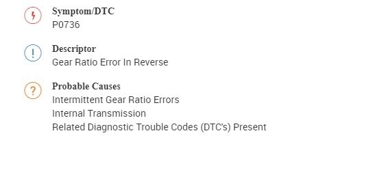

The codes that I have are, p0736. P0841,p2776,po481, po300. And po700. Thanks for the help.

Okay, the 736 is the key. That is a ratio error which means it is slipping internally.
That will require removal of the transmission and either a rebuild or replacement

Is there any way around rebuilding the transmission? Do you think that there is a bad connection or a short in the wiring?
Apr 10, 2020 at 10:31 AM
No, not for the gear ratio code.. You can continue to drive it for now but it will get worse over time until you are restricted to one forward gear only.
