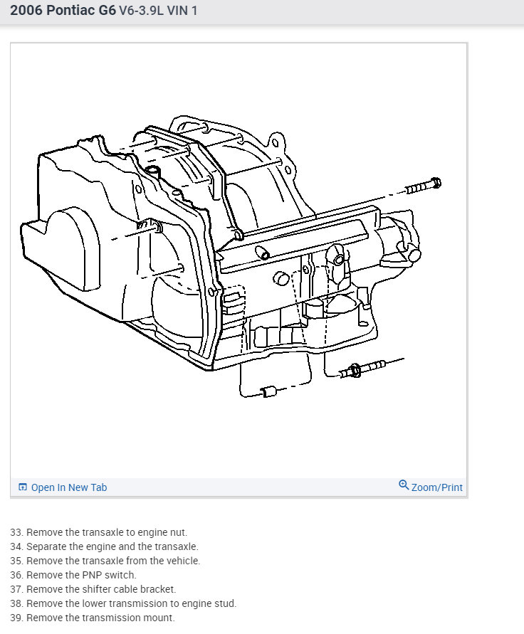

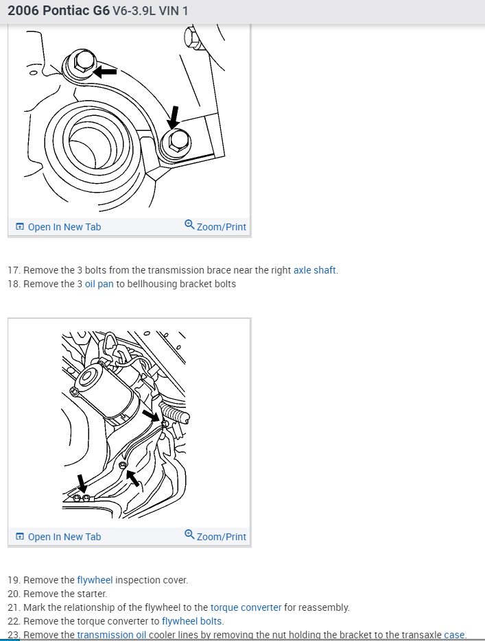

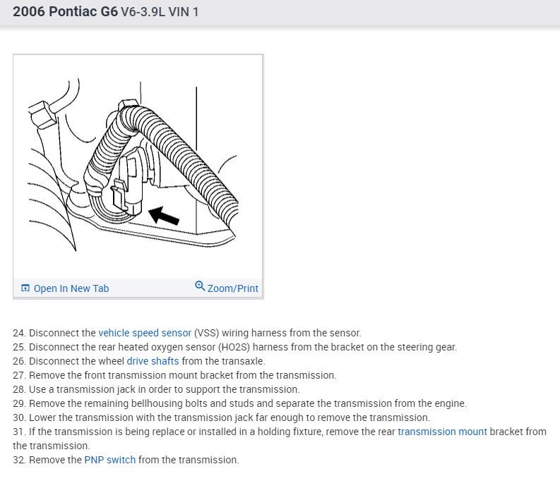

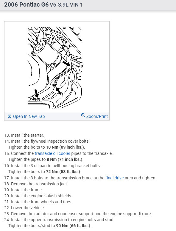

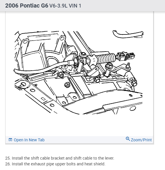

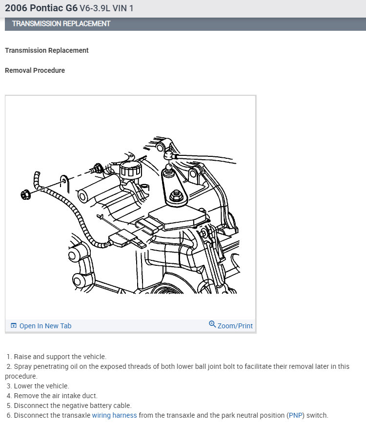

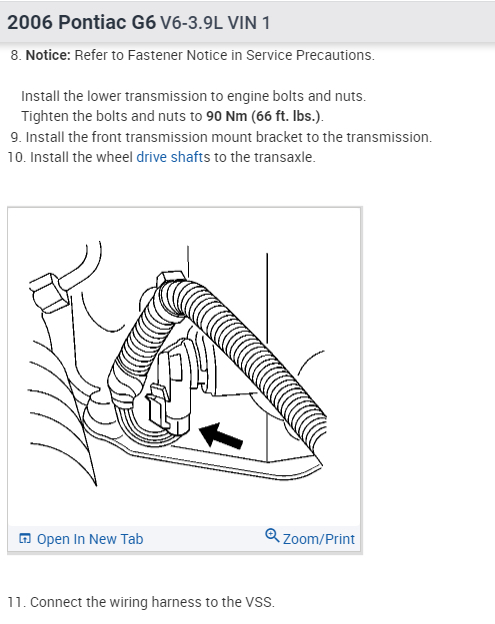

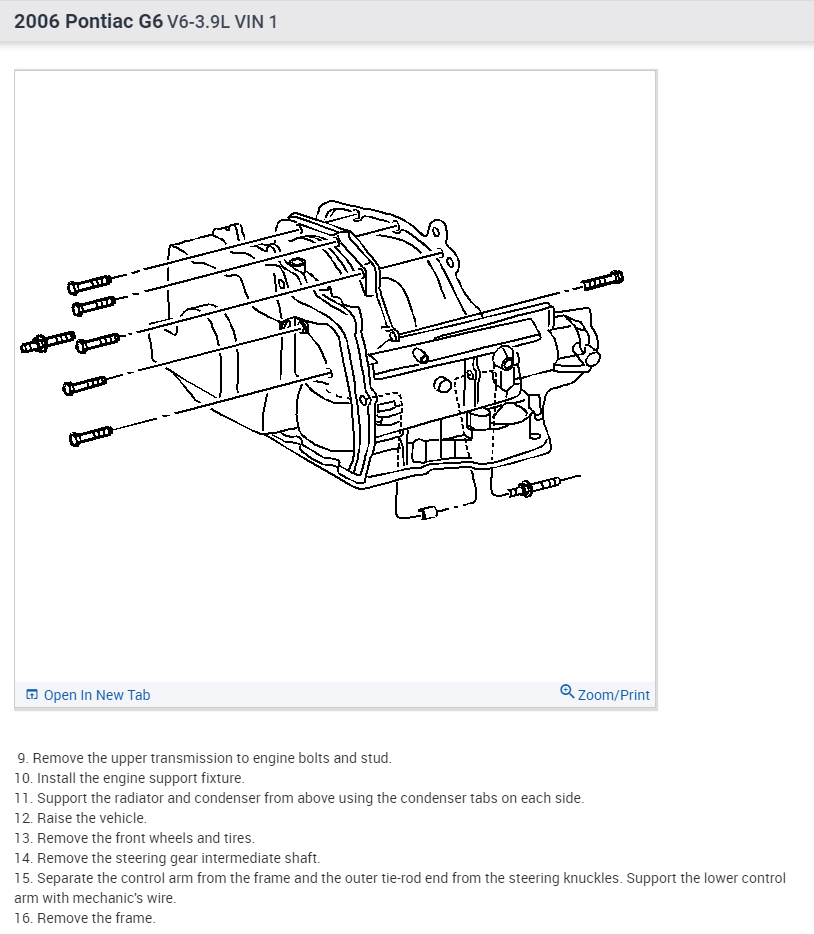

I need detailed instructions for the replacement of my transmission.
Jun 25, 2022 at 8:43 PM
SQM
  • 6,383 POSTS

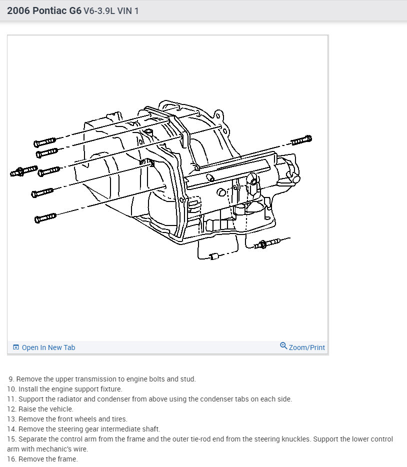

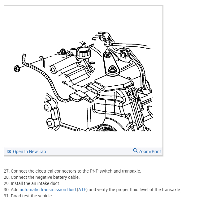

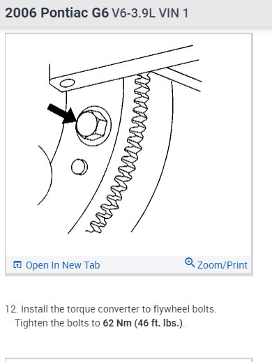

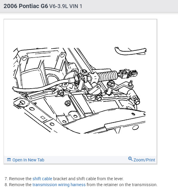

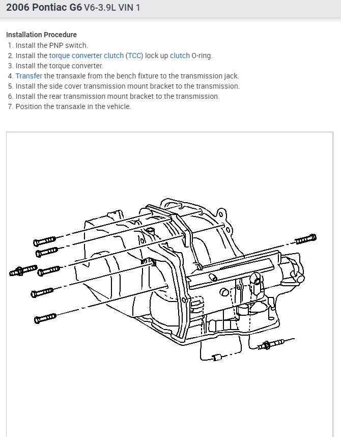

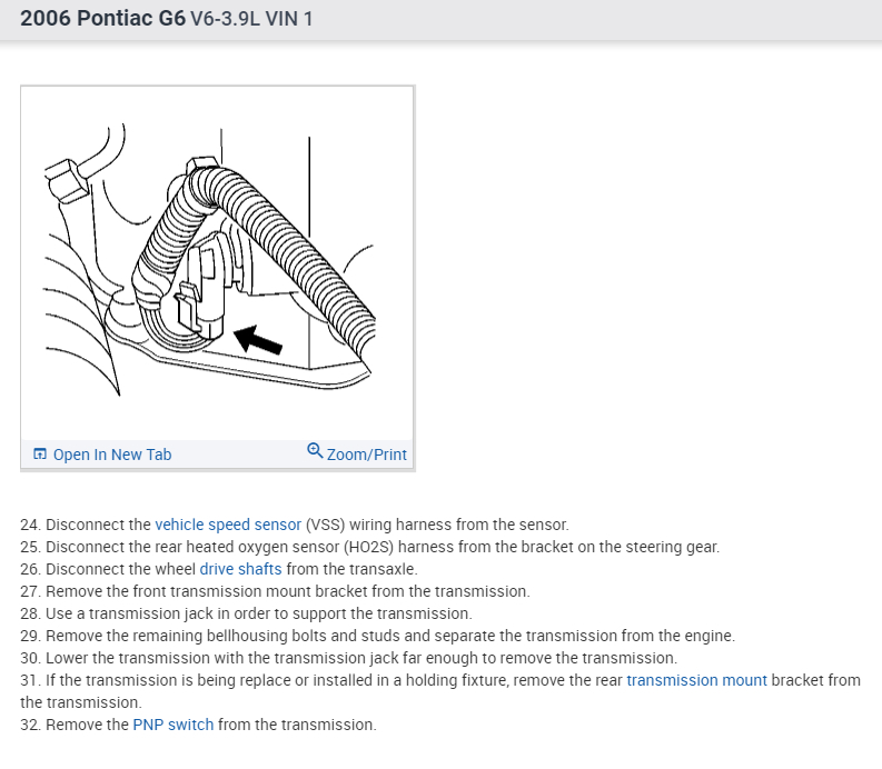

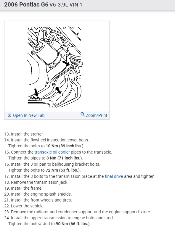

See attached for the transmission replacement procedure, for the 4T45-E transmission.
If your vehicle is equipped with the 4T65-E transmission, let me know and I will provide info on that as well.
Let me know of any questions.
