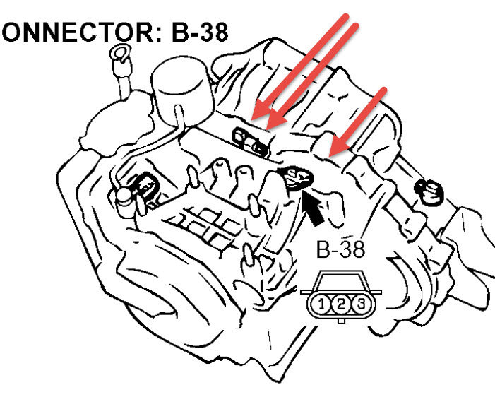

I have a SOHC and my transmission went out. I went to pick and pull and pulled an 2000 same everything. But it still stays in limp mode and is throwing a code for incorrect third gear ratio. Did I get a bad transmission? Does this year no work with the 2003? If I have to get another one can it be from a DOHC or does it have to be from. A SOHC. And do I have to have one from a 3.0 or can it be a 2.6?

Previously answered. See pictures double arrow points to input sensor single arrow output. Check harness for being bad as well as connections.

Do you know if the input and output speed sensors are the same from the 2000 and the 2003. Because I bought new ones for a 2003 but put a 2000 transmission in my vehicle.

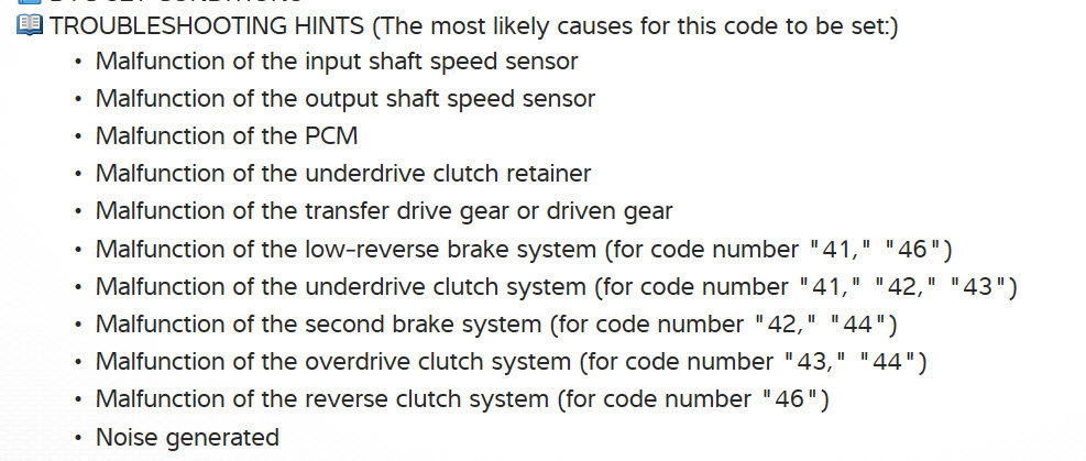

The code it shows is a p0733- power train gear three incorrect third gear ratio.

So I notice on my sensor plug one of the wires is slightly exposed. Could this be causing my issue?

F4A512LZP Was only used in 2003-2005 Mitsubishi Eclipse GTS with the 3.0 and is the correct transmission you need.
F4A512E6B Was used in the 2000 Eclipse with the 3.0. It has a different ratio for third which is why it is throwing the code.
From the outside the transmission looks exactly alike but they use different gearing.

F4A512LZP is the only transmission that will directly interchange and it only came in those years and those cars.
