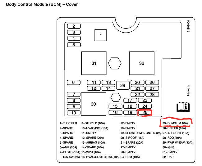

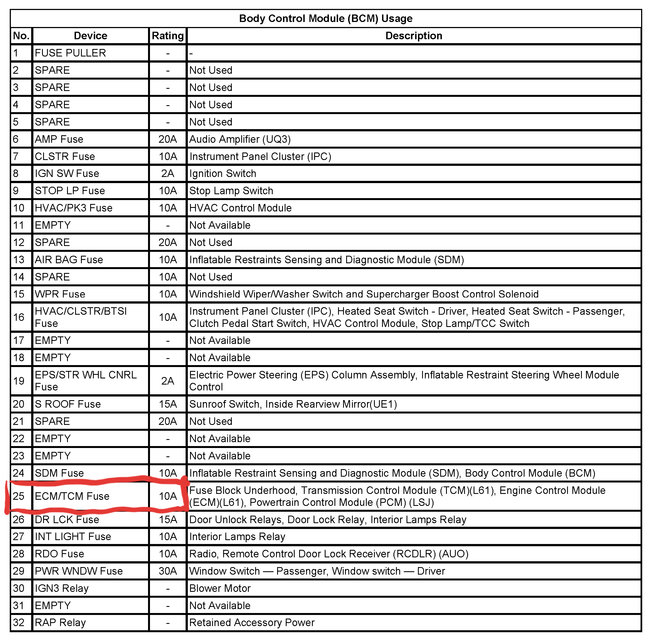

Check fuse #10 inside cabin. 10A fuse.

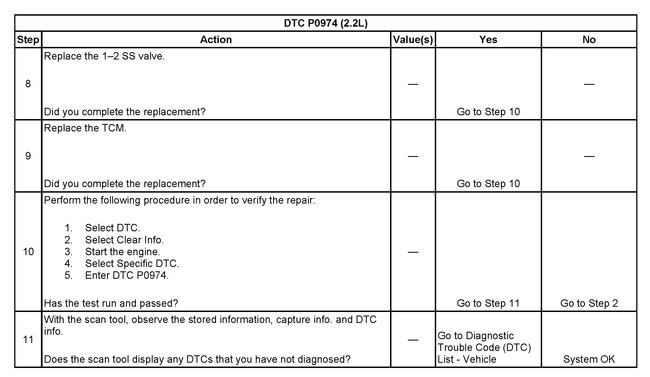

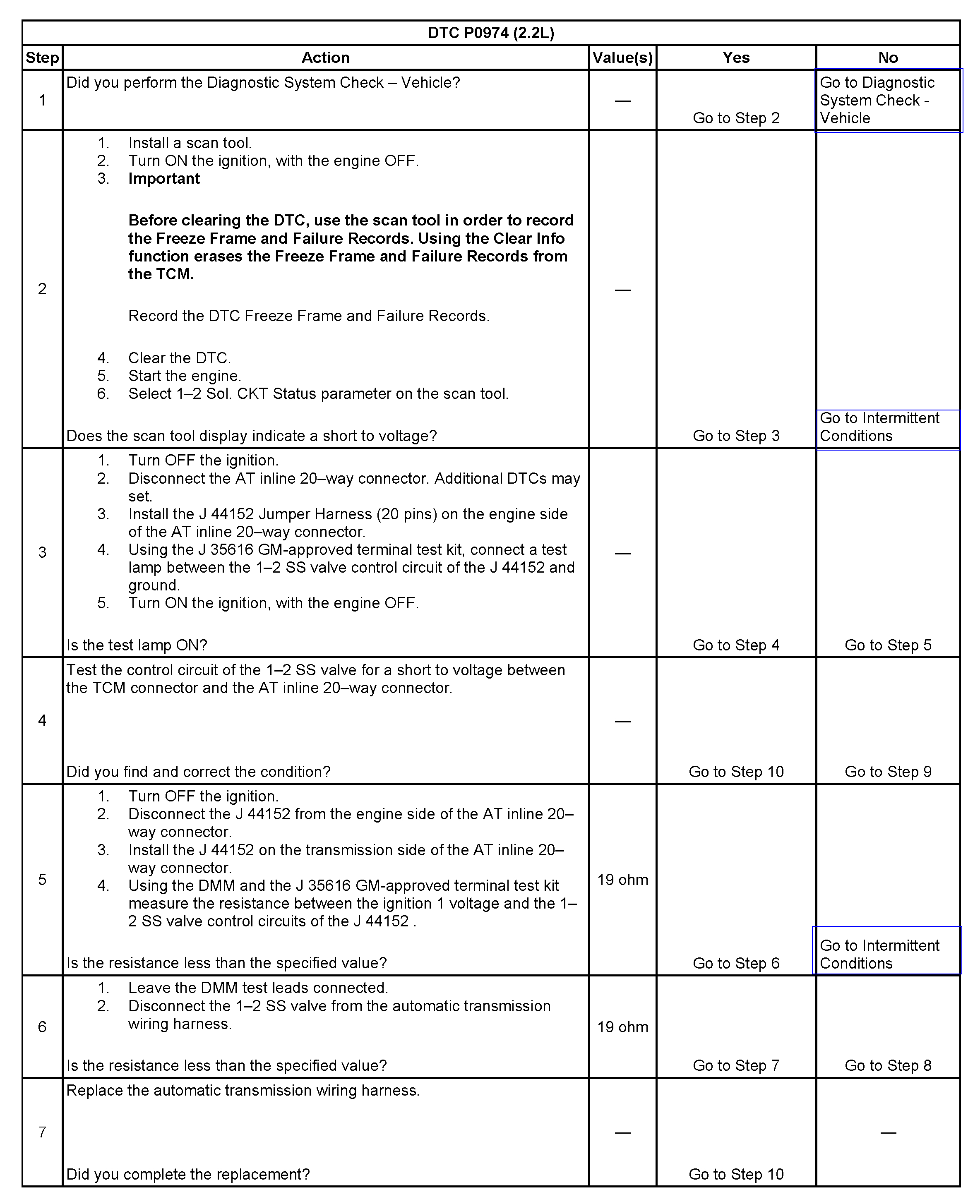

Vehicle ALL Diagnostic Trouble Codes ( DTC ) Testing and Inspection P Code Charts P0974 4T40-E / 4T45-E Automatic Transaxle
4T40-E / 4T45-E AUTOMATIC TRANSAXLE
DTC P0974
Open In New TabZoom/Print

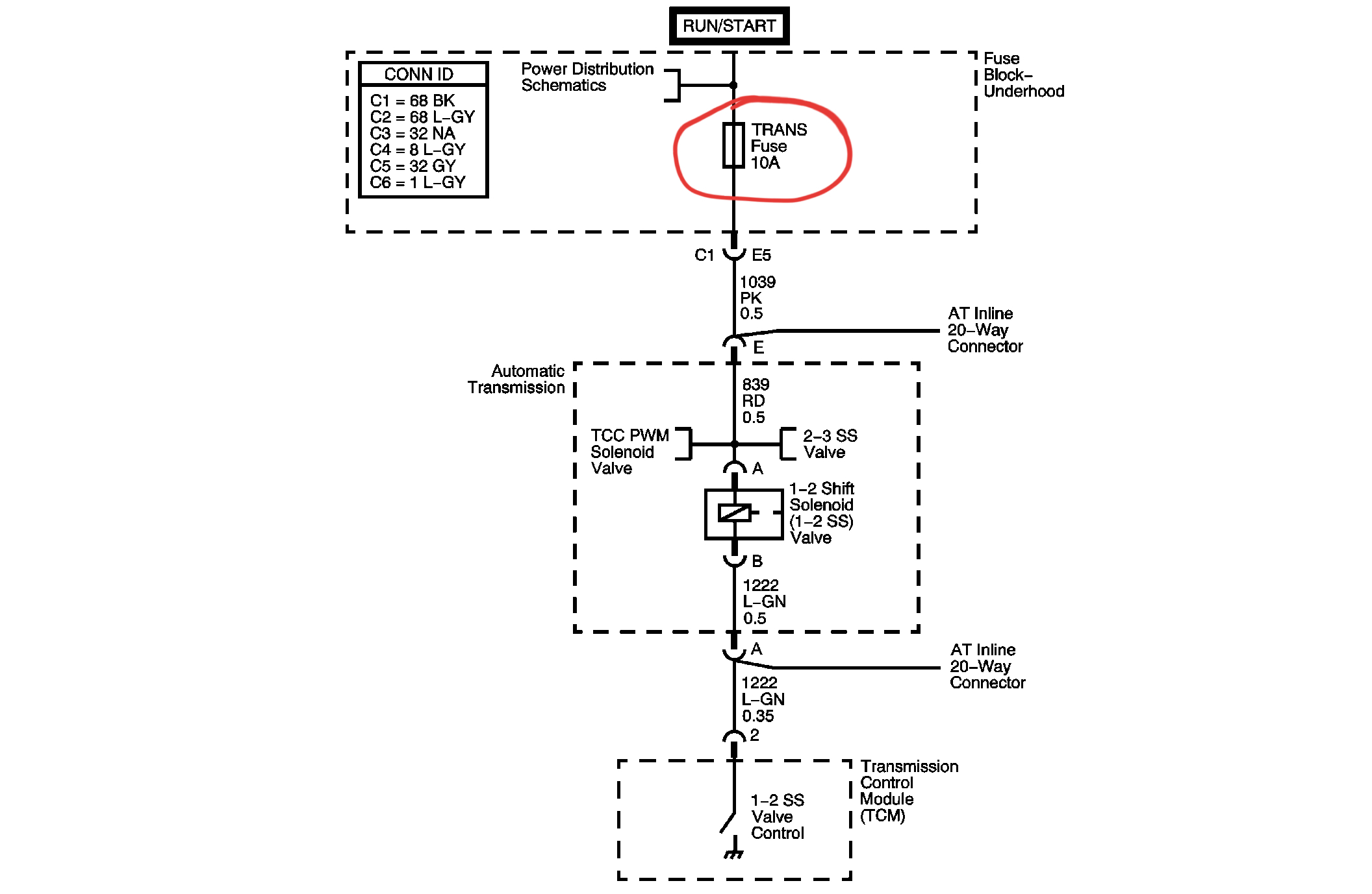

Circuit Description with 4T40-E / 4T45-E Automatic Transaxle
 The 1-2 shift solenoid (SS) valve controls transmission fluid pressure acting on the 1-2 and 3-4 shift valves to position the valves for the appropriate gear. The 1-2 SS valve is a normally open exhaust valve located on the lower control valve body. Ignition voltage is supplied to the solenoid. The transmission control module (TCM) commands the solenoid ON or OFF by providing a ground path. When the 1-2 SS valve is commanded ON, the TCM senses low voltage. When the 1-2 SS valve is commanded OFF, the TCM senses high voltage.
 If the TCM detects a continuous short to voltage in the 1-2 SS valve circuit, then DTC P0974 sets. DTC P0974 is a type B DTC.
DTC Descriptor
 This diagnostic procedure supports the following DTC:
 DTC P0974 1-2 Shift Solenoid (SS) Control Circuit High Voltage
Conditions for Running the DTC
 The ignition is ON.
Conditions for Setting the DTC
 The 1-2 SS valve feedback circuit indicates a continuous short to voltage for 4.4 seconds.
Action Taken When the DTC Sets
 ^  The TCM illuminates the malfunction indicator lamp (MIL) during the second consecutive trip in which the Conditions for Setting the DTC are met.
 ^  The TCM commands maximum line pressure.
 ^  The TCM freezes transmission adaptive functions.
 ^  The TCM records the operating conditions when the Conditions for Setting the DTC are met. The TCM stores this information as Freeze Frame and Failure Records.
 ^  The TCM stores DTC P0974 in TCM history during the second consecutive trip in which the Conditions for Setting the DTC are met.
Conditions for Clearing the MIL/DTC
 ^  The TCM turns OFF the MIL during the third consecutive trip in which the diagnostic test runs and passes.
 ^  A scan tool can clear the MIL/DTC.
 ^  The TCM clears the DTC from TCM history if the vehicle completes 40 warm-up cycles without an emission related diagnostic fault occurring.
 ^  The TCM cancels the DTC default actions when the ignition switch is OFF long enough in order to power down the TCM.
If fault tracing leads to a bad solenoid, with the high mileage I would recommend you swap out the transmission.
