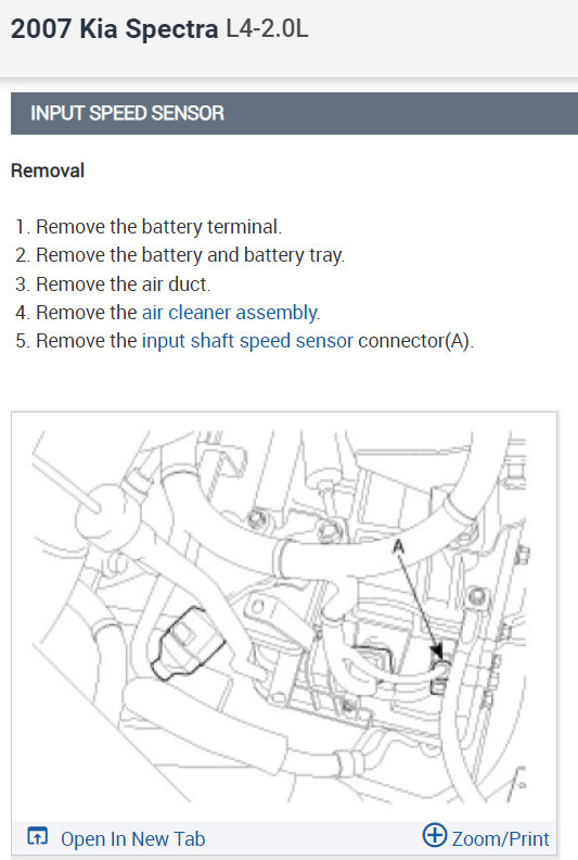

I think the problem is my car is stuck in second gear. It won't gear or down shift.
Apr 10, 2024 at 2:52 PM
Experienced Mechanic
55,721 POSTS

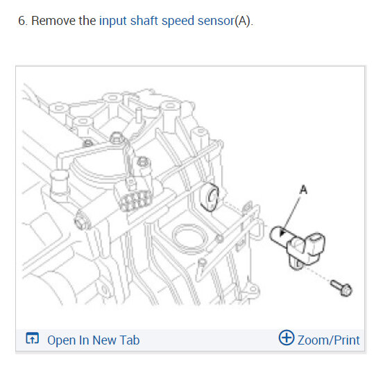

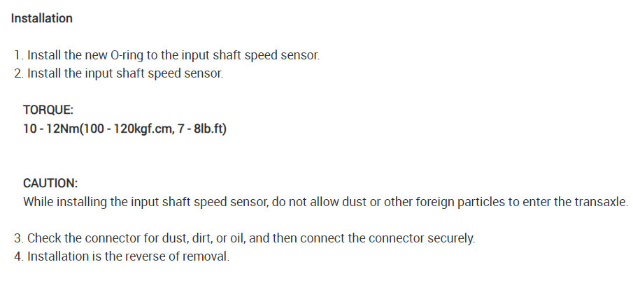

We need to run the codes before we begin to confirm that the input shaft speed sensor has gone out.
Here is a guide to help us:
Here is the location of the sensor so you can check it out. Check out the images (below). Please upload pictures or videos in your response to the problem so we can see what's going on.
