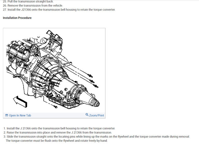

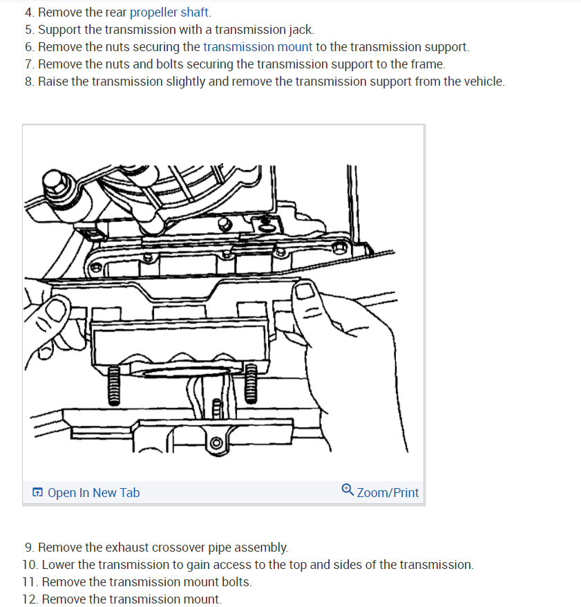

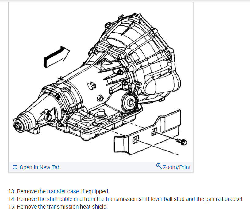

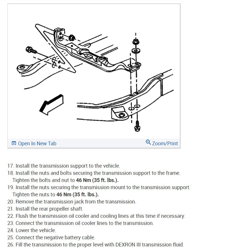

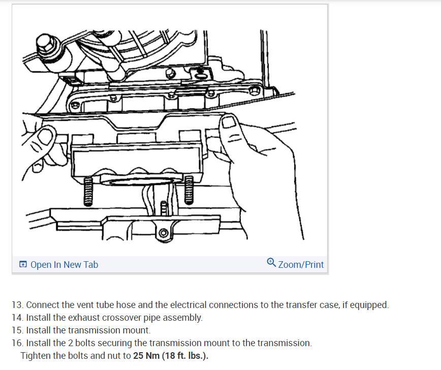

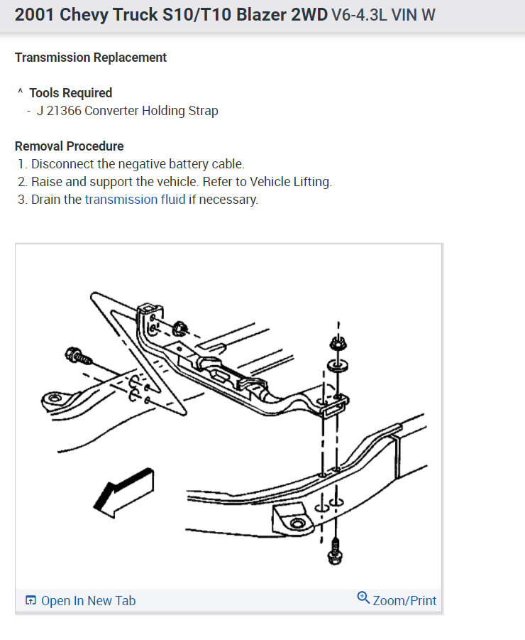

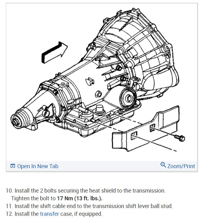

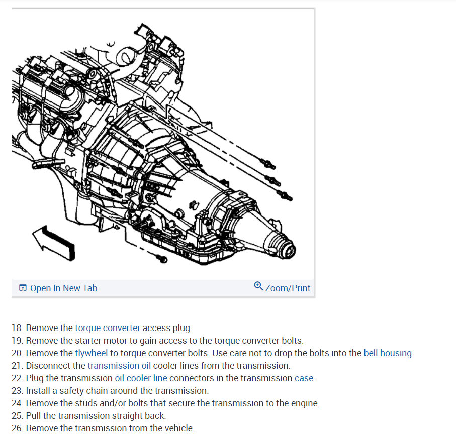

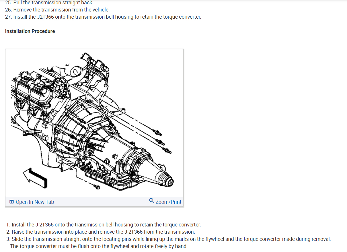

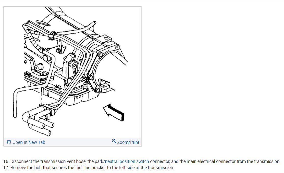

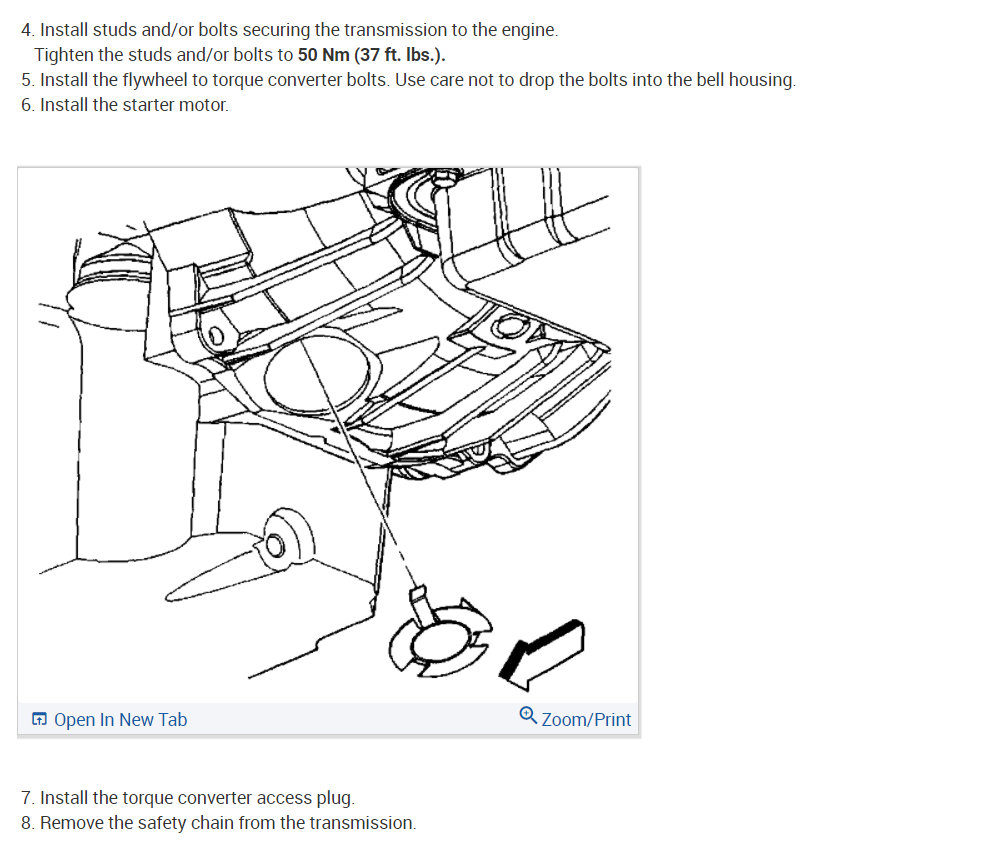

My vehicle needs to have the transmission replaced. do I need to drop my transmission
Oct 17, 2017 at 7:00 AM
STEVE W.
  • 15,410 POSTS
This video shows the job being done on a similar car but the process is the same. step by step with instructions in the diagrams below to show you how on your car.
https://youtu.be/3vJAojsrfuU
