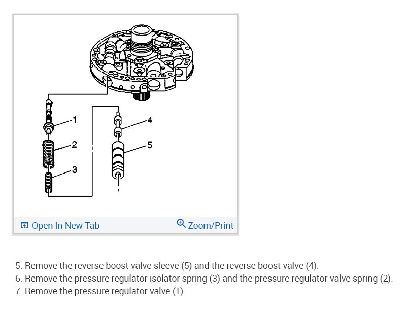

I can drive the truck and it runs fine. After twenty minutes or so when taking off the truck shifts hard into first and second and third. But i can shut the vehicle off for three to five minutes and it will no longer do it. I was told it is the torque converter but i do not feel like it is. I have replaced the filter and fluid with no change.

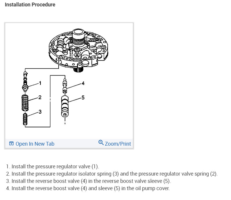

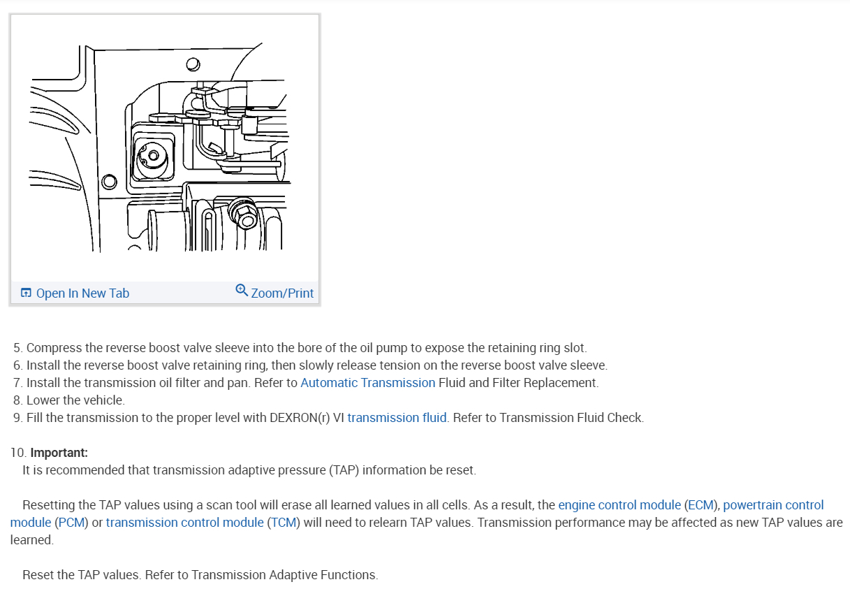

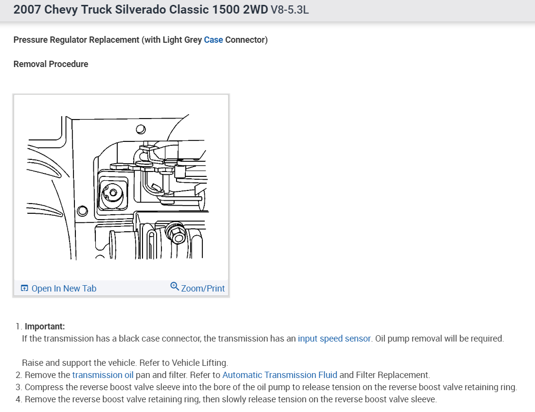

It is not the torque converter, it sounds like you have a pressure control solenoid that has a broken spring. here is the location so you can replace it. If the transmission needs to come out. here is a video to help walk you through the steps with the instructions on how to fix the problem below:
https://youtu.be/3vJAojsrfuU
